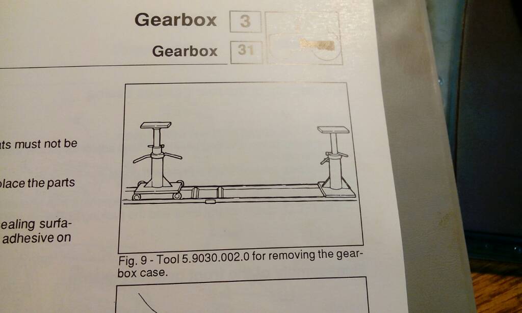

make 1 of these and split in the field
So I guess splitting it is what needs to be done then? Can I split it without removing the fel?
   / MF 205 Industrial leaking ATF at inspection plate
Do you think it would be possible to brace the support arms of the fel with a bar across the front jack stand, and keep it attached to the front end? Then I could just detach it from the were end and slide the rear back without having to undo any hydraulic hoses.
