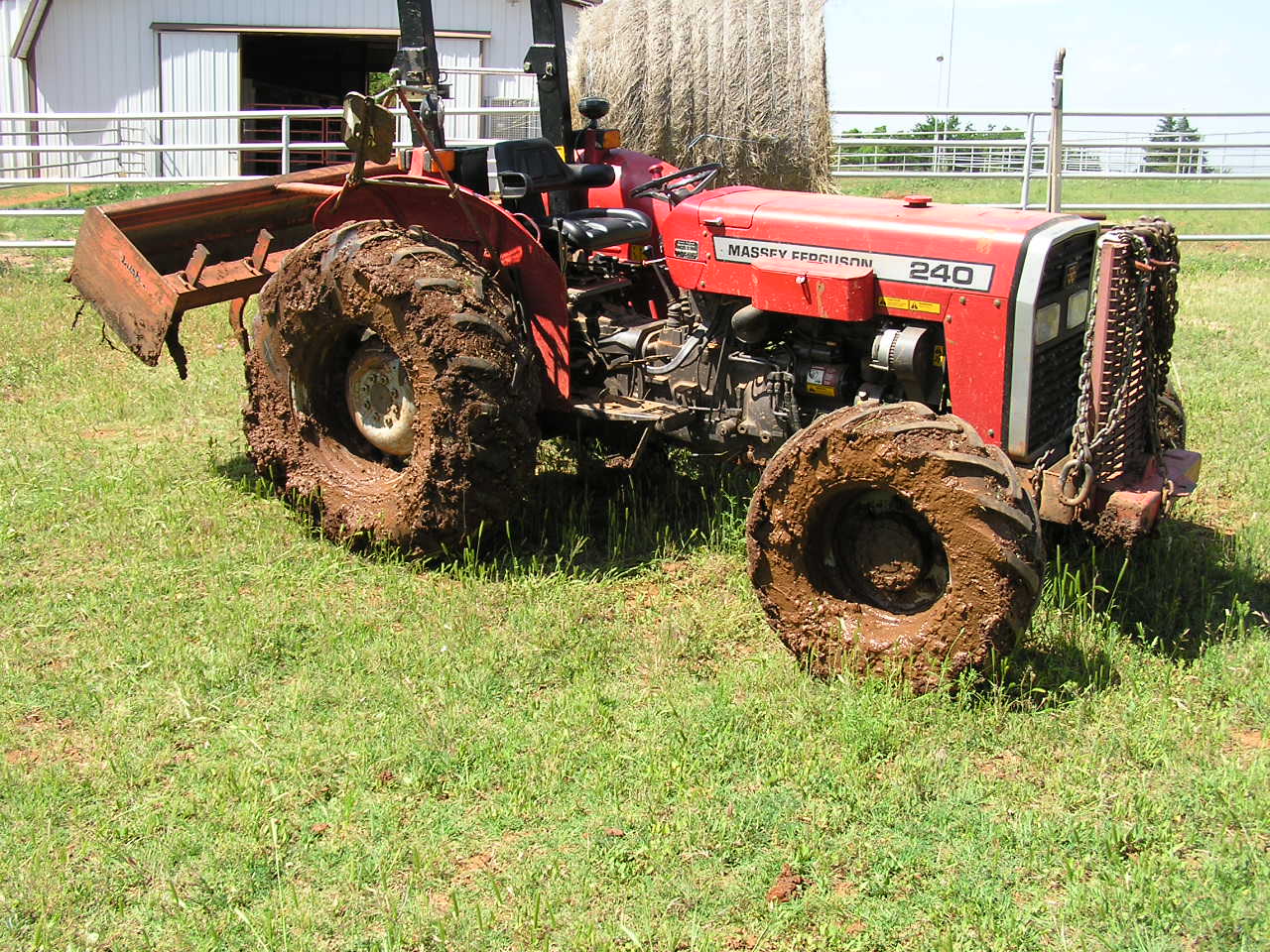

Can you post a picture of the levers? that might jog my memory.
I used 4WD a lot on my 240. :D

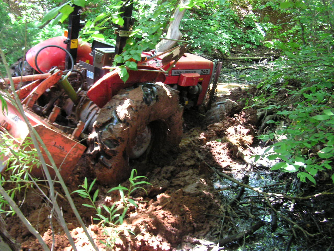

Sometimes I wonder if mine is engaged in 4wd. I know it has 4wd and the lever shows engaged, but it sure doesn't seem to be doing much.
What I do then is put the loader bucket flat on the ground so it will slide, then use the loader to lift the front end just clear of the ground, select a lowish gear, and let out the clutch just enough to see if the front wheels are turning under power.
