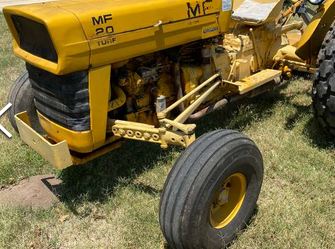

What transmission do you have? There was a 8x2 (4 speed with 2 ranges) or a 6 speed manual reverse (3 speed with 2 ranges and a third lever for reverse).
Also have you investigated the parts manual?
Remember there are 3+ Massey 20's. The Massey Harris 20, The Massey Ferguson 20 turf, and the Massey Ferguson 20 Industrial. The 20 Turf shares some parts with the Industrial but there are still a ton of differences. (I could kill massey for doing an industrial and turf version of their tractors from the 20 to the 20d and not letting folks know the difference.) The industrial will have a straight solid front axle and the turf will have a swept adjustable axle.
Once we definitively determine what you have we can offer better suggestions.
Turf is below
Industrial below.

/ MF 20 Industrial - Items to Replace when Splitting?
#11
Turf is below
View attachment 828484View attachment 828488
Industrial below.
View attachment 828485View attachment 828489

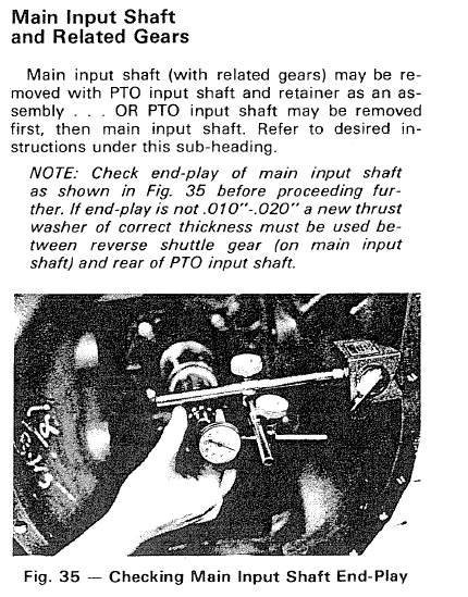

/ MF 20 Industrial - Items to Replace when Splitting? #12
Good news is that you do not need to pull the main input shaft out of the rear. Here are the instructions for the 20C which is newer than yours but most of the
components are the same.

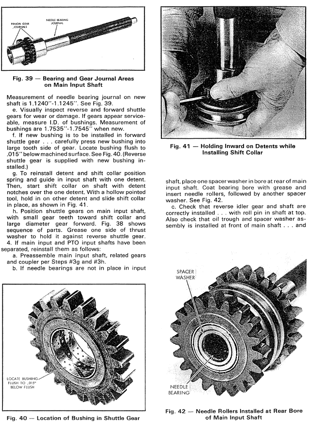

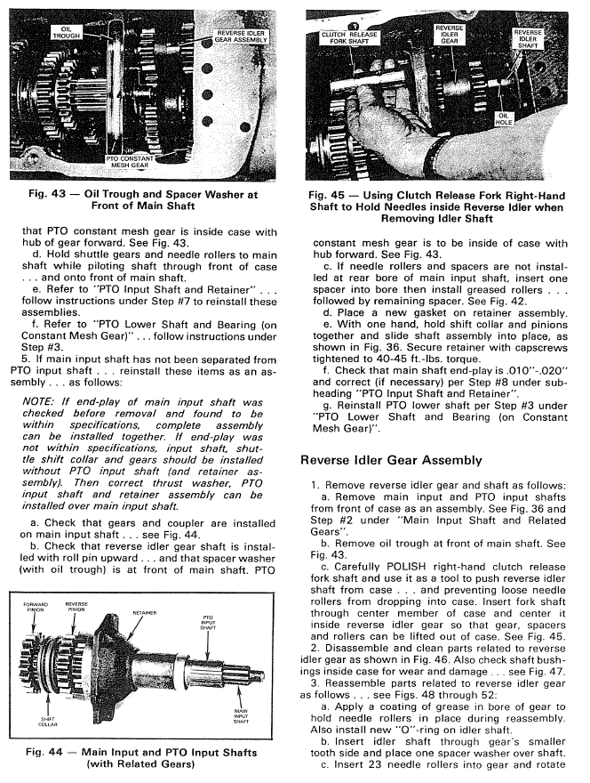

#14
Thank you so much for the detailed posting and part numbers. This is really helpful stuff for me to dig into.
Here comes my confusion. I have the service manual for the 20, and these are the instructions I'm looking at that made me think I had to do a double split... Sorry they break across two pages like that, but was the easiest way for me to post them.
I know those are written like a full teardown, but it looks to me like the PTO front shaft has to go out the back to allow the gear that is meshed with the input shaft in the housing to drop down. If I didn't have to split again, that would be huge.....
