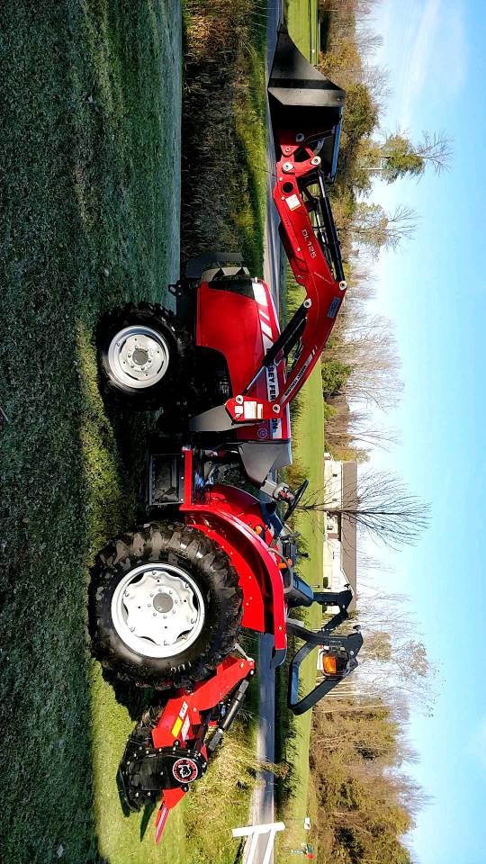

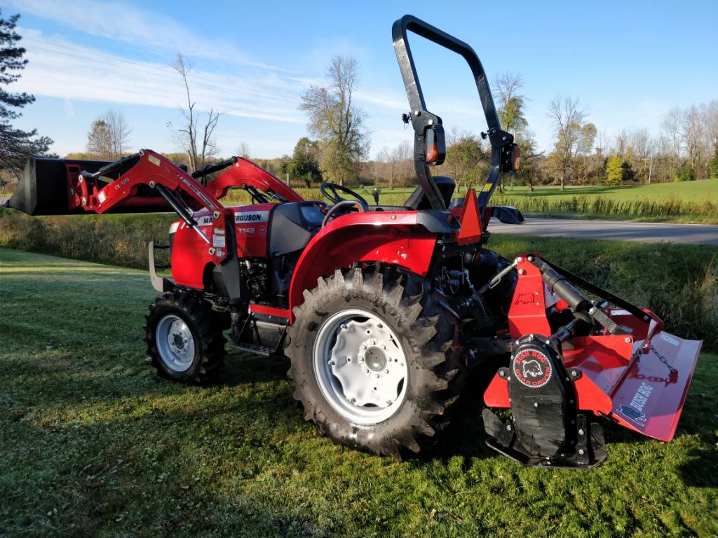

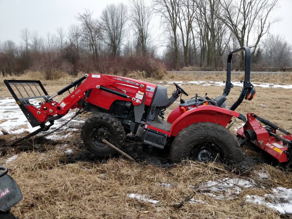

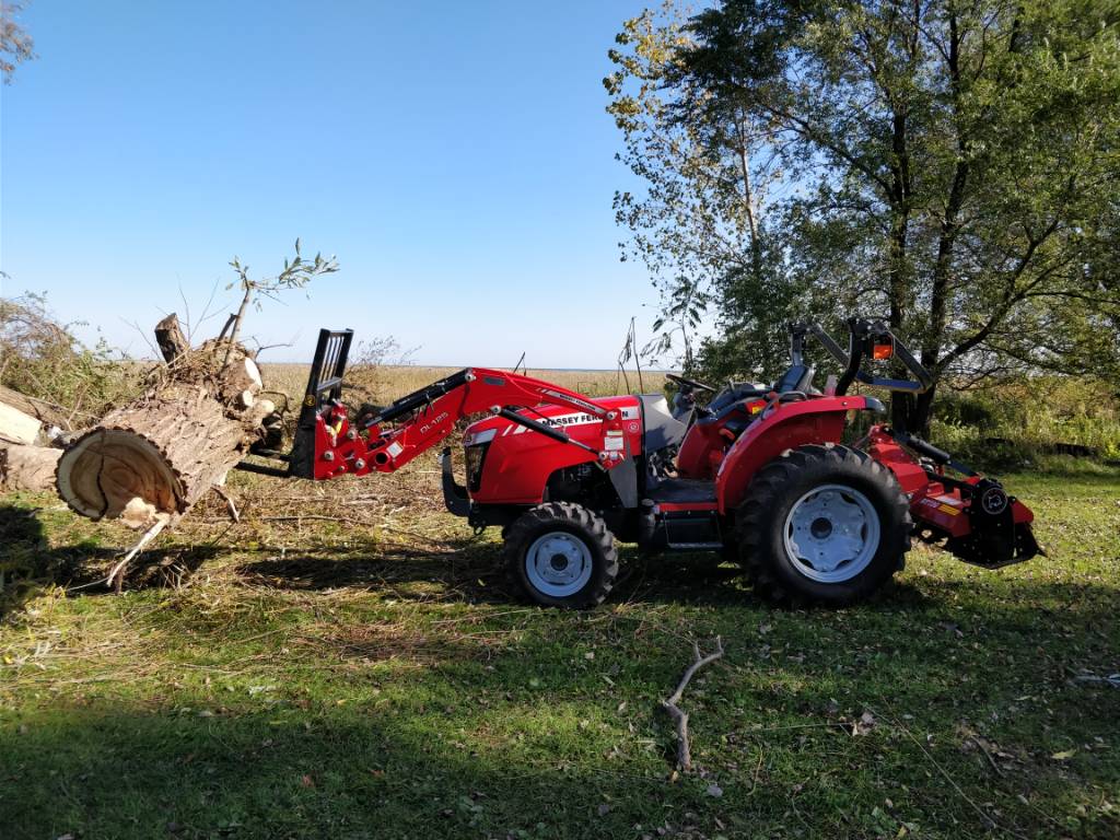

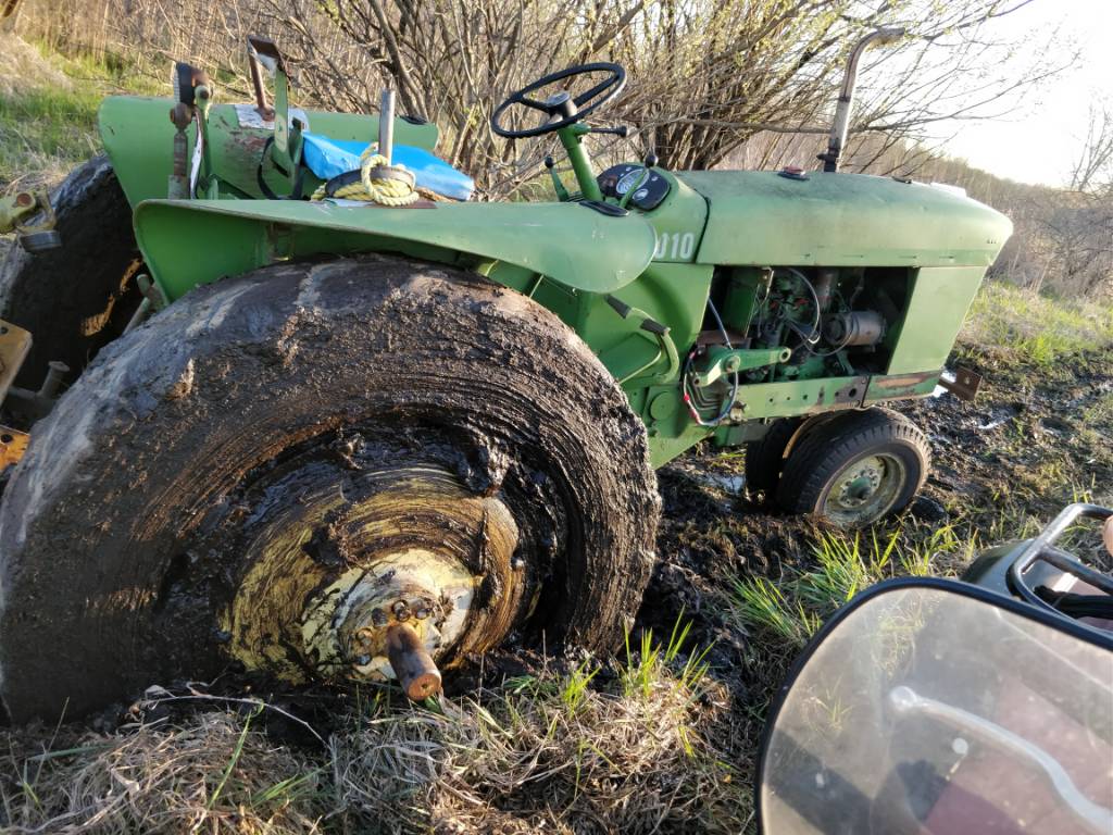

Hey everyone, coming up on 44 hours on this beast...only complaint I have about it is it's fel lifting capacity, I feel like I should be able to move a pallet of wood pellets, yet needed to take a good ten 20lb bags off, probably a few more... And still wasn't able to lift out of a truck bed, was able to slide it off and safely lower and move it to it's destination. Guessing roughly #1700-1800. Other than that it has plenty of power so far, could use some more weight too, spins tires quite easy, even with ballasted tires...think I'm half way or just past that to a first Regen, and to be honest I let her idle a lot, I know they say not to but I do and havent noticed any difference, got a old Deere 2010 with 50 hp and my Massey puts it to shame using the same rotary cutter, night and day difference, so much smoother, didn't get to use it much this winter, not enough snow, now if the water ever stops falling out of the sky long enough to where I won't get suck....again...would be great...what's everyone else's opions? IMG_20181022_144312.jpegSnapchat-1695662347.jpegIMG_20181212_151944.jpegIMG_20181022_094047.jpegIMG_20180507_195931.jpeg

Have 172 hrs on my 1742 cab tractor. Yup, they get stuck when you fall off the road snowblowing. Only glitch is the batt cca is too low for our climate, installed a battery blanket to keep it cozy. Same price as a 30 series JD. Loving it.

PS. I did have to plug in a 3000# gauge into one of the hydraulics couplers for the FEL and tweak the pressure up about 150 PSI to get it set at specs. Lifts better now, but dont over do it and break something on the loader. The PRV is under the seat, on the top, right side of the transmission. If i remember correctly, the slotted head of the screw faces the radiator, and it took a 7/8” wrench or socket to loosen the locknut. Dont go more than a quarter of a turn before deadheading the gauge to see max pressure.
