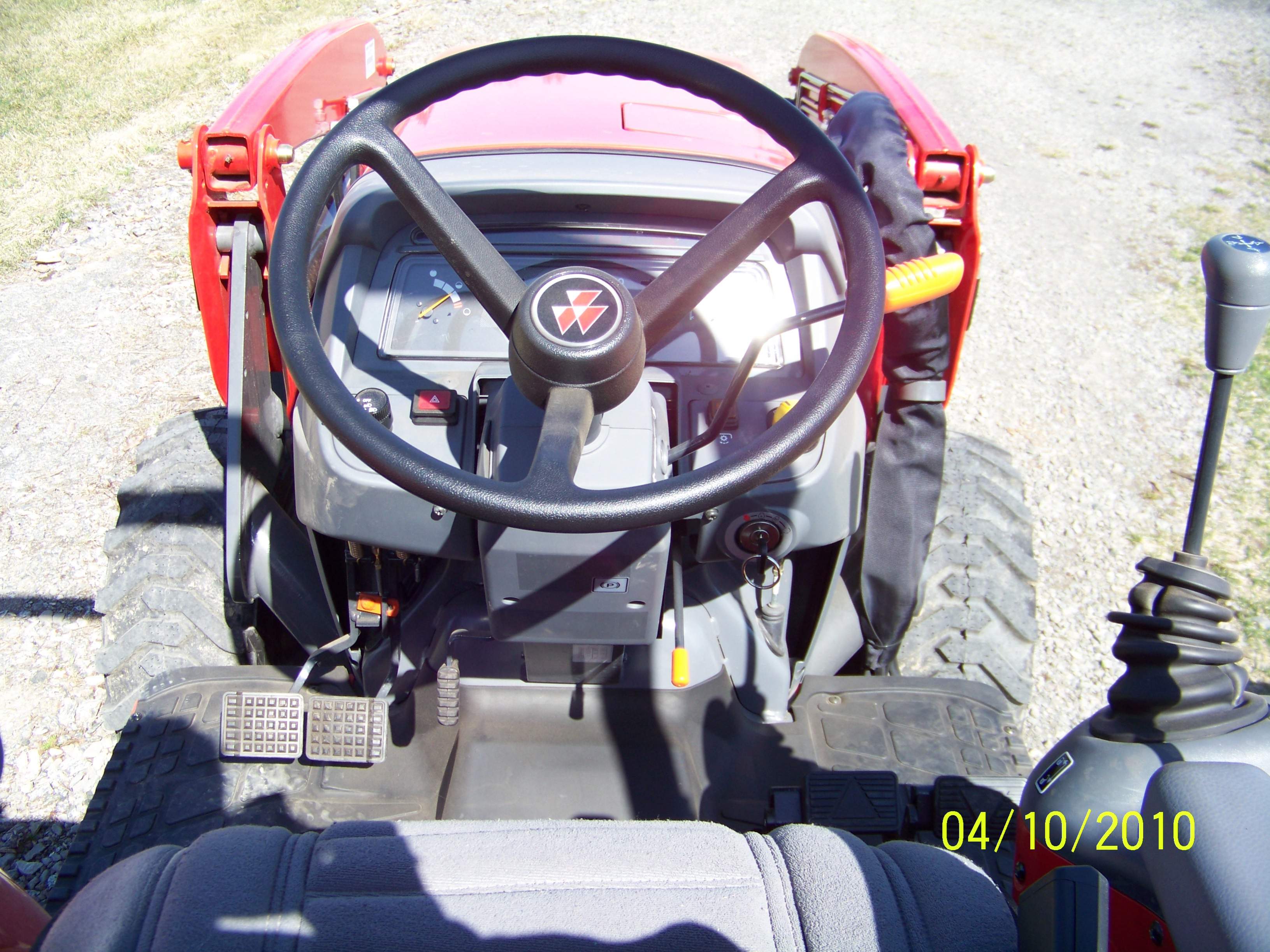

Hi ! I have a 1643 Hst and the Massey Hst pedal is also connected to the trottle device, the more you push your Hst pedal ( forward and another to reverse) it will increase the engine rpm like a car. Also you wrote a single brake pedal, the pedal is a split pedal brake left or right and like the other tractor you can lock them ( 2 brake pedals ). I personnaly love Hst. As you wrotte there is a trottle lever on the column to set your rpm for pto or other equipment requirement. I put a photo of mine you will see how it is . Good luck Roger.

Thanks for the replys guys.
Roger your picture really clears up the brake. Looking at the pictures on their web site it looks like one pedal.
