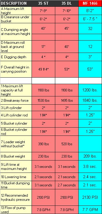

The MF 1466 is stronger that your number show. Here is a chart where I combined Hardy and MF numbers. I got the MF numbers from my loader manual.

</font><font color="blue" class="small">( As for that Hardy loader, the specs are better than the MF 1466. It looks like 1400lbs vs. 1200 on the MF )</font>
I was curious where you got your numbers. According to the Hardy website, the Model 35DL has a 1100 lb lift capacity. They don't mention if this is at the pivot pin or 24" beyond. I would assume they use the better of the two, which is at the pivot pin. The MF 1466 lists a lift capacity of 1200 lbs at pivot pin and 1050 lbs at 24" beyond.

All 1400 Series loaders are rated at @ 19.5" from pivot. Hardy's site doesn't show where theirs are rated at.

I saw the same info. The dealer claims Hardy has redesigned the 35 this year to increase lift to 1400lbs. I have a letter out to Hardy to confirm this and will post the new specs. The propaganda from Hardy reflects the old specs. I would obviously go with the 1466 if the specs are better! I'll let you know what they say...
