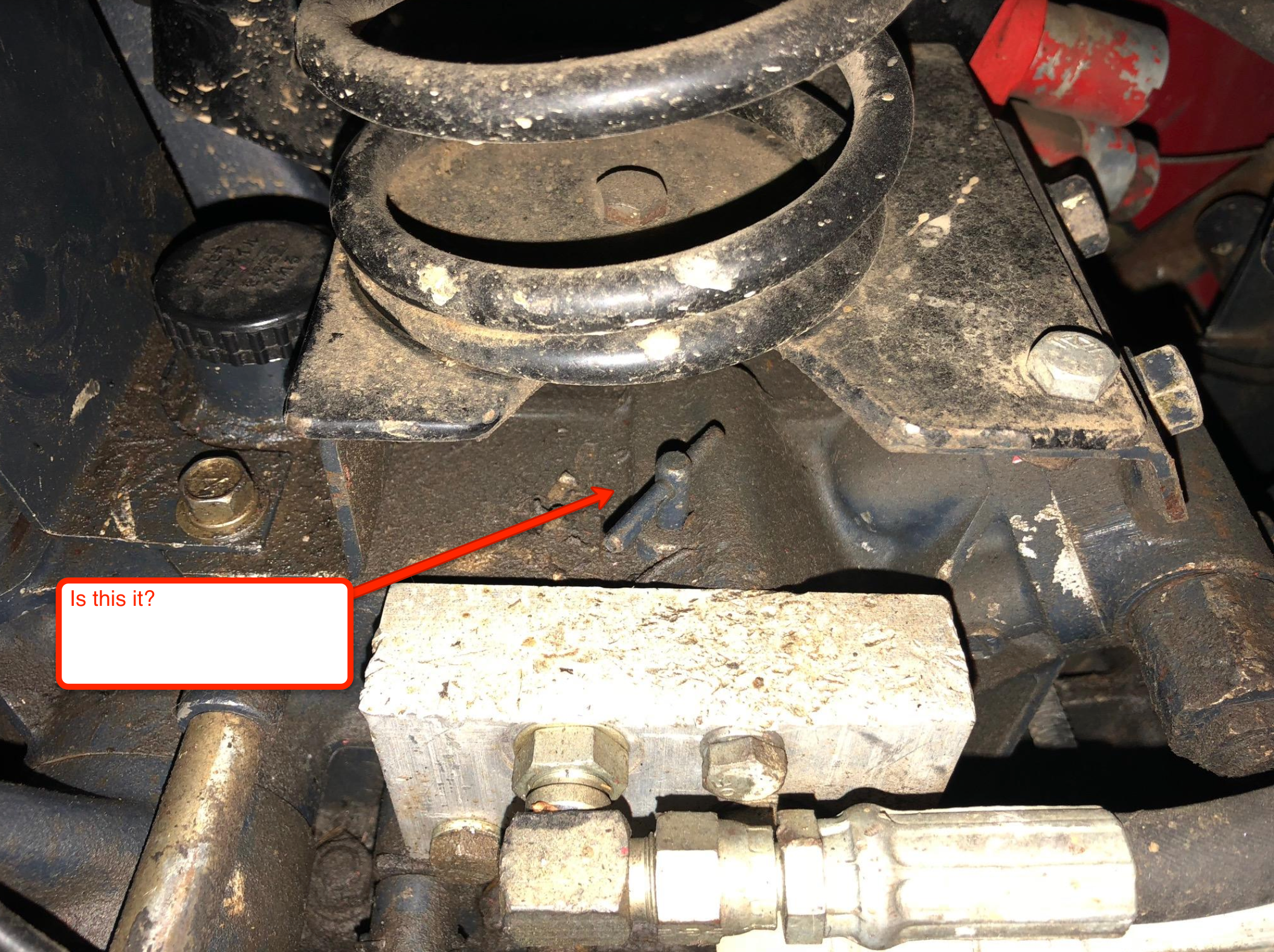

I looked under the right side of my seat like mguitas suggested and I found something but it doesn't look like a dipstick to me but maybe it is. I can't pull it up or turn it by hand but I can turn it with a wrench.
I didn't turn it too far because it starts to get tight no matter if I turn it to the left or right and I didn't want to break anything.
Here is a pic of what I found. Anyone know if this is it?

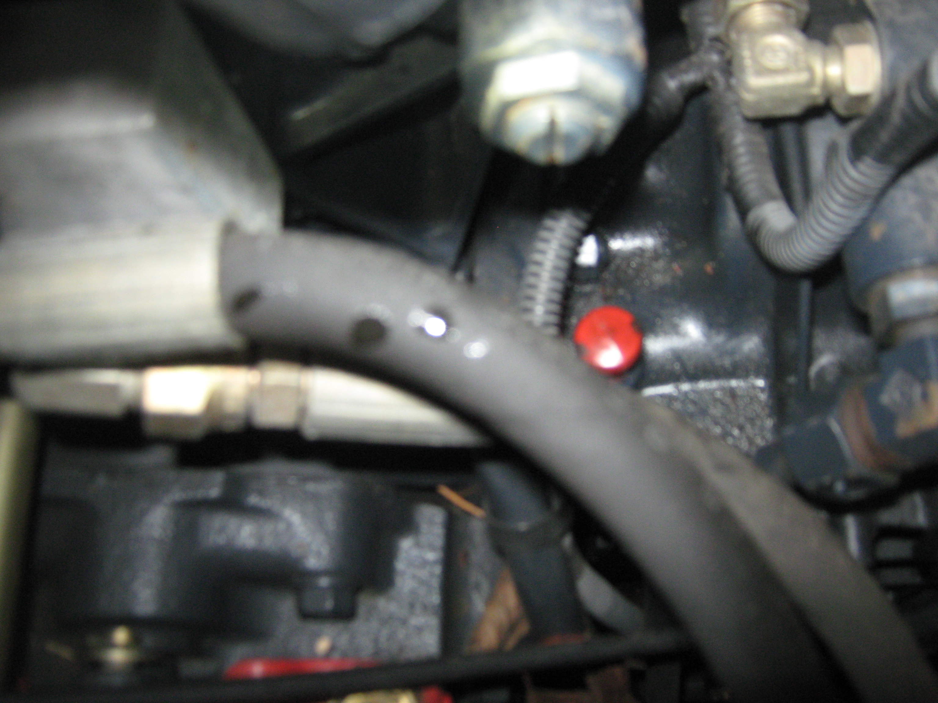

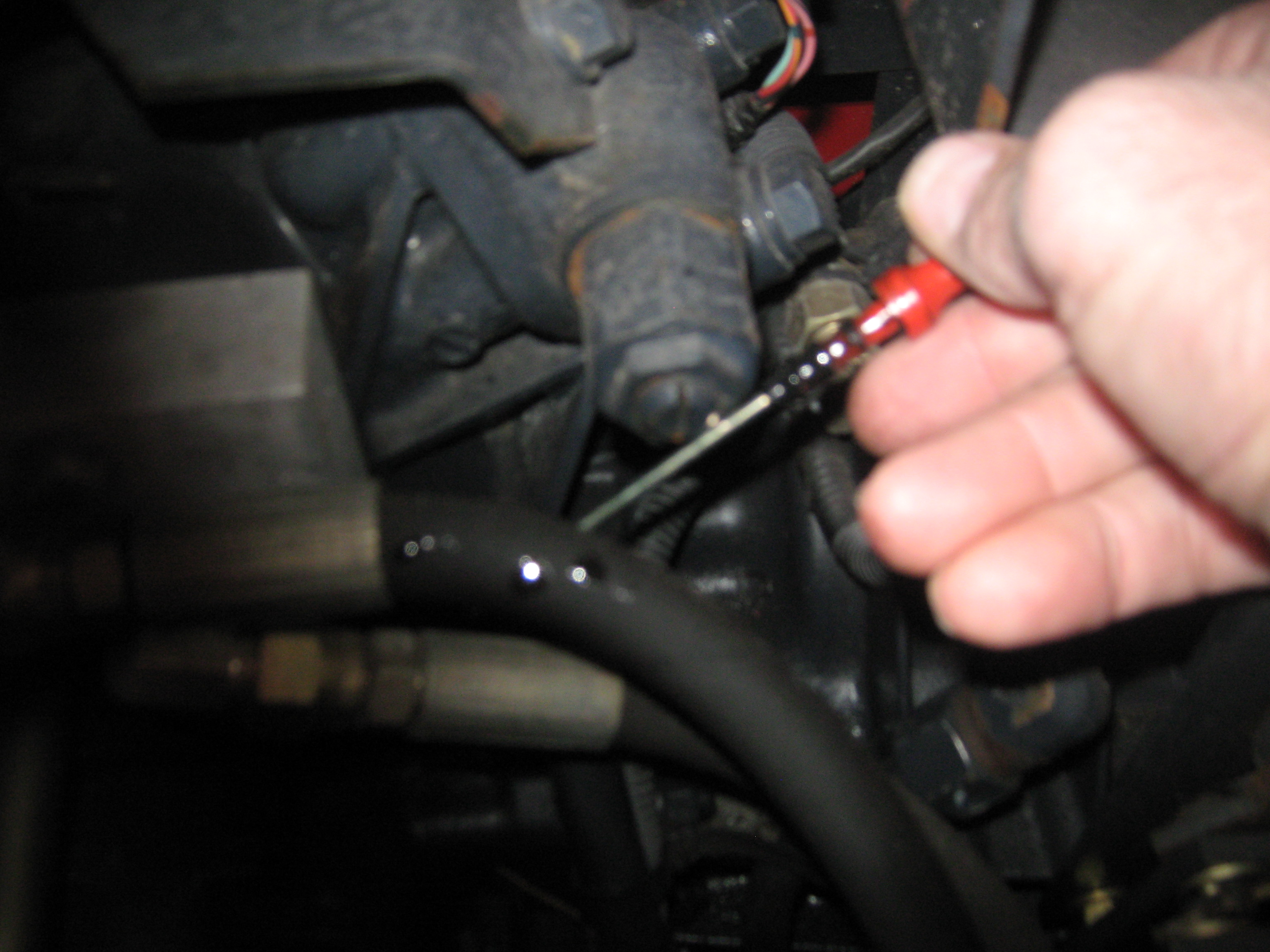

I found it!!!!
Thanks to everyone that helped. Especially mguitas for the pictures.
My dipstick is black instead of red and it was hiding under some wires.
