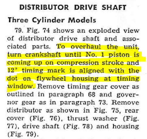

I have a good lead on the distributor shaft, so I am starting to think about getting this thing put back together.
I am reading through the shop manual you all provided. mf135_mf150_mf165_shop_service : Free Download, Borrow, and Streaming : Internet Archive
On page 16 of the online reader or Page 30 of the scanned manual there is a whole section on the "Distributor Drive Shaft". I am trying to figure out how to align it correctly. Remember, I am just a do-it-yourselfer, so I get the concepts but have very little practical knowledge on a lot of this stuff.
The instructions keep talking about aligning things to the 12 degree timing mark and No. 1 Piston is coming up on compression stroke. How do I do this part???
Here is an excerpt from the manual I am referring to.
Thanks!
Stuart
Thanks!
Stuart
I think I have figured it out.
I can move the flywheel with a screw driver and old it in place. I can turn the pully at the front of the engine to move the pistons and using a gauge or contraption in this video I can determine if I am coming up on the compression stroke to find TDC (Top Dead Center). Learning all sorts of new stuff.
Stuart

The dot on the flywheel will be the hard part. Make sure if you see it that you take a felt pen and mark it good. It doesn't hurt to mark it on the front of the engine somewhere also. That way you have a rough idea where it is.
The compression stroke on #1 is easy. Just hold your finger tightly over #1 spark plug hole and when compression starts to push it off you are on the compression stroke. Keep turning in the direction of normal engine rotation till you see the dot in the window and you should be where you are supposed to be.
