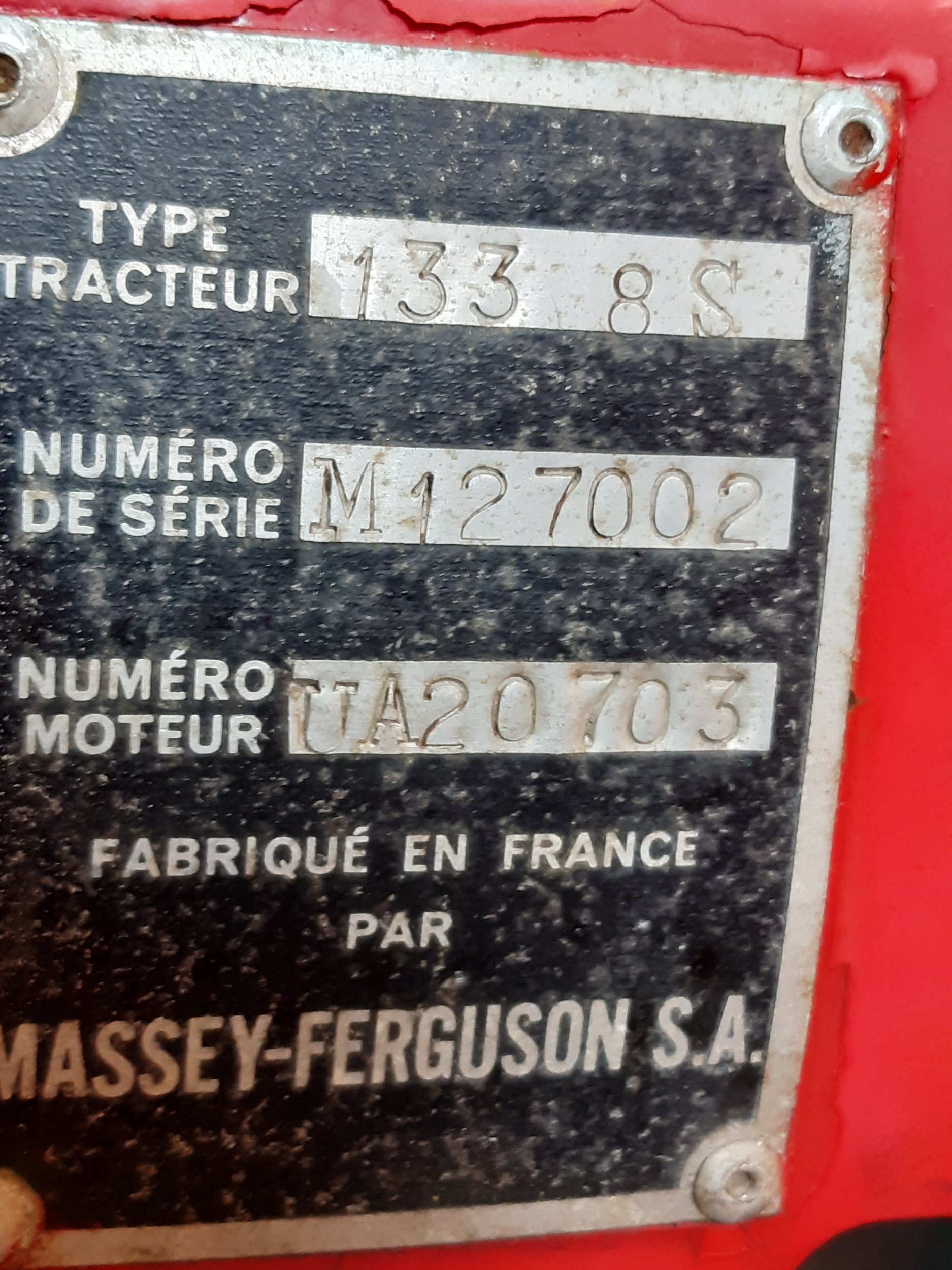

MF133
Hi all. I have purchased a MF 133 french model with dry sealed disk brakes. I am having difficulty identifying the parts for the axles etc. Would anybody have a parts book
or be able to help me with this.. Thanks
   / MF 133 #2
Do you have a picture of the rear end? The normal agricultural 133 should have very much in common with the 135 but has a slightly smaller displacement 144 vs 152.on the 135.

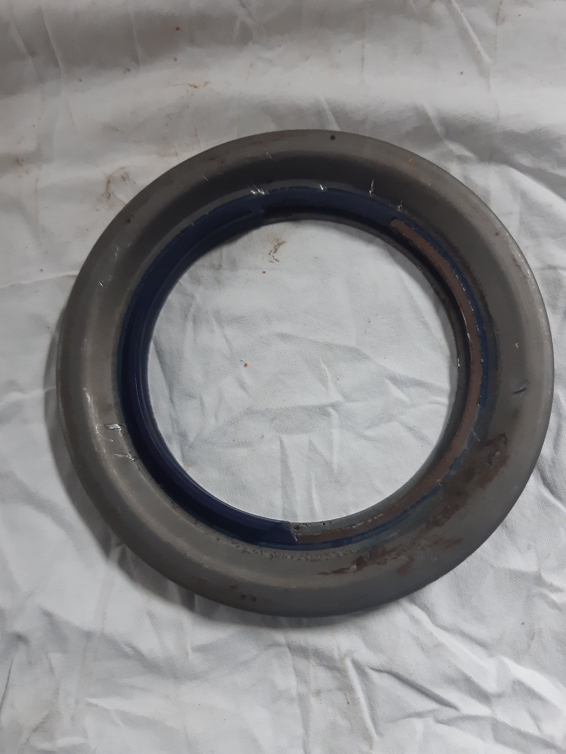

   / MF 133
No OEM Part numbers . Outer hub seal is 897198
Bearing is 395A & 394 A whish i have found on internet
Inner dust seal as pictured has no numbers and is 121 mm OD
