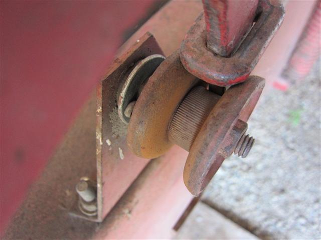

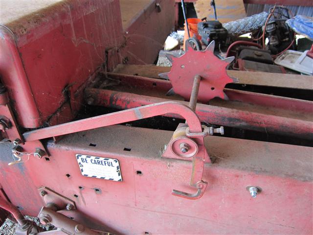

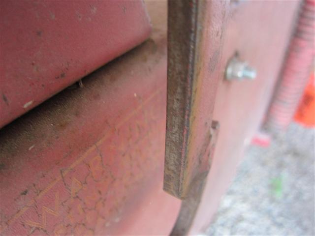

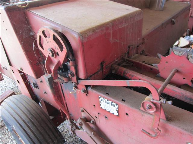

Don't know if this will help, but here's a few shots of the metering arm on my MF124 baler.
IMG_0382 (Small).JPGIMG_0383 (Small).JPGIMG_0384 (Small).JPGIMG_0385 (Small).JPG
The knurling on the drive wheel looks pretty good, but there's quite a bit of wear on the metering arm knurling. I haven't used this baler much at all so I don't know if I'm heading for the type of problem you're experiencing. I just make the adjustments per the manual and go from there.
