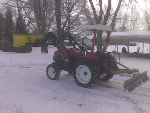

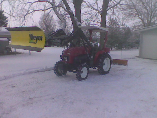

I finally finished the project and plowed snow with it. All is OK but it still needs some improvements. Since I've not yet mastered posting pictures, Chris will help me out. Many thanks to 3RRL for his help with the hydraulics that consist on both rear and front remotes. I made a small improvement for the stacking valve bracket to incorporate a roof over it with a drip edge. You'll see this in the picture post.
/ Meyer plow on Jinma 284? #14
Here is pics of Steve's setup. He did a very nice job on both the plow and hydro's setup.
Chris
/ Meyer plow on Jinma 284? #19
Dave
You are the one who inspired me to do my plow so I need to thank you. It came out great. Used it a few times in the last week.
Chris
Kind words Chris. I think when we all have ideas and someone else can use all or parts to make it work for them, makes it more special. Its always great to salvage something from nothing and make it work. Maybe next year I will find the time to refinish like yours and then it will seem complete. Functionally it seems to do the job.
