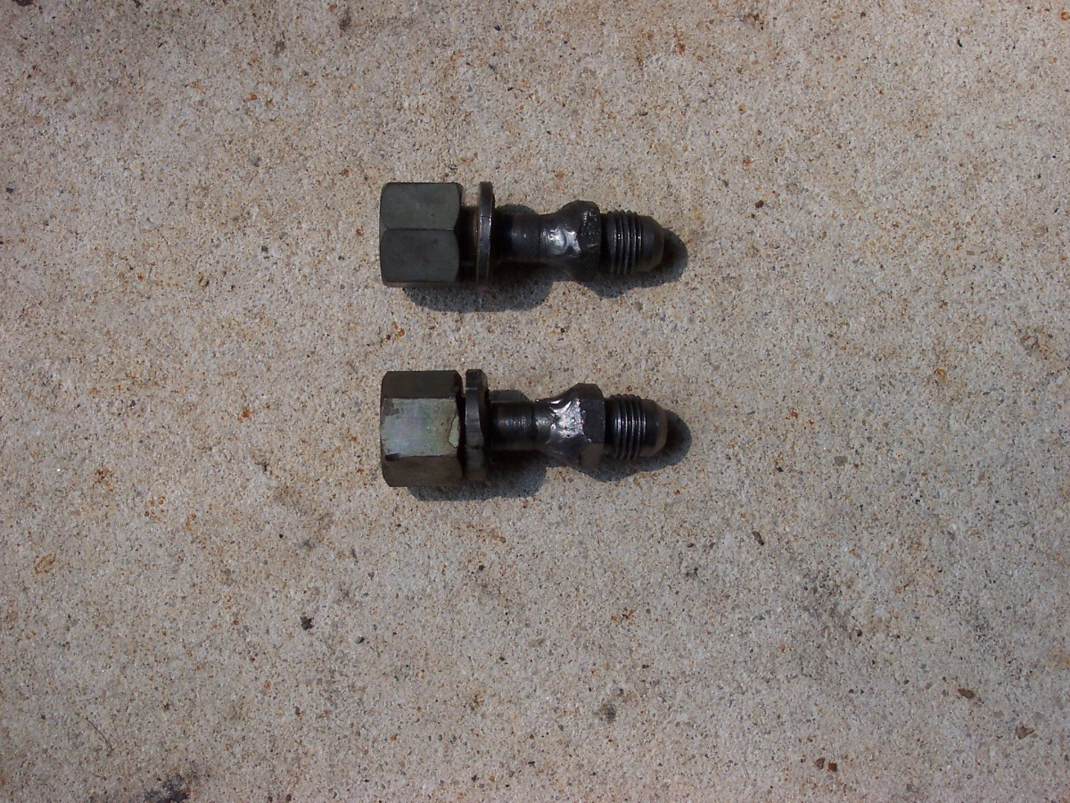

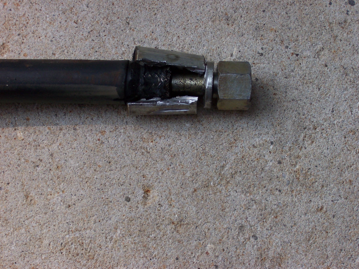

Here are pics of my Jinma hose solution. The factory hoses blew apart and when I cut them open they weren't installed all the way. I took the Jinma end and welded an american fitting (#8 JIC if I remember correctly) then use SAE hose with ends.
Also I needed to add quick disconnect to my supply hose. I welded a pipe nipple to a plate and made a flange out of the plate and bolted the fittings together.

Bring the banjo bolt with you. Banjo crimps are a rare dog, however, banjo bolts are either BSPP or Metric. You can get an adapter to go in the port that the banjo bolt was in that goes to JIC which is available anywhere. I've done this many times. Metric x JIC elbows are common.
