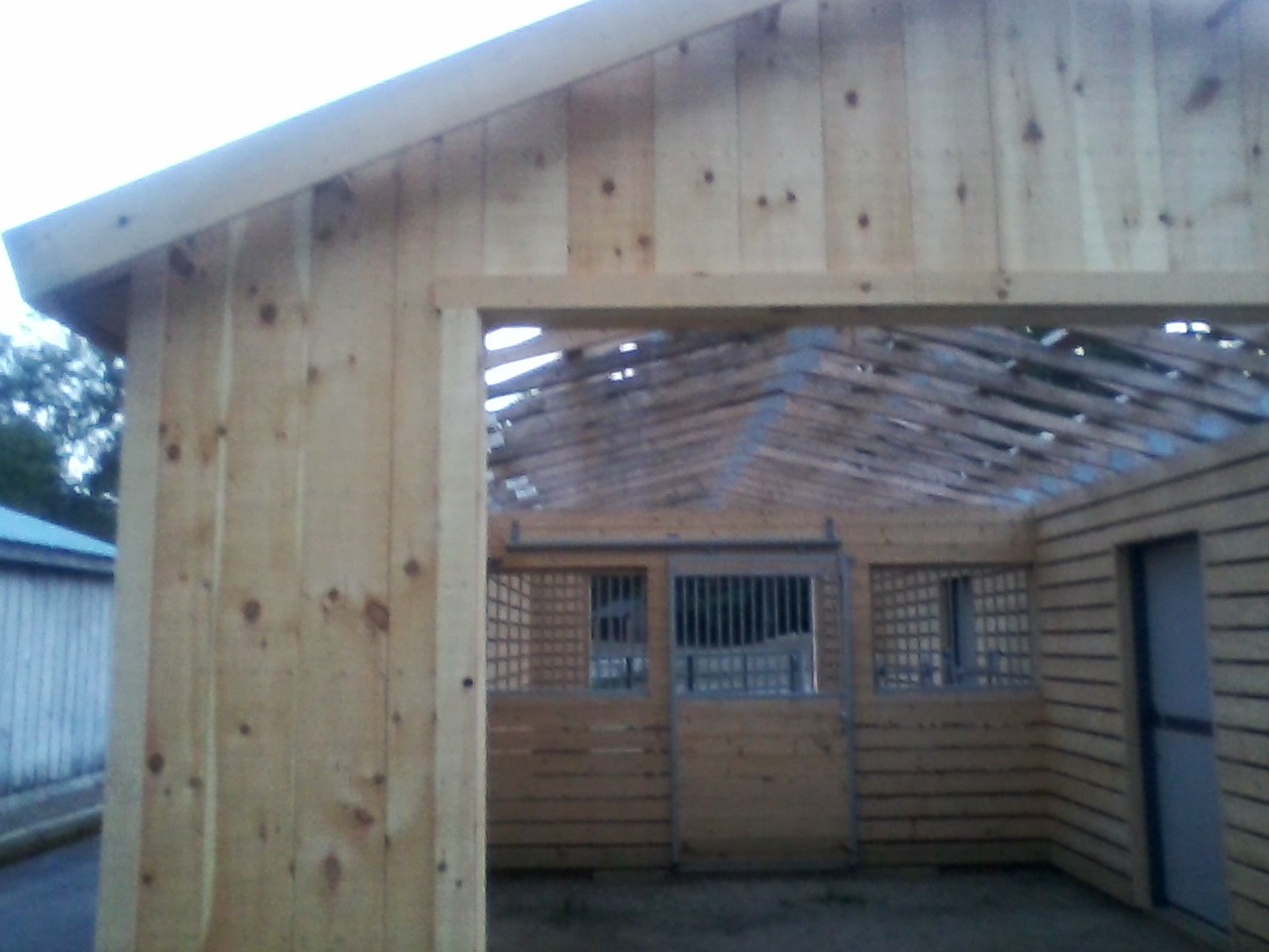

/ Metal trusses for pole barn #8
You can get wood scissor trusses I built a small barn with them 0925151834-00.jpg
