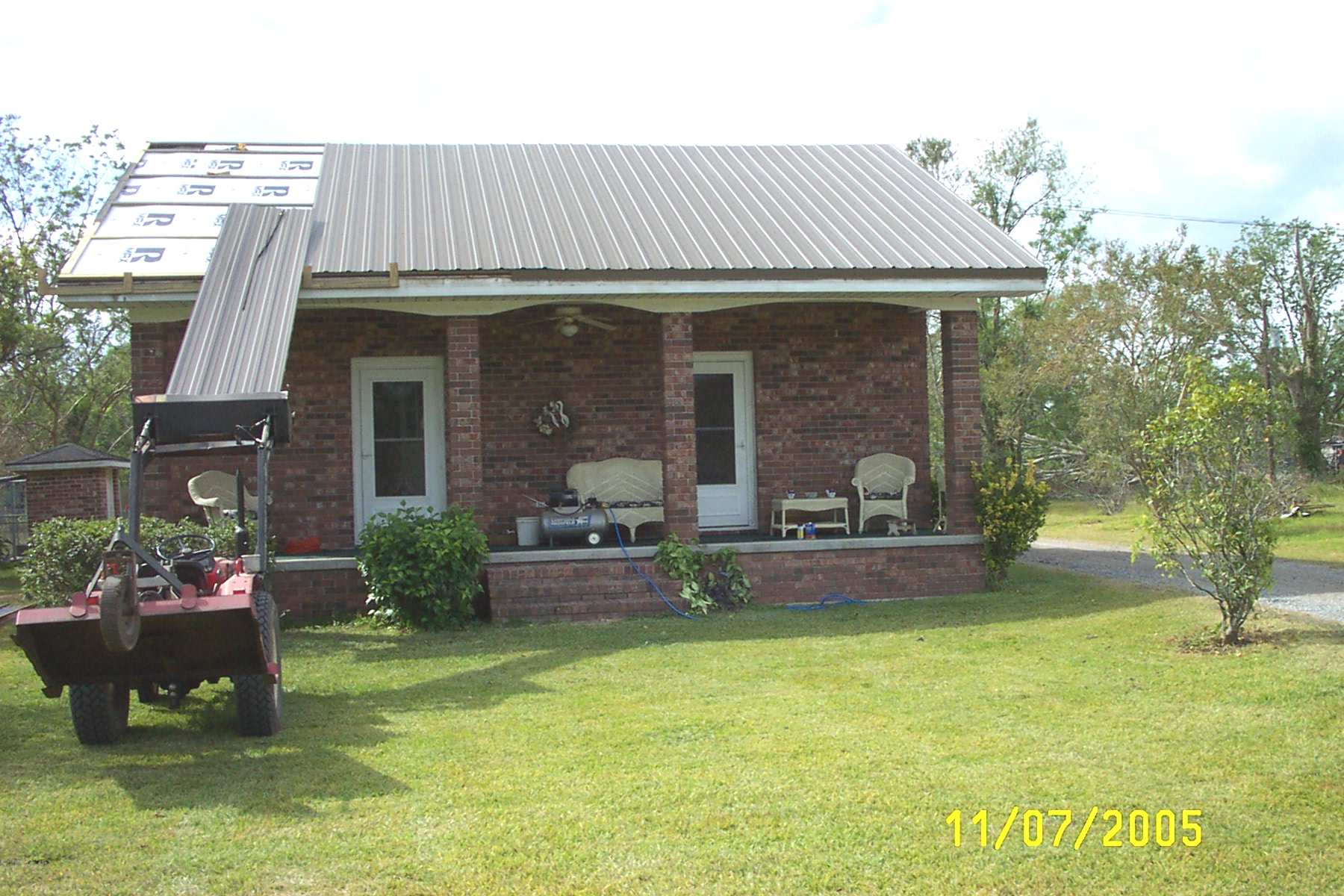

Home Depot metal? I don't know if your Home Depot has better metal but the ones here sell metal so thin you can practically tear it like aluminum foil. Our code requires 26 gauge metal on the roof and I would not consider any less for a home. Lighter gauges will bend as you walk on them and the screws will tear right through as the panels blow off in a storm.
This is my recommendation: It worked great for me. Leave the old shingles on for insulation and sound deadening. Use 2X4s for furring strips instead of 1X4s for 2 reasons. 1. The 1 1/2" screws will hold much better than the 1" screws usually used on 1X4s and the 2X4s are much stronger in a storm. The 2X4s will allow lots of cool air flow for better insulation under the metal when applied as I did.
Buy the 4X8 X3/4" foam insulating panels and attach them to the roof between the furring strips. This leaves 3/4" for air flow. Then attach the metal to the 2X4s. See photo.
After Katrina this is how I did my roof and my attic is 20 degrees cooler in the summer than it was before. The roof is very quiet in a rainstorm. You can not hear rain falling on the metal. I'm sure your Florida weather is similar to our Louisiana weather and the extra insulation pays future dividends. I did this roof completely by myself and pocketed 2/3 of the money the insurance company gave me for the repairs.
