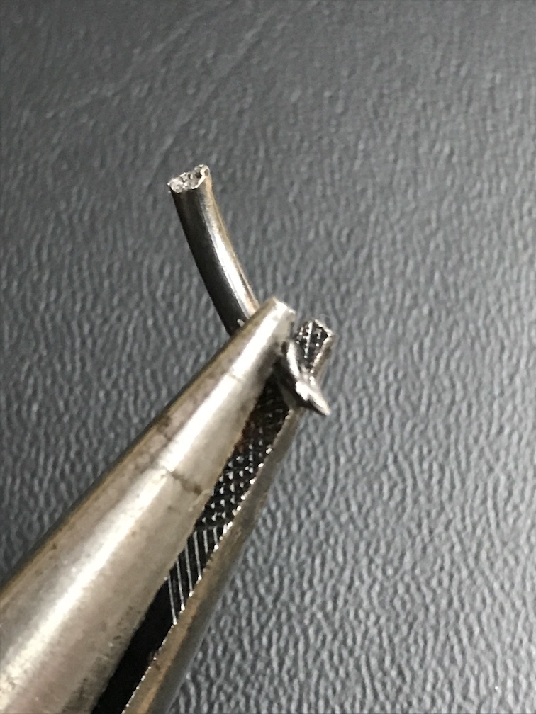

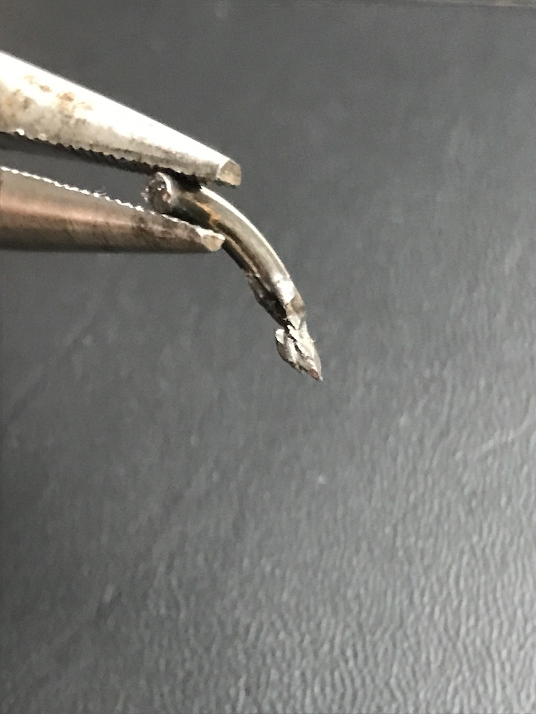

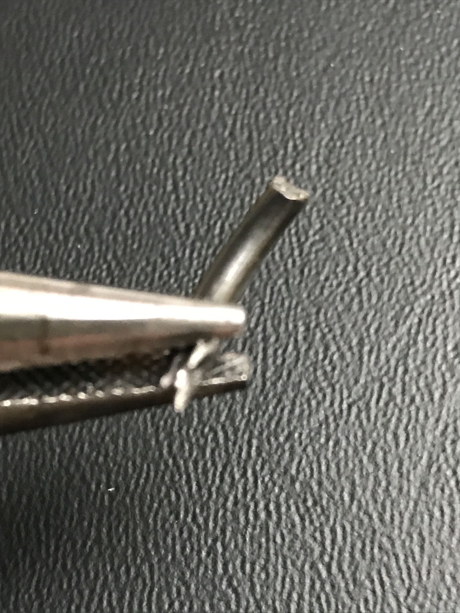

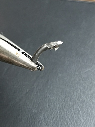

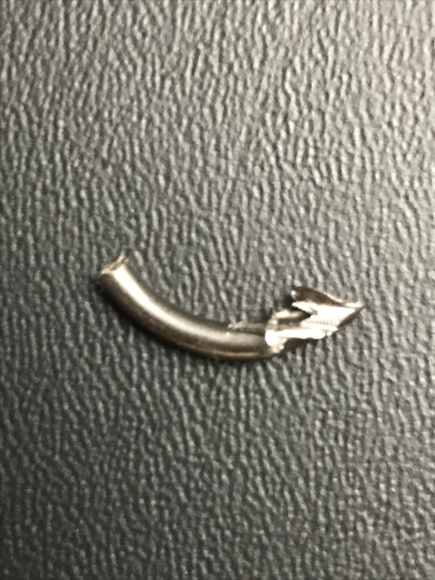

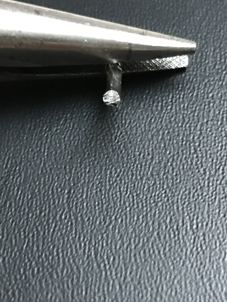

I have a 1988 John Deere 750. I was changing the hydraulic fluid today. As I was dumping out the old hydraulic fluid into a waste oil can I notice in the drain pain a piece of metal. I have attached some pics for you to view. It looks to me like maybe some type of snap ring. Yet I truly do not know. I have never opened up a transmission case before so I am not sure what I am looking at. Not even sure I would dare try and open up the transmission. You could also see small filings in the old oil in the drain pan. Not a lot but there was some. The tractor has been running fine. I simply started a fall maintenance on my tractor in preparation for this winter. Thats when I usually do an annual maintenance.
The only unusual situations I have experienced with this tractor is on two occasions the shifting lever felt mildly stiff. There was a slight resistance in moving the shifting lever from extreme left to extreme right. Like when you just wiggle the shifting lever left to right, and back right to left rapidly. It freed up almost as soon as I experienced it. Those two incidents happened several months, maybe even a year apart. The second unusual situation is the tractor shifts with some difficulty into reverse. It does not happen all the time but it does with some regularity. You really need to positively shift it into reverse otherwise it may not have gone in to reverse all the way.
I have looked on John Deere's website at the parts diagram to try and find what might be the part. There are plenty of snap rings but in the parts diagrams they appear to be flat not rounded like the piece I found.
So, I just don't know. My next step is to yank off the shifting lever cover to see what I can see there. Any advice though will be greatly appreciated. Thanks in advance!

If everything still works fine leave it alone. May be from a past repair.

I'm with ROUSTABOUT... But I would worry more if there were a large amount of metal filing is bottom of drain pan or oil has metallic sheen to it....

I have to commend you on the great photos. So many times, someone will make this type of post with grainy blurry photos and we have no clue. These are great, probably better than I could see in person with my middle-aged eyesight.
I think you were smart to look over the parts diagram for a round wire type of ring, etc. That should admit or exclude most of the possibilities, if not all.
Is the material soft, malleable, bendable? If so, I'd lean to it being some scrap inadvertently left over from manufacturing or something that found its way in by accident. To me, if it's an actual important part related to the transmission, it would be a hardened or treated part with springiness and/or brittleness.
Small fine filings are normal in my opinion. Normally when something breaks or wears, you get slivers and chunks.
Also check any cannister filters that may have been replaced. Filters may contain a check valve inside the middle with a spring. They would have a round wire coil material in the spring. Usually you can see this from the opening in the center of the filter, but it's not hard to break the can open and look at the inside of the filter directly.

It is hard to tell without handling the part but it looks to me like part of a coil spring. It could be a retainer of some sort too. If it is too hard for a file to cut it, or if a sharp file barely cuts it, then I would look for something with a coil spring, maybe from a filter. If the filter has a bypass valve that could be a piece of the spring used in the valve. It could also, like you suggested, be a piece of a retainer. Once again it might have come from inside of a filter. I would take apart any filter to see if it is missing any parts.

I think it is retaining ring in place of a snap ring. Works and put together like the end on a starter drive.
