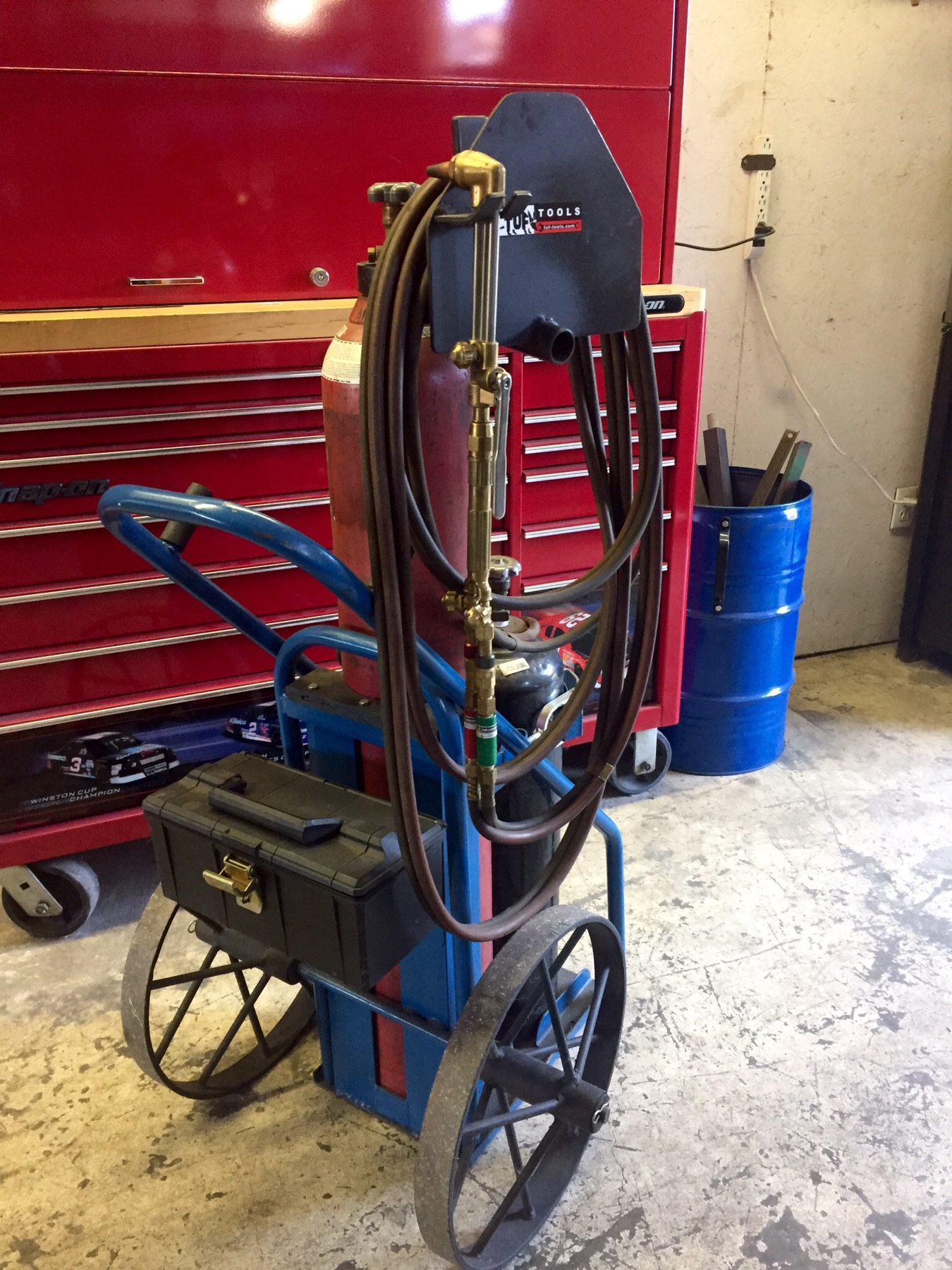

And if you just spend some time getting to know how to use it, your oxy-acet cutting torch will do a great job of cutting everything from sheet metal up to half inch plate and leaves a smooth bright shiny edge you can weld too without anything more than knocking some slag off.
rScotty

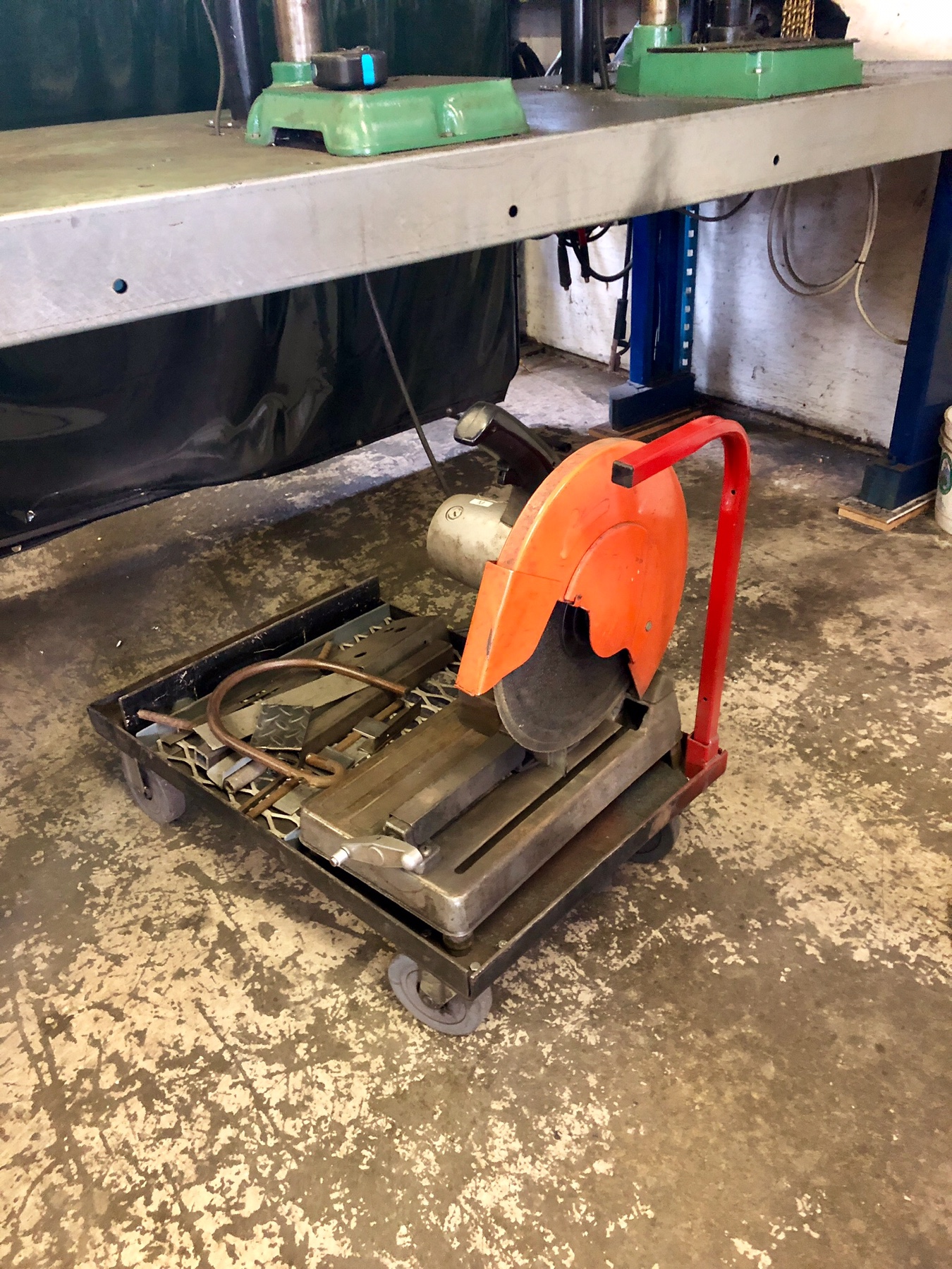

Up until I bought this Makita abrasive chop saw in 1983 O/A was the only way I had to cut metal on the farm. At the time it was like I had died and gone to heaven.
Still have and use both.

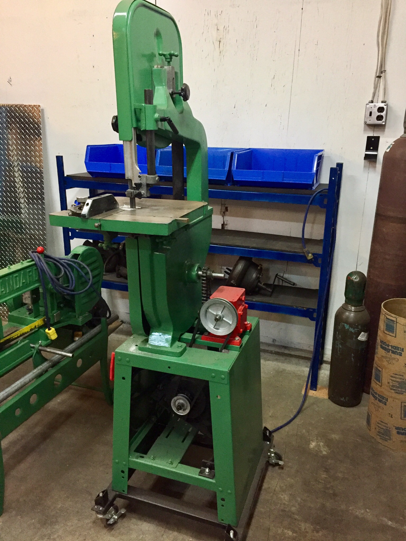

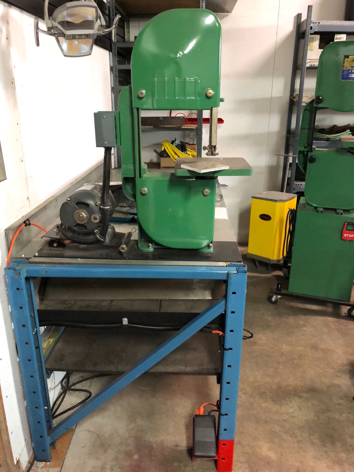

The blade speed on your 14” bandsaw will be way too fast for cutting metal. Aluminum will be ok.
You would need to reduce the speed in addition to using a bi metal
blade. My Taiwan unit is prob the same as yours. I added a reduction gear to reduce the blade speed for cutting steel.
This bench model equipped with a narrow blade at regular wood cutting speed is used for aluminum.

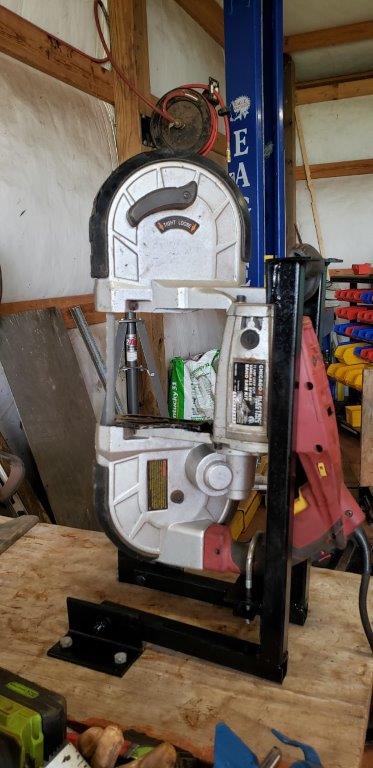

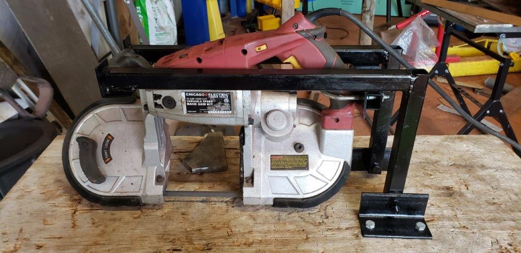

I am in the same boat as you and have been doing more welding projects. Cutting thicker and thicker steel.
The porta band saw is my go-to first until recently. I build a simple stand for it and I highly recommend welding one up.
Buy a HF foot switch for it. Then zip tie the power switch.

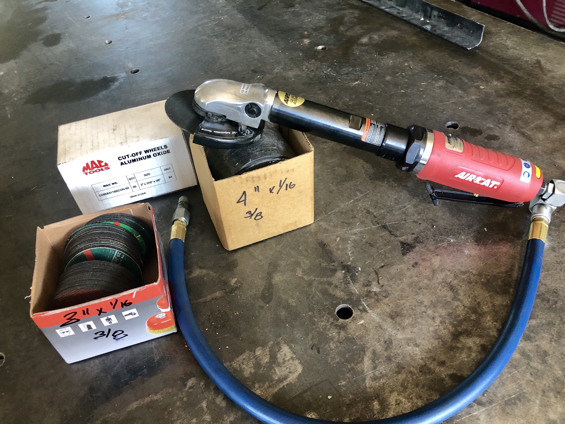

metalbender I think you値l be quite pleased with the Lennox.
I really should order a 4 one for my extended reach cut off tool but I still have three boxes of 3 and 4 inch abrasive discs.
To the OP. Another great tool is the extended reach cutoff tool. I wouldn稚 put it on your priority list as what others have mentioned well do you well. But it is an awesome tool.
I'm going to try the Lenox disc. $11.99 on Amazon Prime.
