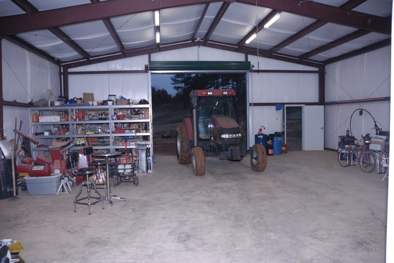

In the main barn, I installed three two bulb 8' florescent fixtures.
Two more on the side wing where will clean deer, and another in a walled locked up area.
So far this is enough light, but we can easily add two more fixtures in the main area when needed.

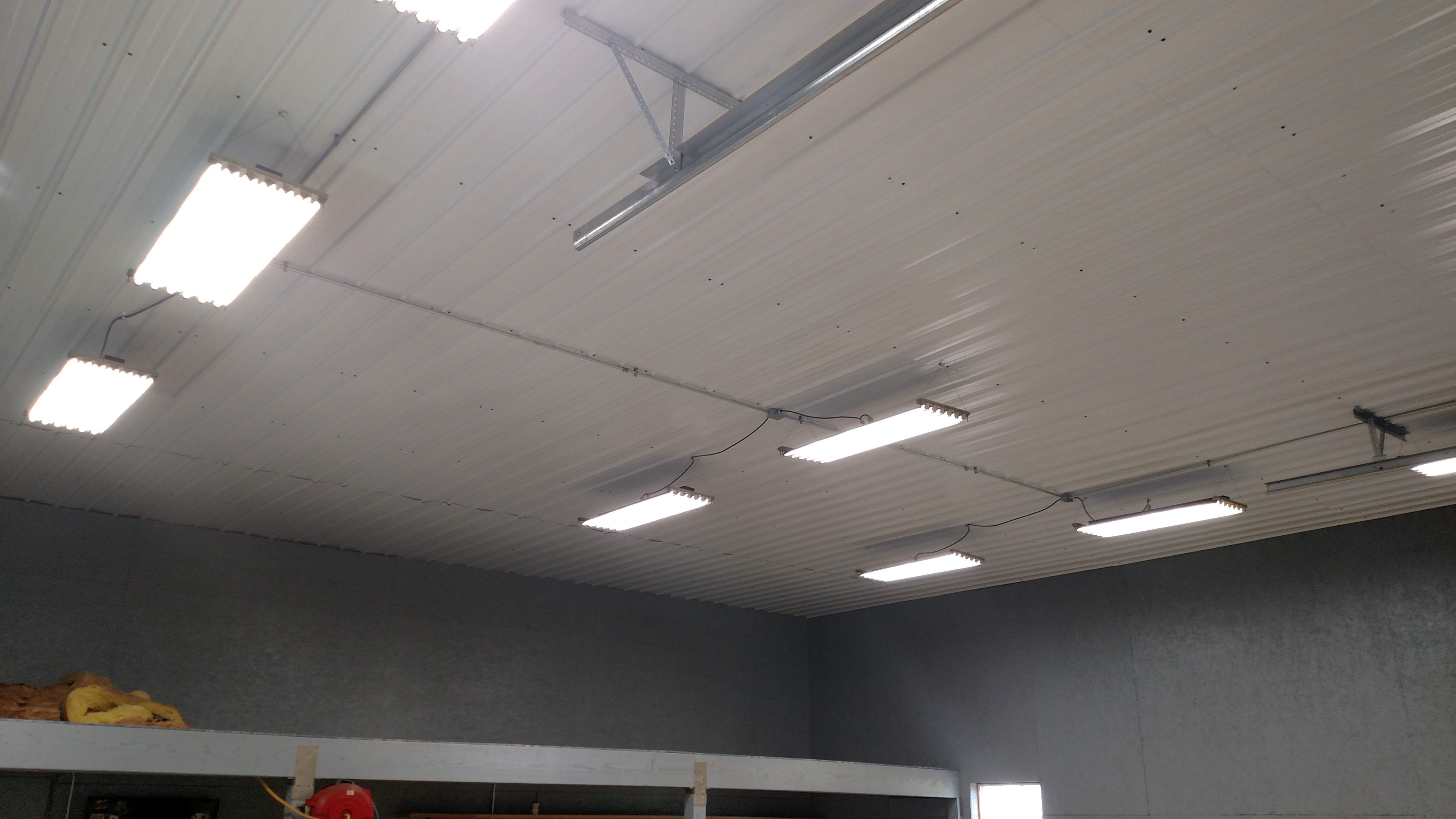

in a new 40x60 I just put in ~7 4' led fixtures from lowes . kind of expensive but very bright..
