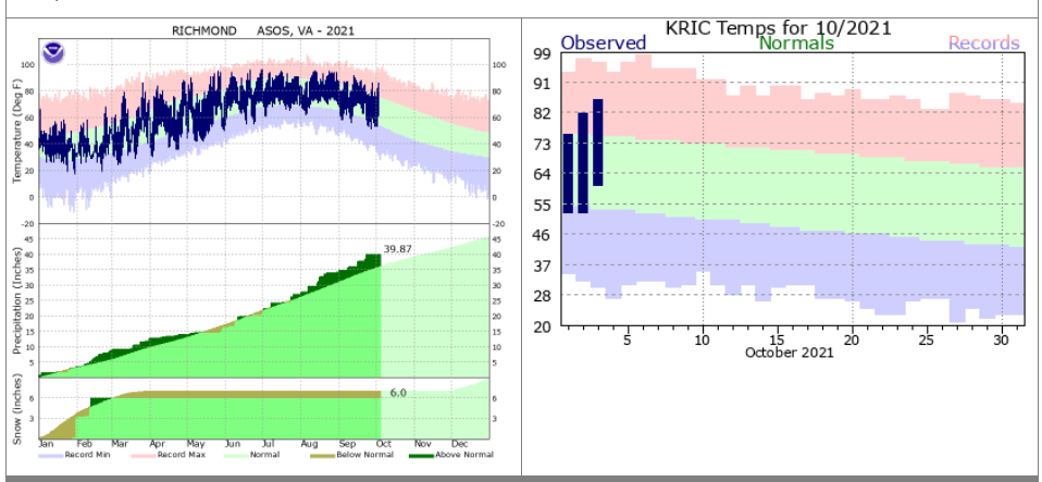

Trying to decide what type of insulation to put in an already constructed metal building. I'm leaning towards the reflective bubble stuff.
What did you use, what would you have done differently, love it, hate it, disaster, or absolute joy?
Climate - Zone 7, central VA. Nerd stuff that matters.
