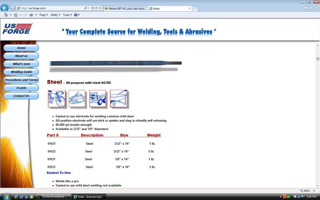

No the US Forge version will not carry the 80T-AC designation that is exclusive to the Messer brand. That said, If you happen to go to the Messer site and the US Forge site you will see their address is the same and their factory address is the same.
I am only guessing that the US Forge number of 01621 for 3/32" diameter or 01631 for the US Forge is the same as the 80T-AC since it would not make sense for a common factory to make two blue in color rods with the same specs yet with different ingredients.
Attached is a screenshot from the US Forge page if that helps you any
