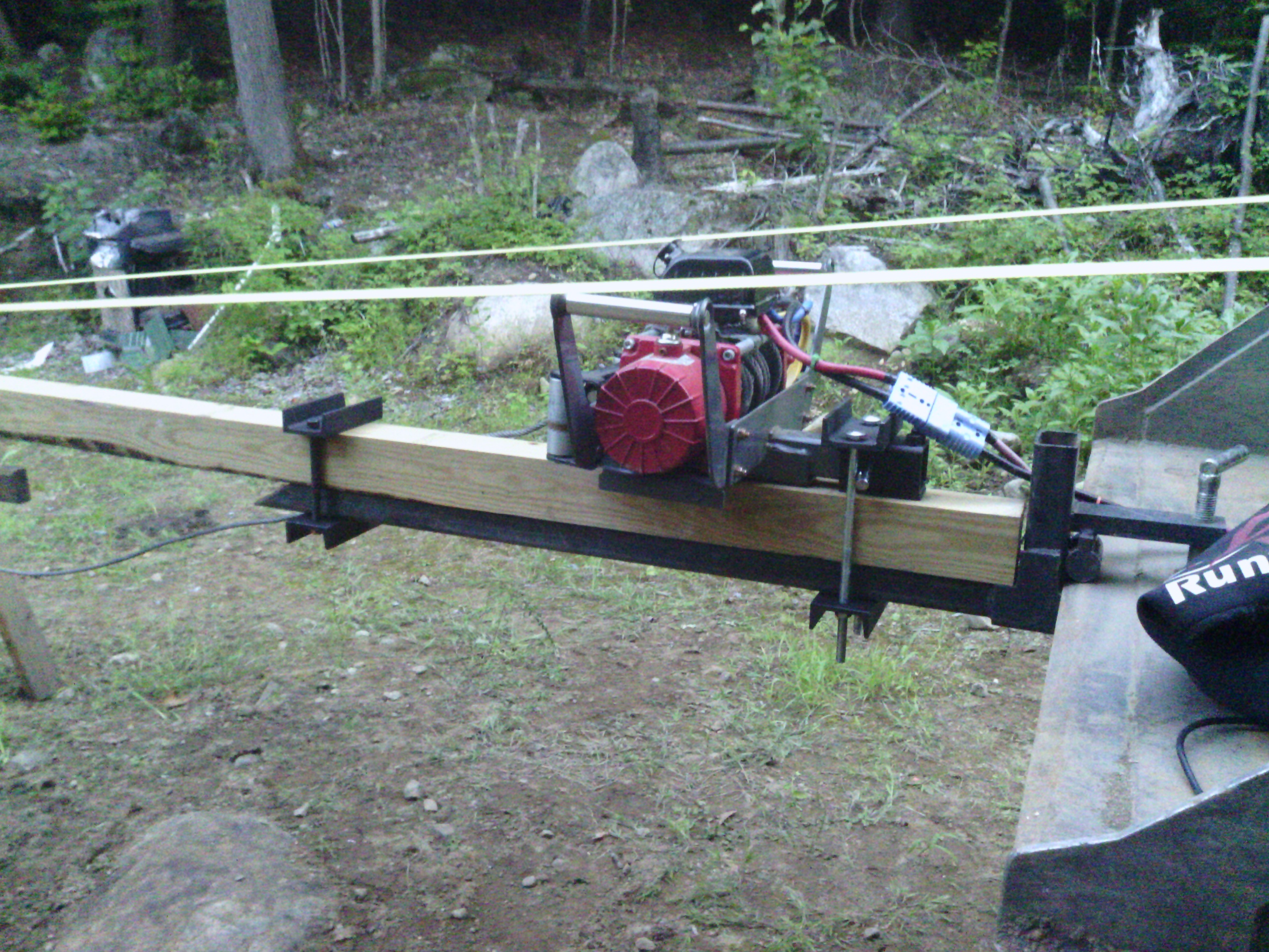

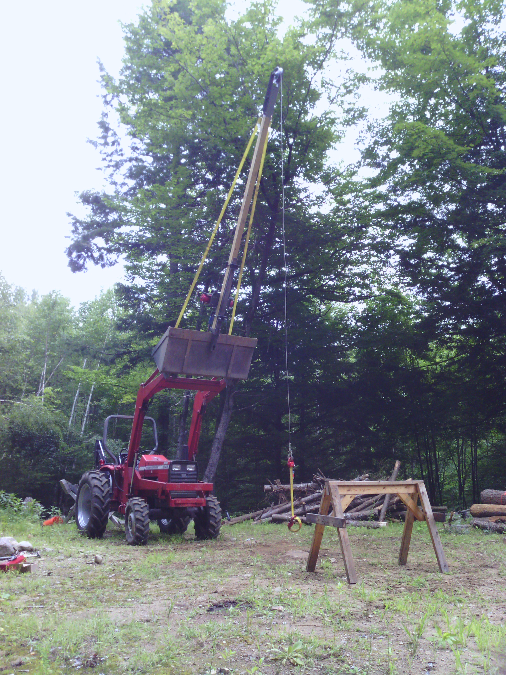

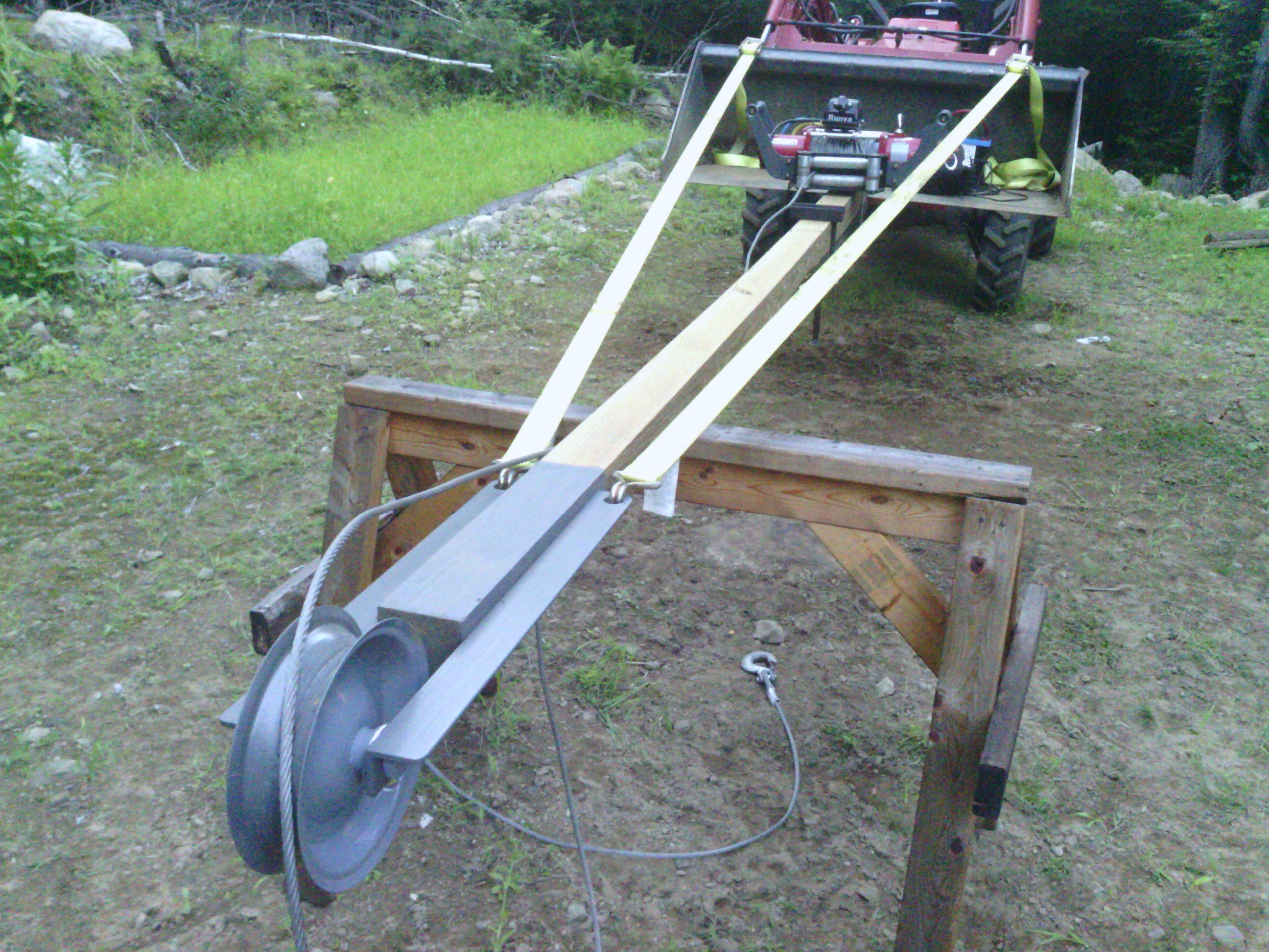

Could you have gotten by without the winch by lifting and curling the bucket to adjust the height of the trusses?
   / Members home made attachments / improvements #352
Beautiful work!!!
Probably not at that length. Very jerky and dangerous that way. If it was shorter, probably.

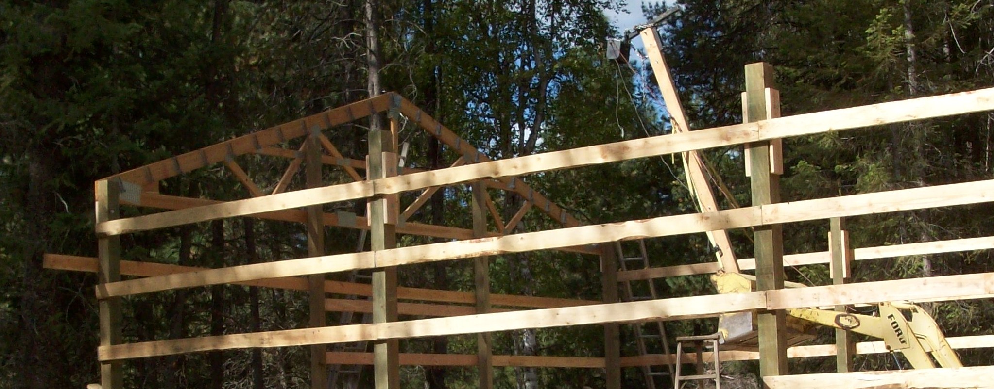

I like it! did a similar deal when building my garage with my Ford 3000 and mounted one of the little winches on the top of a double 2 x 6x 13 foot mast. Walls were 14 feet.
It worked great for me and a friend to set the trusses for the garage.
These kind of truss setters have saved some of us tbners enough money,( that was not spent on a piece of rental equipment ) to buy a good used attachment or implement for our tractors:thumbsup:

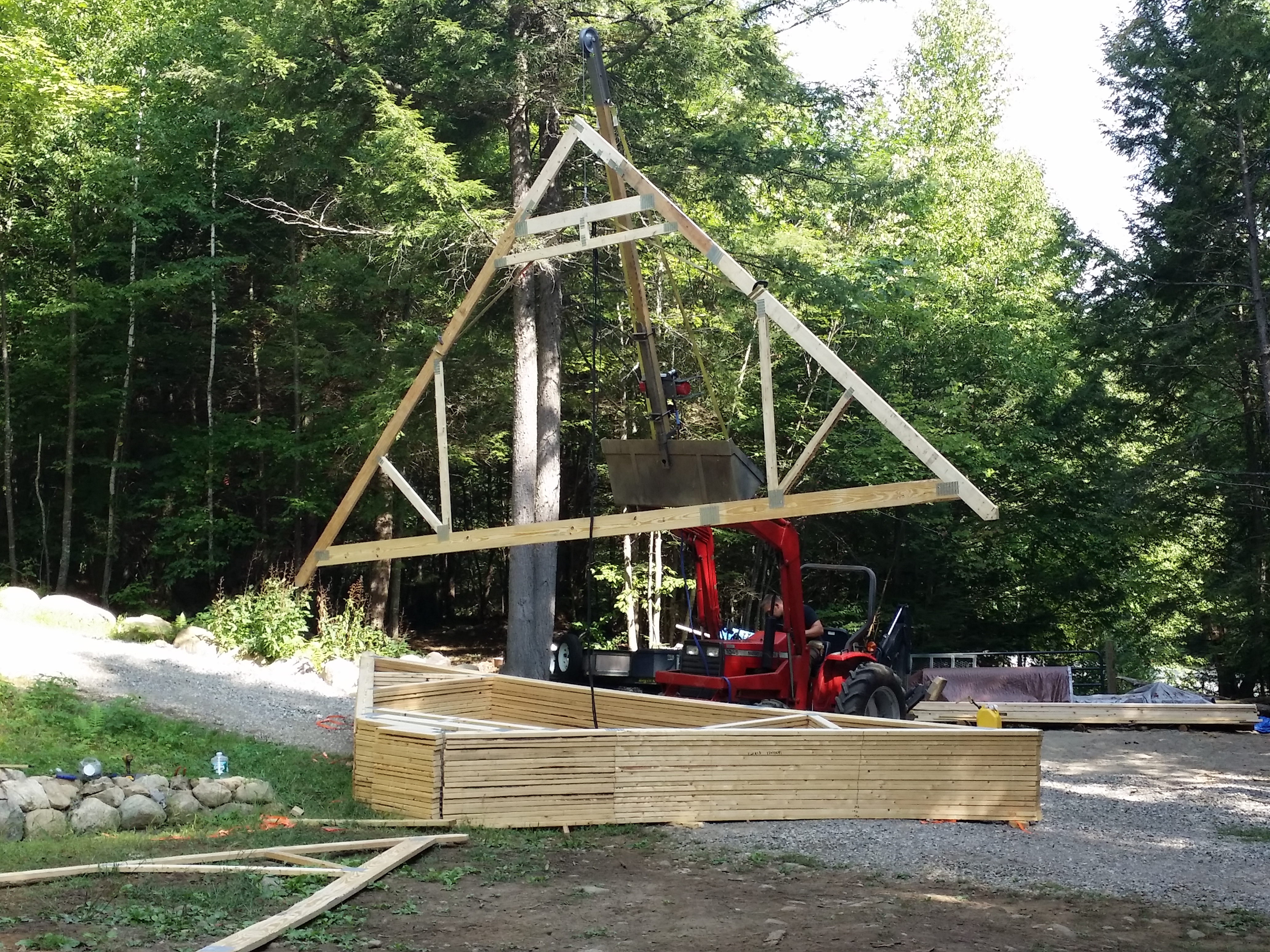

When I set my trusses I invited all the women in the neighborhood to come over. They picked them up, carried them into the garage, and handed them up to myself and a helper. 20 trusses on a 24 X 40' garage in less than an hour. Pizza, beer, and swimming afterwards.
Sounds like having the girls help worked out great,
I think it kind of depends on the type of truss being lifted- and the wall height.
Our garage had 14 foot walls and the 2x8 trusses span 30 feet (fairly heavy) also- only had the 2 of us to get them into position.
The tractor and winch /boom has proved almost indispensable for a few of us to get the trusses placed with minimal help.

Your trusses are bigger, mine were only 2 X 6 and 24 feet long. The walls are 10' on top of a course of cinder blocks so a little shorter lift also. We live on a private road with an association, have an annual Christmas party as well as a road clean-up and brush party. Great group of people!
