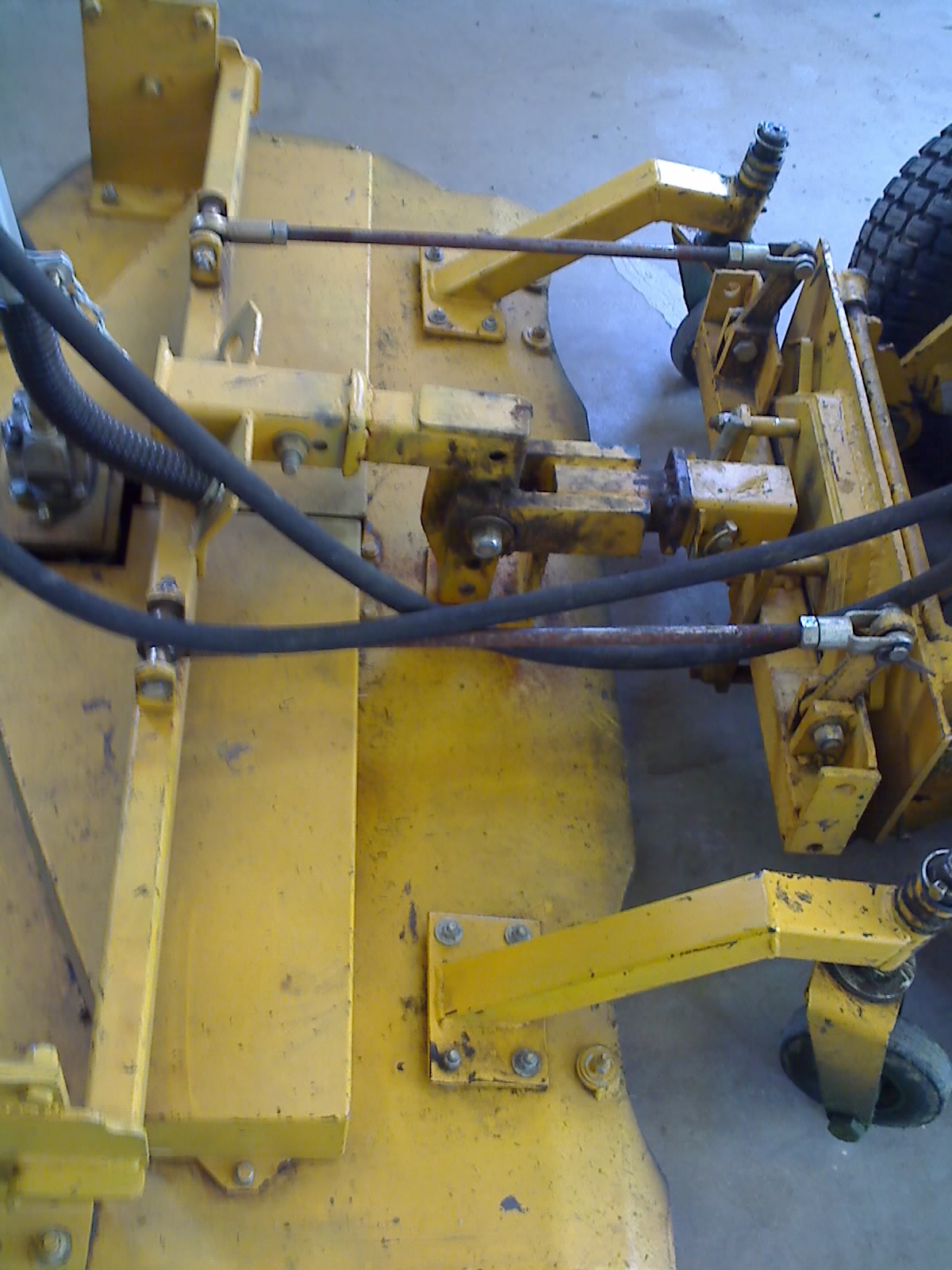

   / Me and my Gehl
I had to change the Power-trac mount to work with my tractor. It needed to be much lower. When I changed that, it was an easy matter to space the
mower out away from the front, to keep the rear casters from hitting the front wheels on the tractor.
I cut about 4'' out at the back of the mower deck so the wheels could
swivel without hitting. Afterward, I discovered that I could have cut less
because I used much smaller wheels that originally planned.
The picture shows the new mount system (actually a truck hitch mounted
upside down and some 2'' hitch parts). Not pretty, but it does work.

   / Me and my Gehl #7
That's brilliant! You even get height adjustment, if needed.
All the best,
Peter
