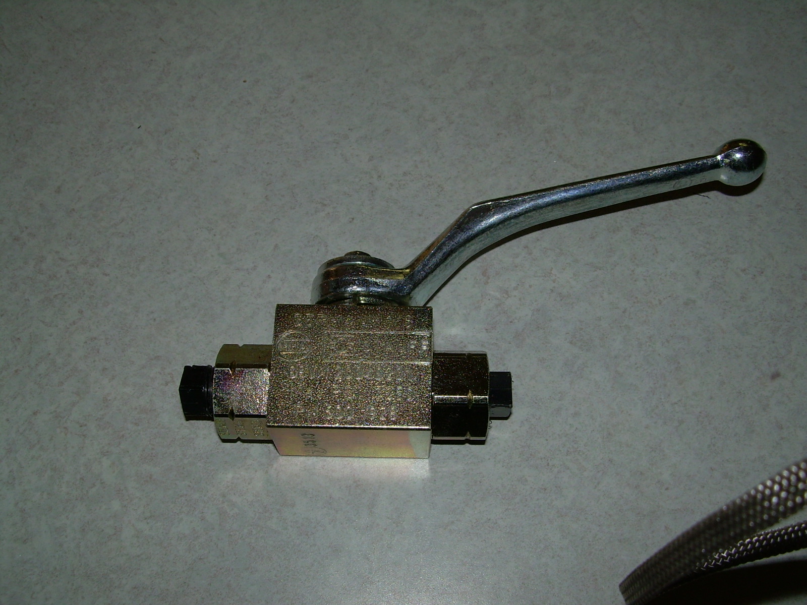

I got the valve from Surplus Center today. It looks good. I will install it later this week or maybe tonight. See attachment.
Has anyone else done this yet?

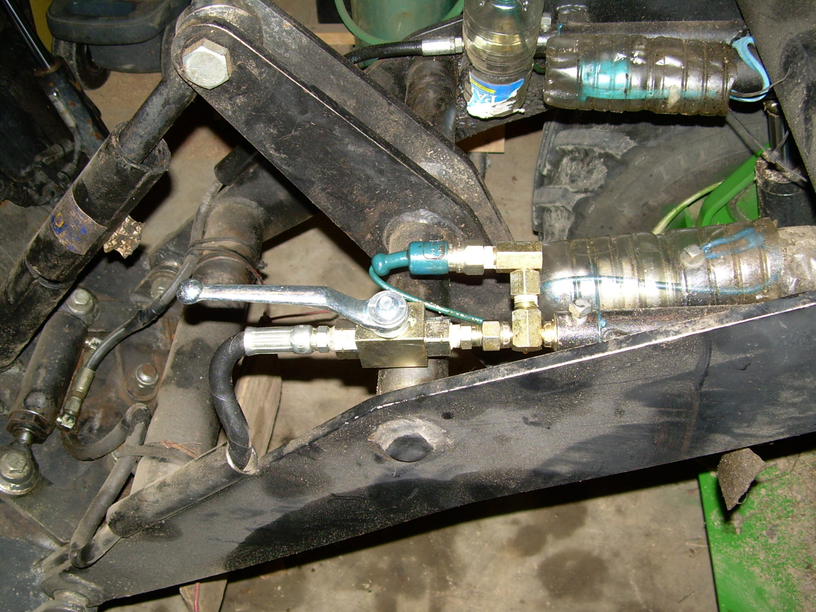

Re: Maybe a Step \'Backwards\', But Handy?
OK already, I installed it. See attachment. The handle does look like pot metal, but the rest is steel

This is one of the best mods I have seen and at some point I will do it too. Not sure if I will wait until the warranty is up but time will tell. I hate to switch from the QA to use the mini hoe or 4 in 1 so this one is for me. I also seem to always have trouble going from one to the other as I think the fittings expand under use - have you experienced this using the QA fittings and is it different now that you do not have to detach the QA?

I have experienced no problems, but I have probably have not connected more than five times since installation.
