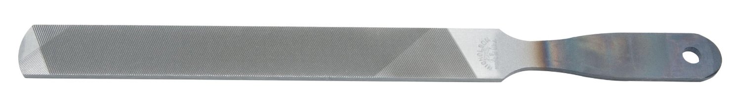

A large, double cut file to take down the nicks and get the bevel right, then a fine cut file to finish shaping followed by a few passes with a red, DMT "stone" frequently dipped in a bucket of water. It's almost sharp enough to shave with when I'm done with it. Light limbing with a sharp axe is one of life's great pleasures.

Autually, you can check for nicks on props anytime.
Checking for nicks:
