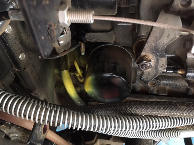

Was getting getting ready to do my 100 hour maintenance and popped the hood to look things over. Noticed that the oil filter still had yellow overspray paint on it from paint they put on the dipstick. See the photo. Thought this was odd since I had the dealer perform the 50 hr service and the invoice includes the oil and filter change. Based on this and the fact that I'm still waiting twelve weeks for a response with an issue on the FEL loader valve is it time for a new dealer ? Or is it possible the dealer decided to paint the dipstick at the 50 hr service and I'm just being paranoid.

My guess would be the dealer did not change the filter at the 50 hour service. I see no reason he would have sprayed yellow paint in that area. It wouldn't be the first time a mechanic failed to replace parts and figured the original filter would be good for at least 100 hours before a change was needed. Maybe you need to quietly confront the dealership owner with your findings. He may not be aware his mechanic didn't change the filter to save time but billed you for it. If the dealer agrees with you he may not charge you for the 100 hour service.

The yellow paint is not factory, have never had one come through like this in all the years we have been selling Mahindra's, not sure why the dealer may have painted it yellow, almost looks like they were trying to paint the dip stick. But why one would not pull it out to paint it is beyond me.

One way to confirm if the filter was changed, try to take it off. If you need the strength of an 800 pound gorilla to remove it, then it is original.
I think maybe the dealer just spray painted the dipstick to make sure that you could find it easily. As to why they didn't just remove it to paint, maybe the painting was an afterthought and didn't want to wait for the paint to dry before installing the dip stick.

That is definitely not factory. Looks like the dealer tried to help you - it can be just slightly tricky to find the factory black dipstick tucked away where it is against a black engine block. Kind of a quick/sloppy job, though.

I generally check the oil every couple of times I use the machine. I wasn't concerned about the yellow paint on the dipstick, I was concerned that there was yellow overspray on the filter that was supposed to have been changed at 50 hours. If it came from the factory or it was done as predelivery, it would indicated they didn't change the filter. If it was sprayed after the 50 hour service, no issues.

My guess is the filter and oil were changed and then the paint came on afterward so it would be easier to find the tube the next time. Nobody would paint something and then wait hours to dry before they worked on it.
