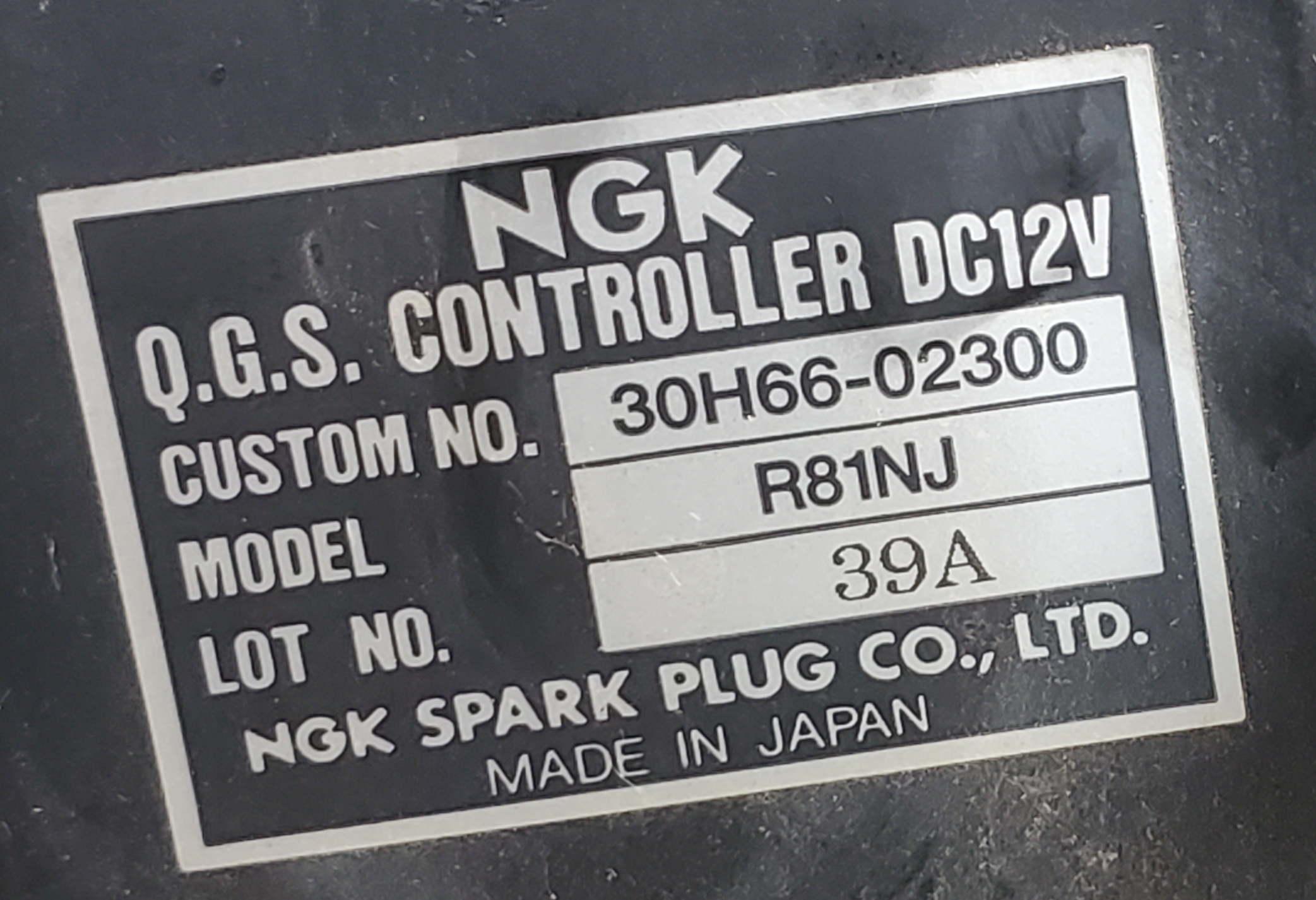

Max 28 shuttle won't start. New battery early summer, new ground cable and all terminals clean. I was able to start it by jumping the solenoid terminals with a remote starter switch last month, but now it'll turn over but won't fire. There's no power coming to the two smaller wires, black and red, going to the solenoid/starter when turning the key. The NGK glow plug controller buzzed a few times, but now there's no noise coming from it. No dash lights. no headlights, turn signals, everything is dead. Main fuse is OK along with the solenoid fuse. Does the glow plug controller supply power to everything or does it just run the glow plugs? Any ideas?

To answer your question - the glow plug controller probably powers just the glow plugs. With the cooler weather you probably need functioning glow plugs to start the engine from cold. If your starter rotates the engine and you have fuel at the injection pump you should start - assuming you also have a clean air filter. If your fuel filter is clogged or something is preventing fuel from flowing from the tank you'll get no start. Most newer tractors also have a fuel shutoff solenoid. Make sure yours is opening. If it stays closed you'll get no fuel to the engine.

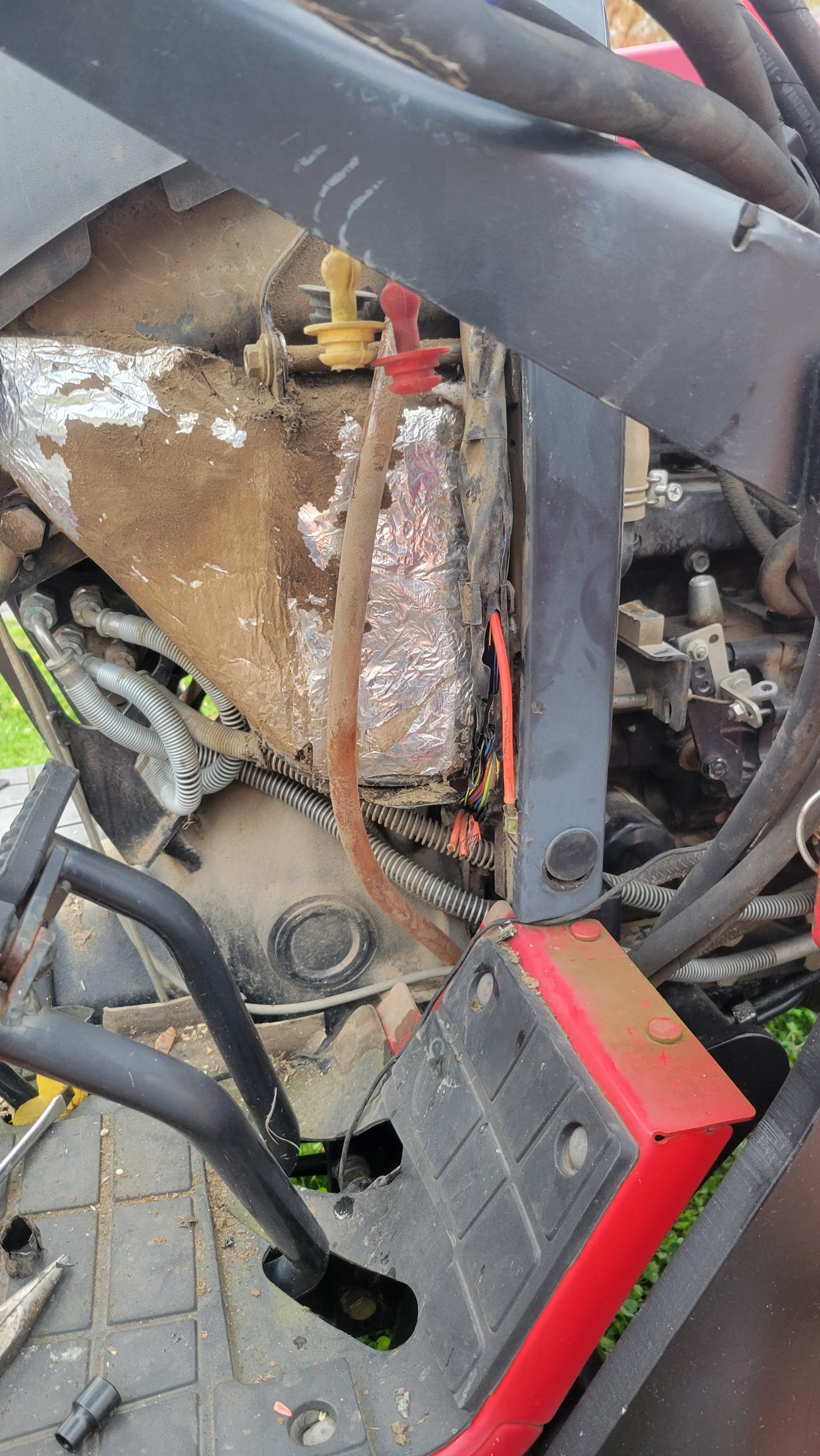

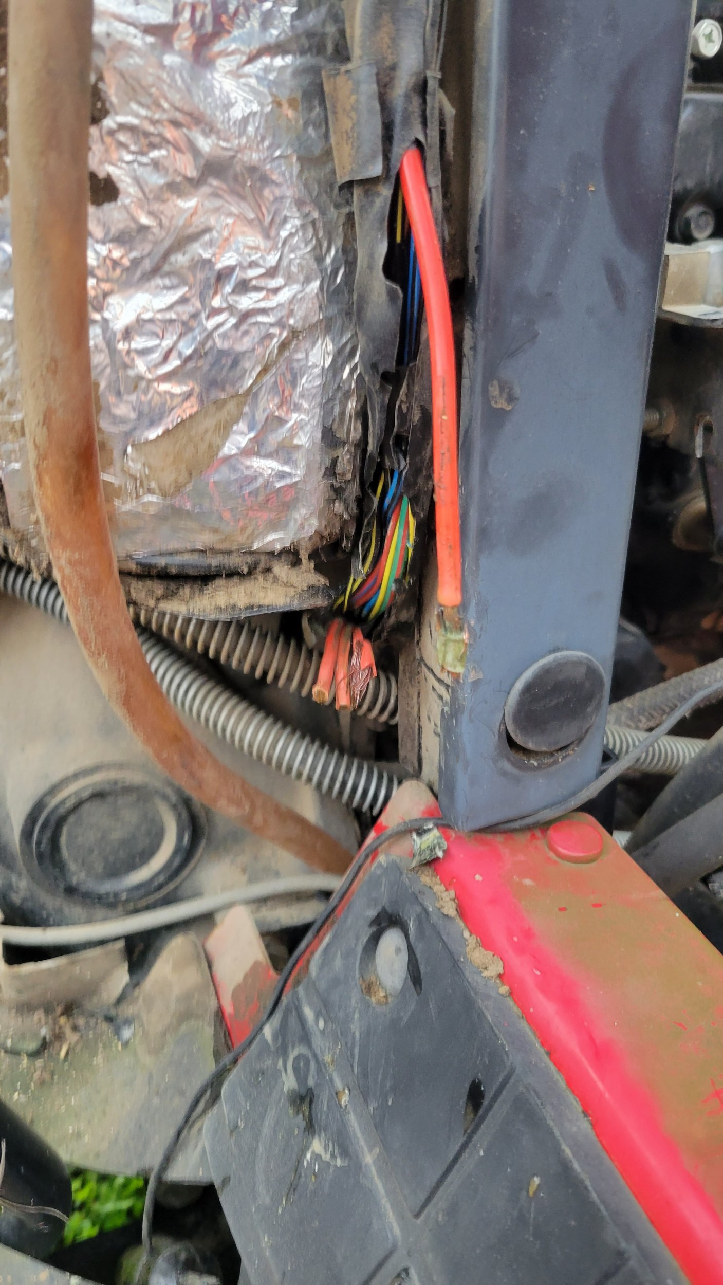

Found the problem. The wiring harness on the right side under the dash collects water and of course the main hot wire splits into three wires right at the bottom where it bends and enters the engine compartment. It's just a crimp connection and the water in the harness causes it to corrode and eat the wires at the connection. Absolutely the worst place you could put such a connection.

Found the problem. The wiring harness on the right side under the dash collects water and of course the main hot wire splits into three wires right at the bottom where it bends and enters the engine compartment. It's just a crimp connection and the water in the harness causes it to corrode and eat the wires at the connection. Absolutely the worst place you could put such a connection. View attachment 720578View attachment 720579
Looks like a tinfoil sandwich was left in there.

Don't know where it comes in from, but it dripped for 10 minutes after I opened up the harness.

is your machine stored outside? doesn't look like corrosion more like it broke from vibration, wire looks clean, also interesting its another max28
