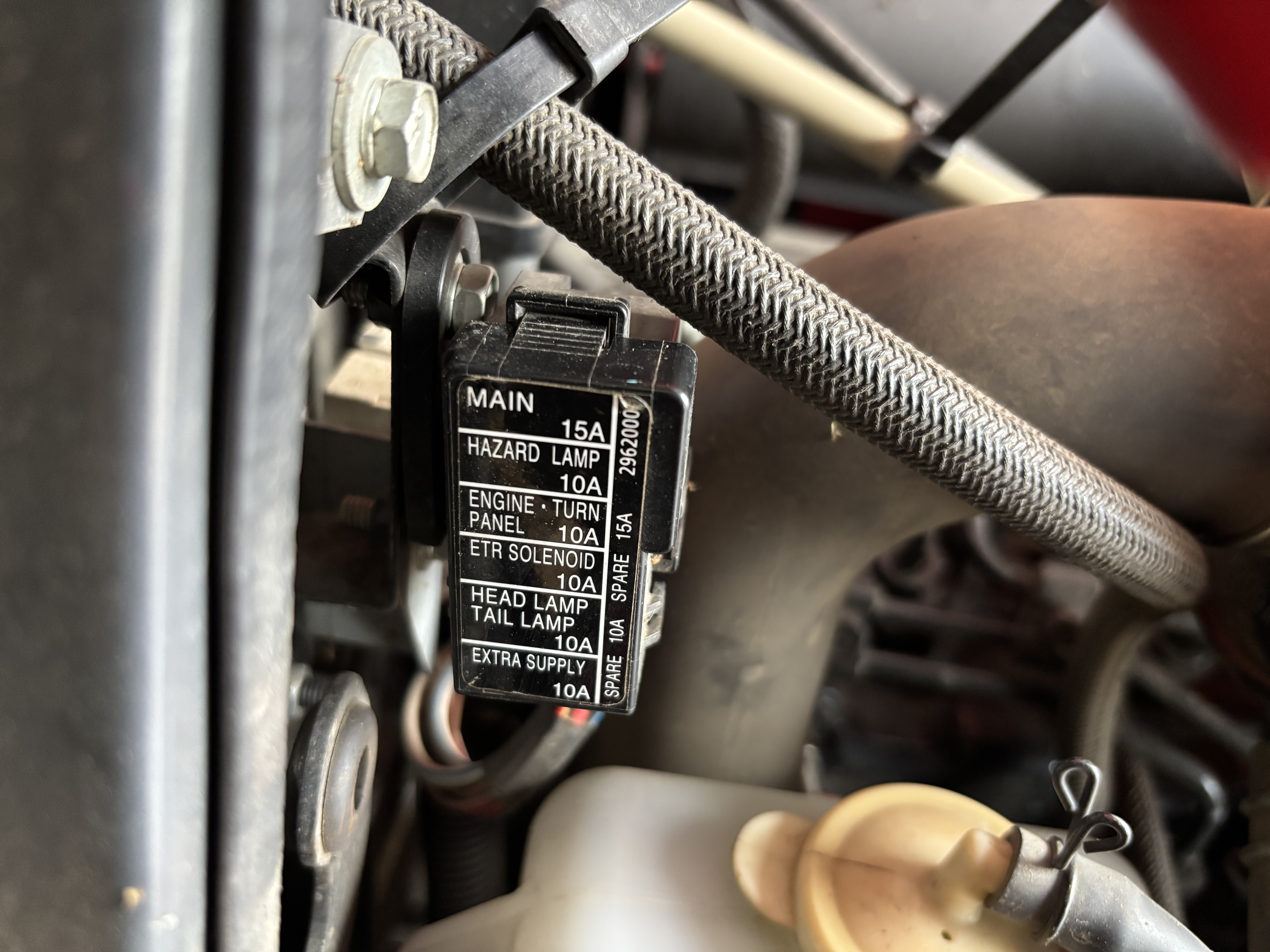

I was running my 2014 MAX28 today and it just quit. Of course I was as far on our property as I could get! Wouldn’t turn over or anything. After checking a few things I found the ETR fuse blown. I replaced the fuse and it started right up and I was able to get it back in our garage. Now I know fuses don’t blow for no reason. I’m going to check the wiring and plug connections on the fuel shut off solenoid. I replaced that a couple of years ago. Anything else I should check? Anyone have this problem before? Thanks

Hi Mitch, were ya using a snowblower today?

If I recall there’s a connector in the main harness behind the plastic dash/cowl that tends to get corroded especially on units left outside. There’s been a number of threads on it.
