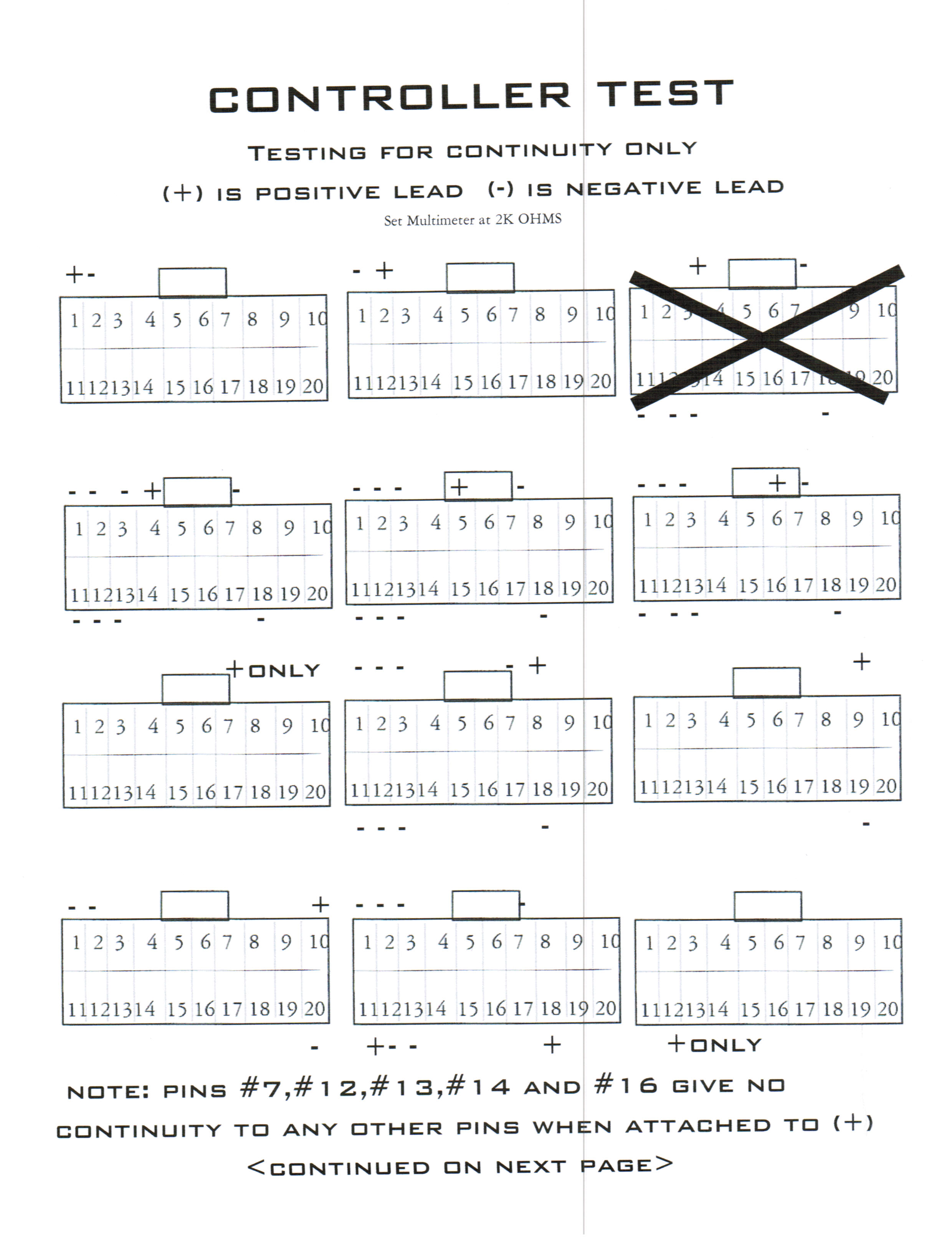

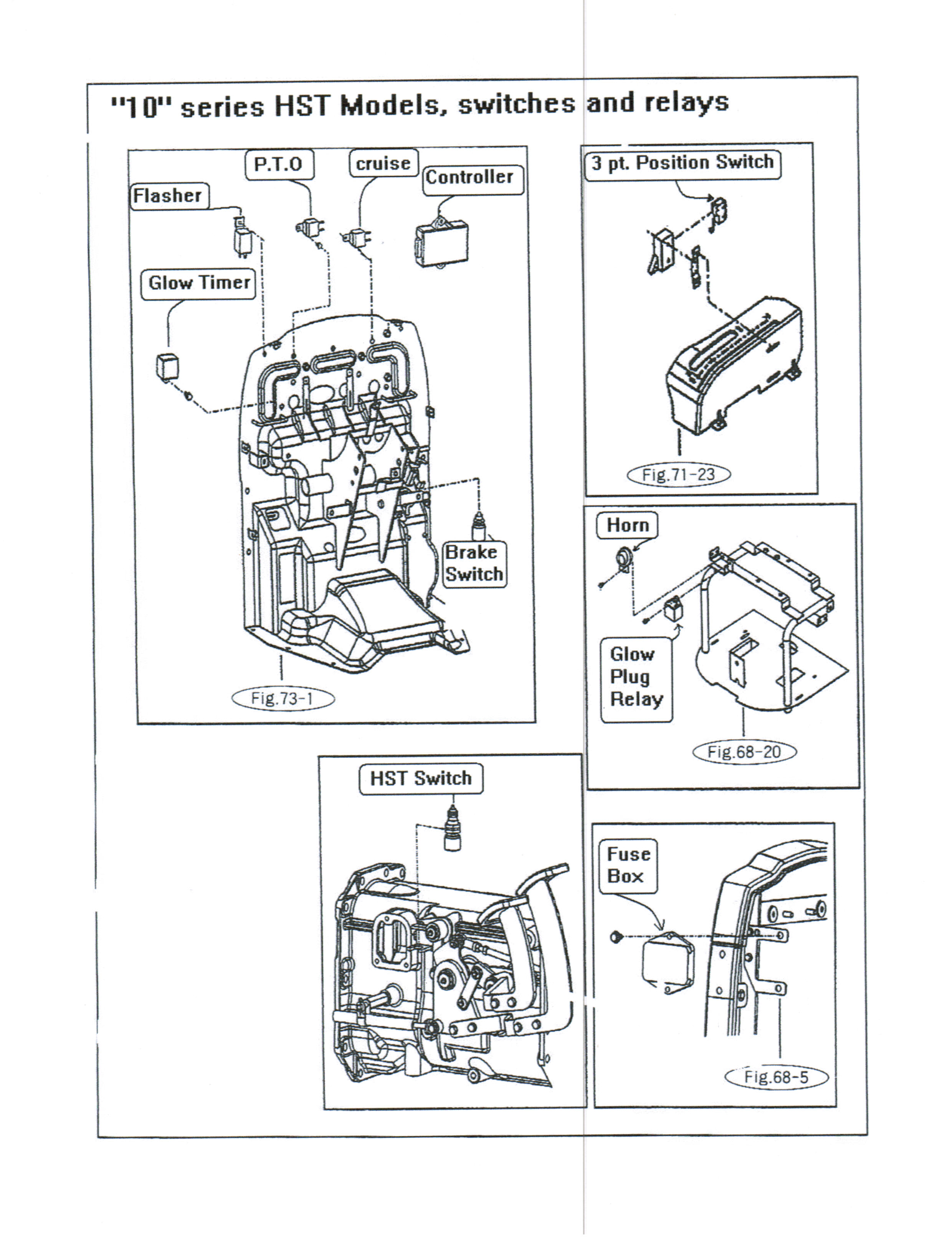

I posted a similar story for a Mahindra 3016 and got several suggestions I have tried to follow with no success. I cannot find a wiring schematic to see where the safety switches are. There are no wires attached to any part of the seat. I find no switch in the clutch linkage unless it is hidden way up in there somewhere. There is a switch on the I/O PTO lever - left side and I assume there is one in the yellow PTO on/off knob one must push down and turn to activate the PTO. Battery is OK per Auto Zone I watched him do it, replaced negative batt cable, cleaned - and + terminals. Flasher/4-ways work - bright, headlights don't work - nothing works but flashers, glow plug light/batt light/ no dash lights come on - Does anyone know where I can find a map of safety interlocks?, any ideas? I worked fine when I plowed snow - not deep 3-4 in max. next day it wouldn't start, then apparently made a connection and did start and I used it again for snow - now nothing. Checked F/R lever, put everything out of gear - it is a gear, not HST. Frustrated - PS it was enlightening to find out how easy the battery came out once I figured it out - looking for a similar miracle - service is 80 mi. away.
Thanks,

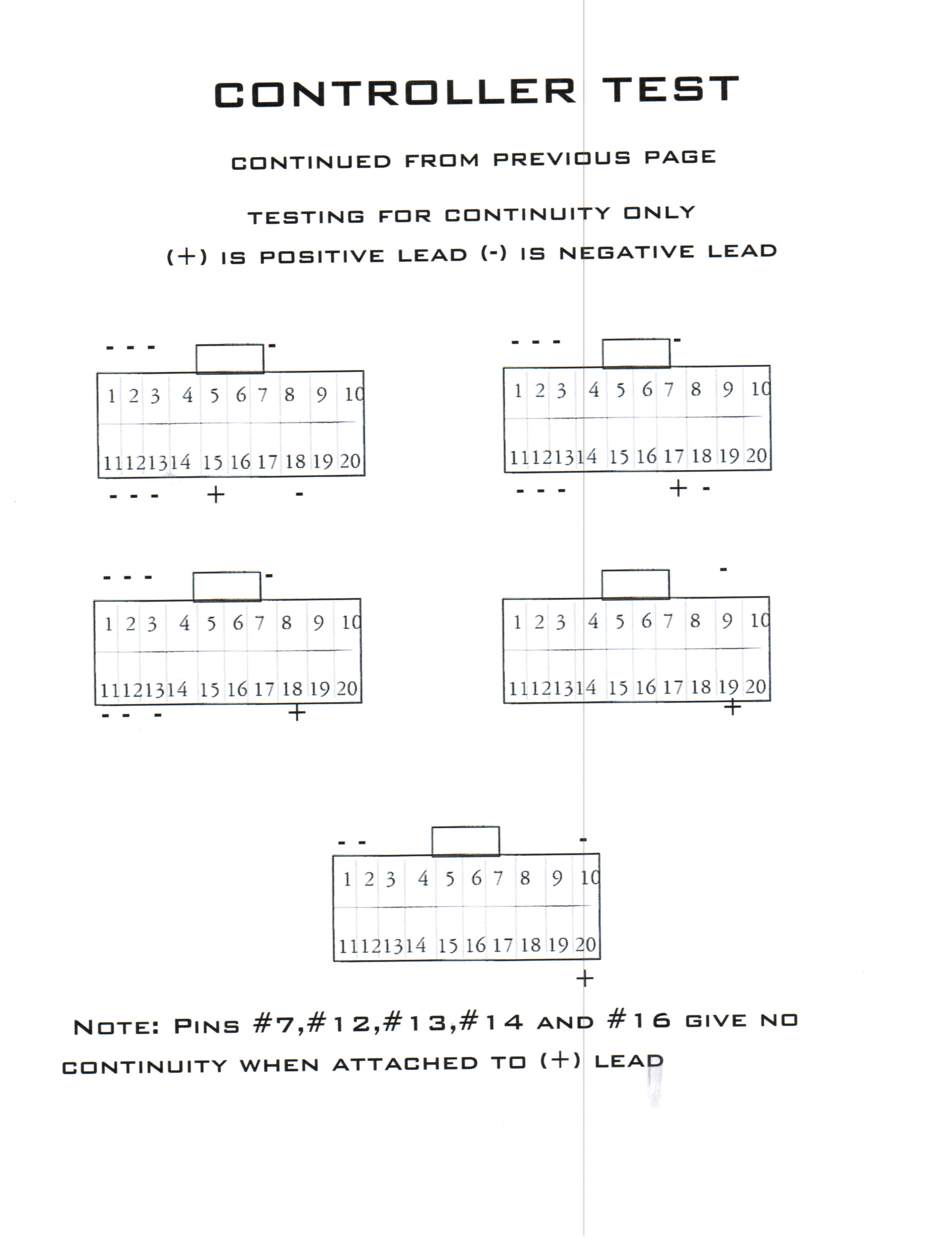

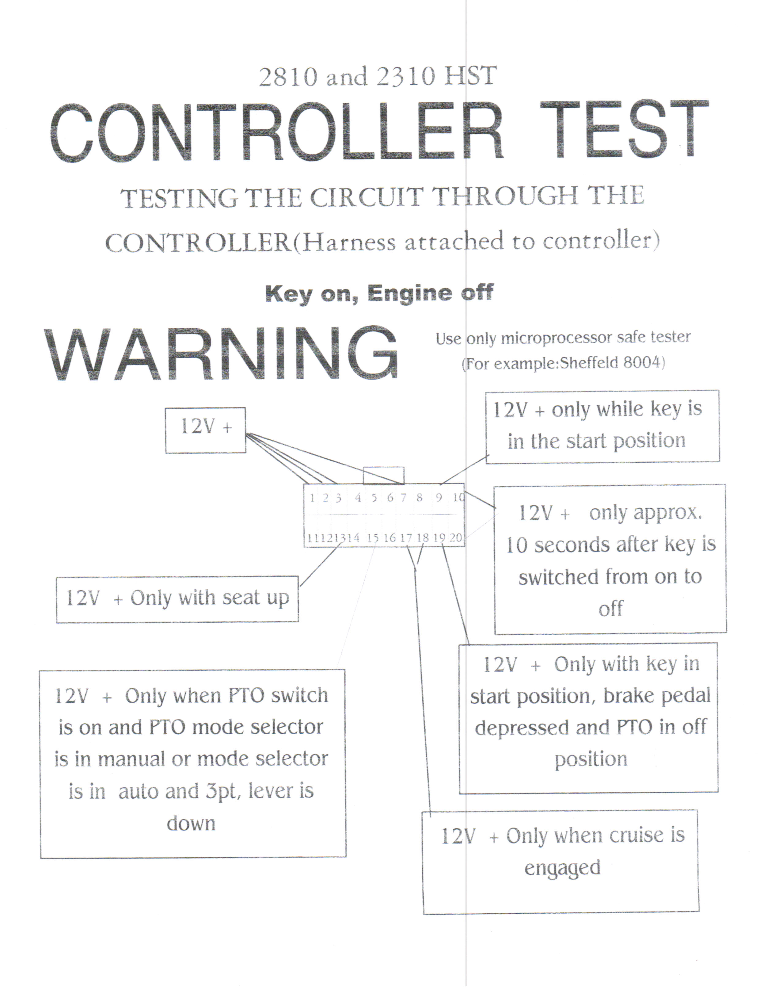

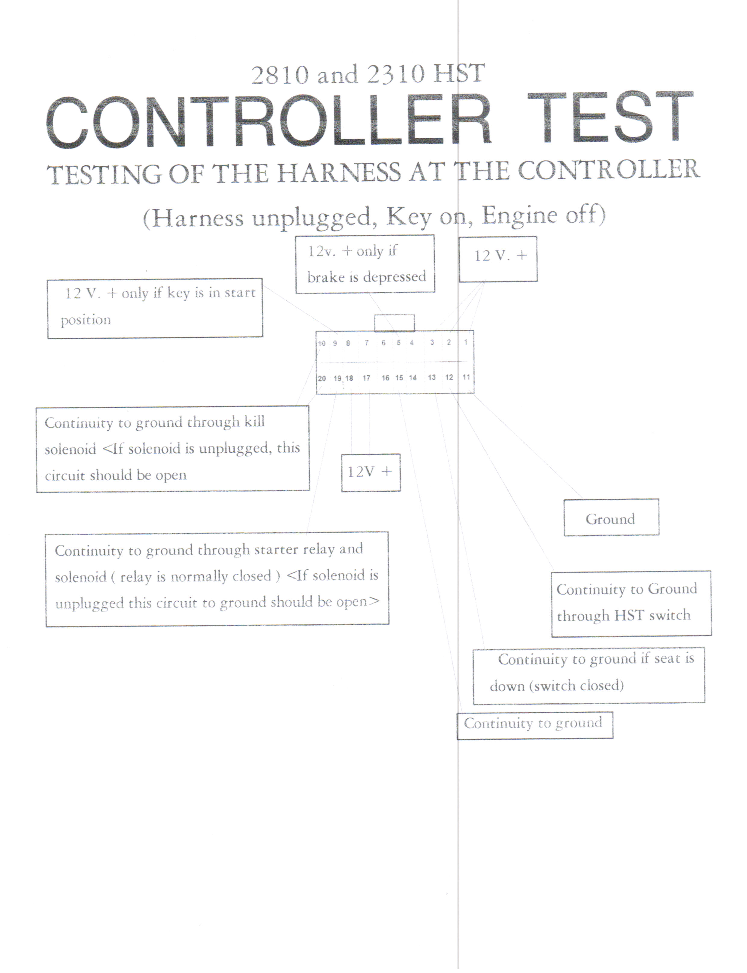

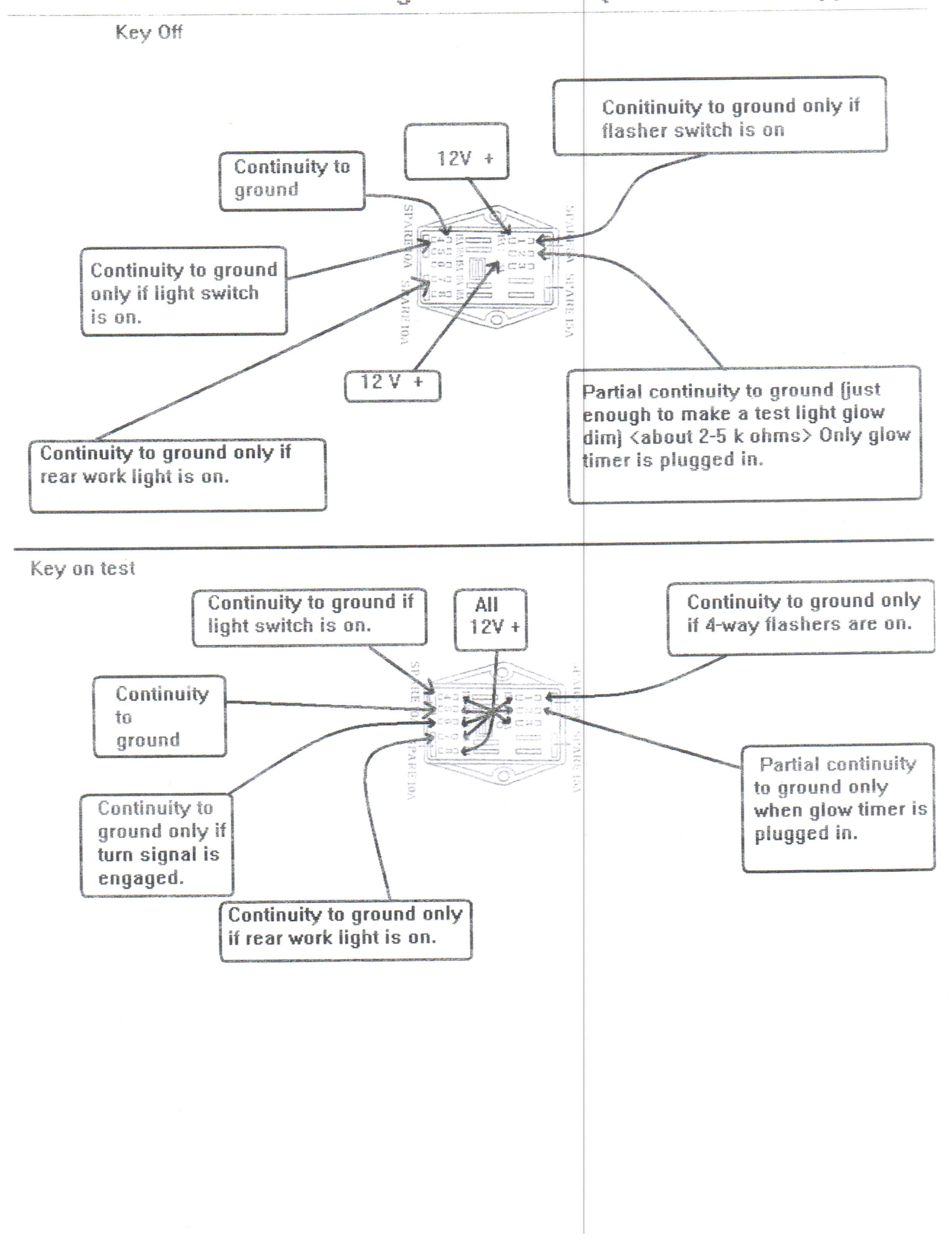

I have TYM 330. I think that is identical tractor like your Mahindra. My is HST though. There is black box under the dash that gets all the iterlocks and then enables the starter. I don't know it also operates the headlamps but it is conencted to the dash. It failed and I had to replace it. I paid about 120 USD for it. Attached are testing instructions.
