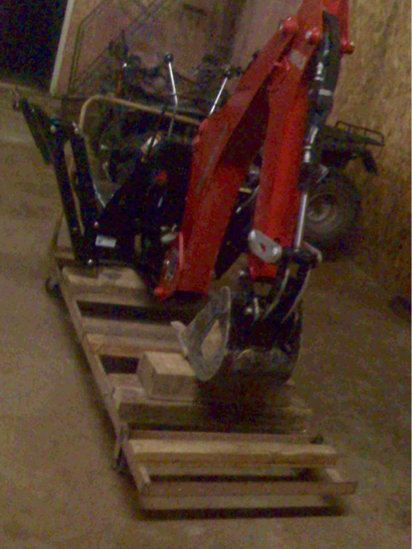

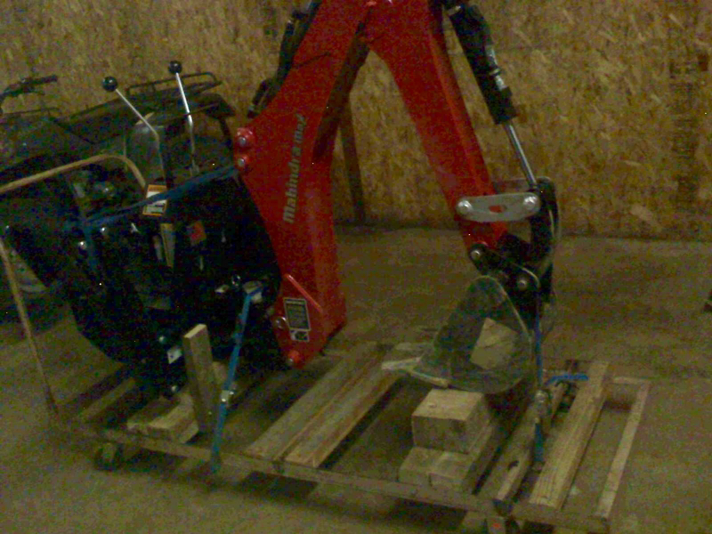

I made a cart so I can wheel it around the shop, it stayed in that position all winter.

Also I put a ratchet strap across the stabilizers to keep them from leaking down. It worked great!
