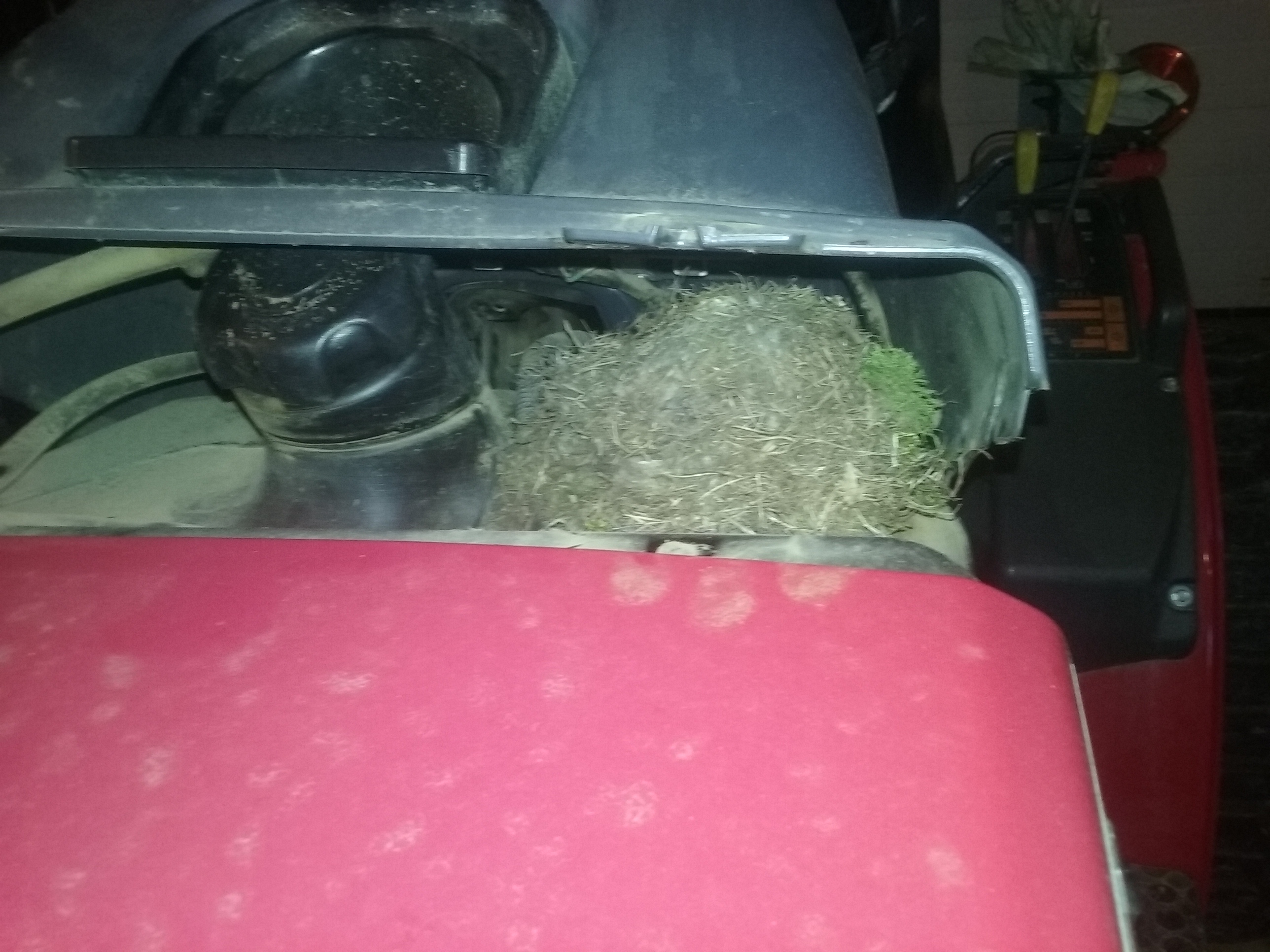

I put the tractor in the garage and proceeded to pull the dashboard off and found a ginormous mouse nest on top of the fuel tank. It was setting on like three of the connections for the dash board.
Removed the nest, blew out the connections, tightened all the screws on the dash board, applied a touch of di-electric grease to the connections and snapped them back together and since I had the battery disconnected while I removed the dash, recleaned the battery posts and removed the bolt that connected the negative terminal to the frame and sanded the frame just to be sure I had a good ground. Also added the felt battery protectors under the battery connections to help prevent any further corrosion. I checked all the 10 and the one 15 amp fuses in the fuse block and they are ok. I checked the two 50 amp fuses, one up front by the battery ( that had previously blown from the wires being too short on the seat safety switch and then pulling apart and shorting out and then the tractor would not start) and the other 50 amp that I found wrapped in electrical tape by the starter.

Wondering if the giant mouse nest (Yes, my mistake for leaving it set outside even if it was covered) has shorted out the dash board and or the ignition/turn signal switch.

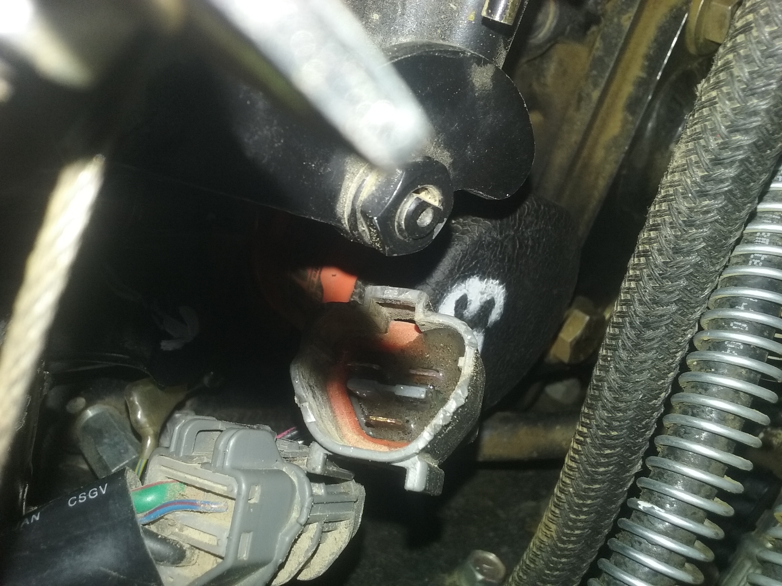

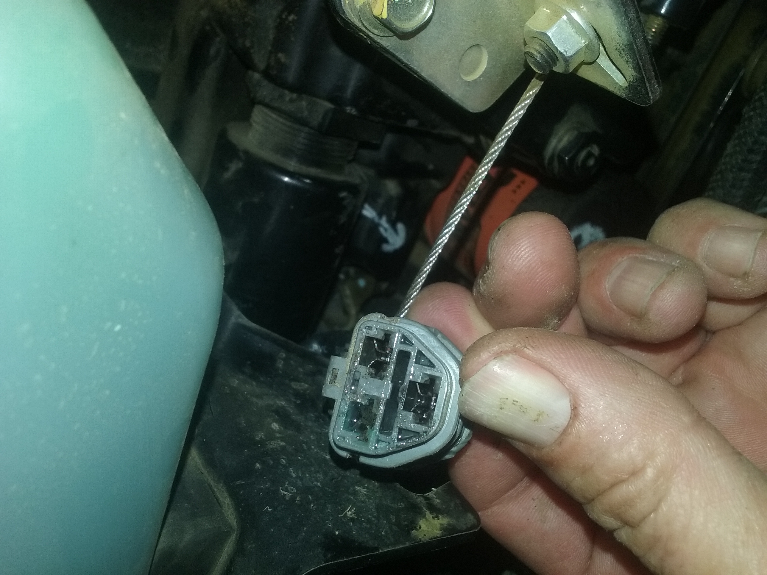

I took the loader off of the tractor to be able to get a little more personal with it and pulled it into the garage.
I was reading a thread on here before I joined about checking electrical connections ( I don't know what the technical term is? ) for water.
I started following the wires from the battery looking for wear spots on the frame as RNeumann was talking about, (great minds run in the same direction!) and then I started unplugging connections.
I was thinking, ya right, water!
Wow.
Not sure if this will be the cure to all my whoas but from where it came from and to where it was headed too? (The wires in and out)
It sure fits the symptoms.
Seriously? That much water????
Fingers crossed.
I had a heck of a time getting that 'fitting' apart and was about to give up when I thought......it probably isn't coming apart for a reason.

CRC'd the plug in my pictures and sanded and filed and applied a coating of DI-electric grease.
Saw a electrical fitting behind the coolant tank that was in the vertical position and removed the tank and had a look at it. (in case of water)
Checked all the fuses with my VOM and they were good to go.
Reconnected the battery and ...
No Joy.
The issue persists.

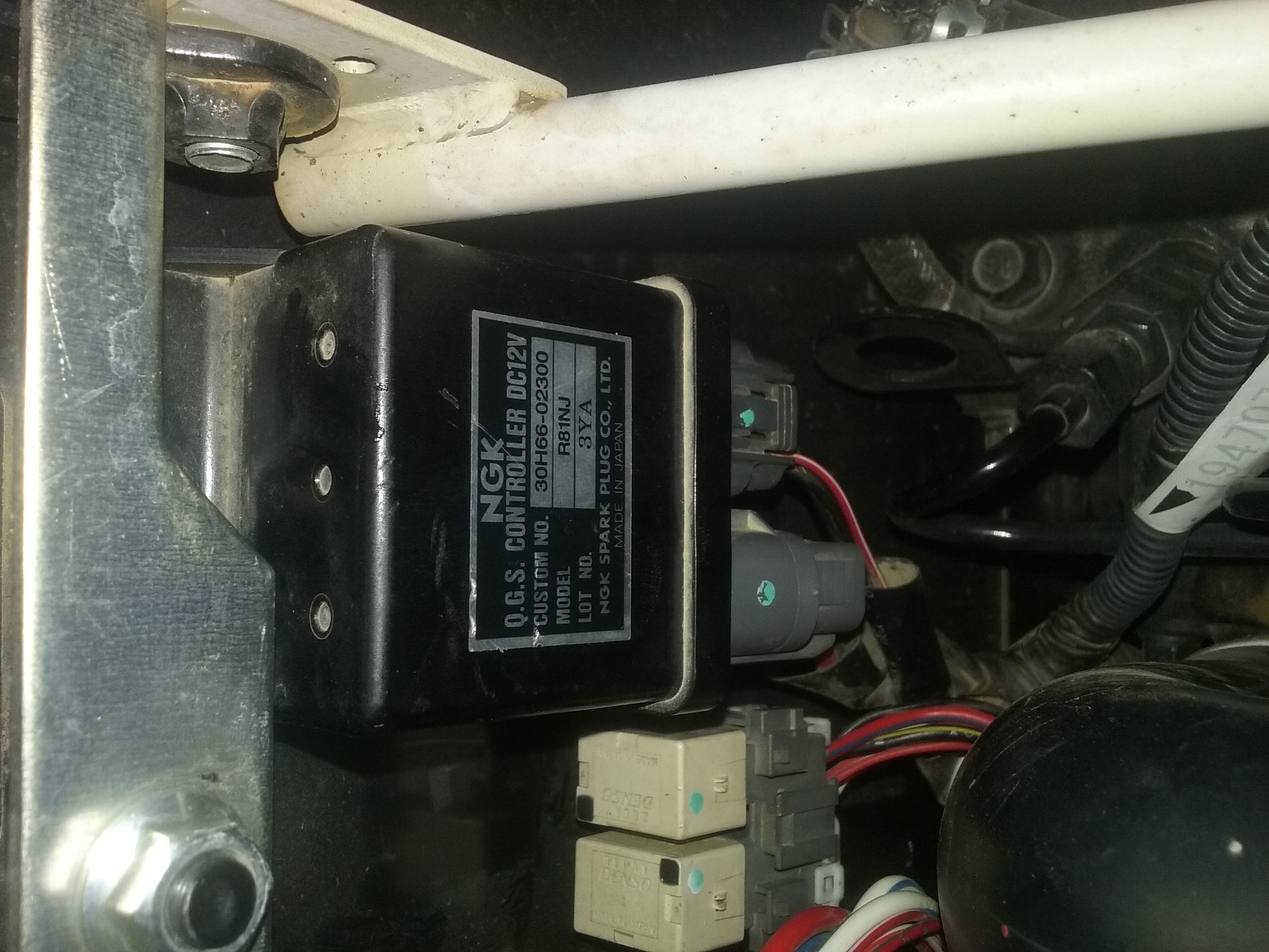

What does the relay in the pic control ?
Ready to send it to the shop.

"What does the relay in the pic control ?"
I haven't owned one of these tractors but a shop manual should tell you. Can you not tell which terminal is power in,which is power(s) out and which are signal circuit? Knowing that,you could see if 12v is reaching relay,if power is leaving relay and if signal is reaching relay coil. You might be able to hear relay open/close so I would remove one then listen to see if relay operate's at key on,lights on,hazards on ect. I have to say the fuel guage is the joker in the deck, so ground seem's to play a part in this. Since warning lights and other dash functions are acting up,how about a temporary ground jumper (booster cable) from battery post to dash assembly to see if dash isn't makeing good contact with remainder of tractor or if frame to dash ground strap is bad? If you plan to troubleshoot in the future,I highly recommend buying a shop manual. Dealer techs could never do their job without manuals,don't you think diy owners need one also?

I don't own a tractor like yours but I would bet that is your glow plug relay(controller).

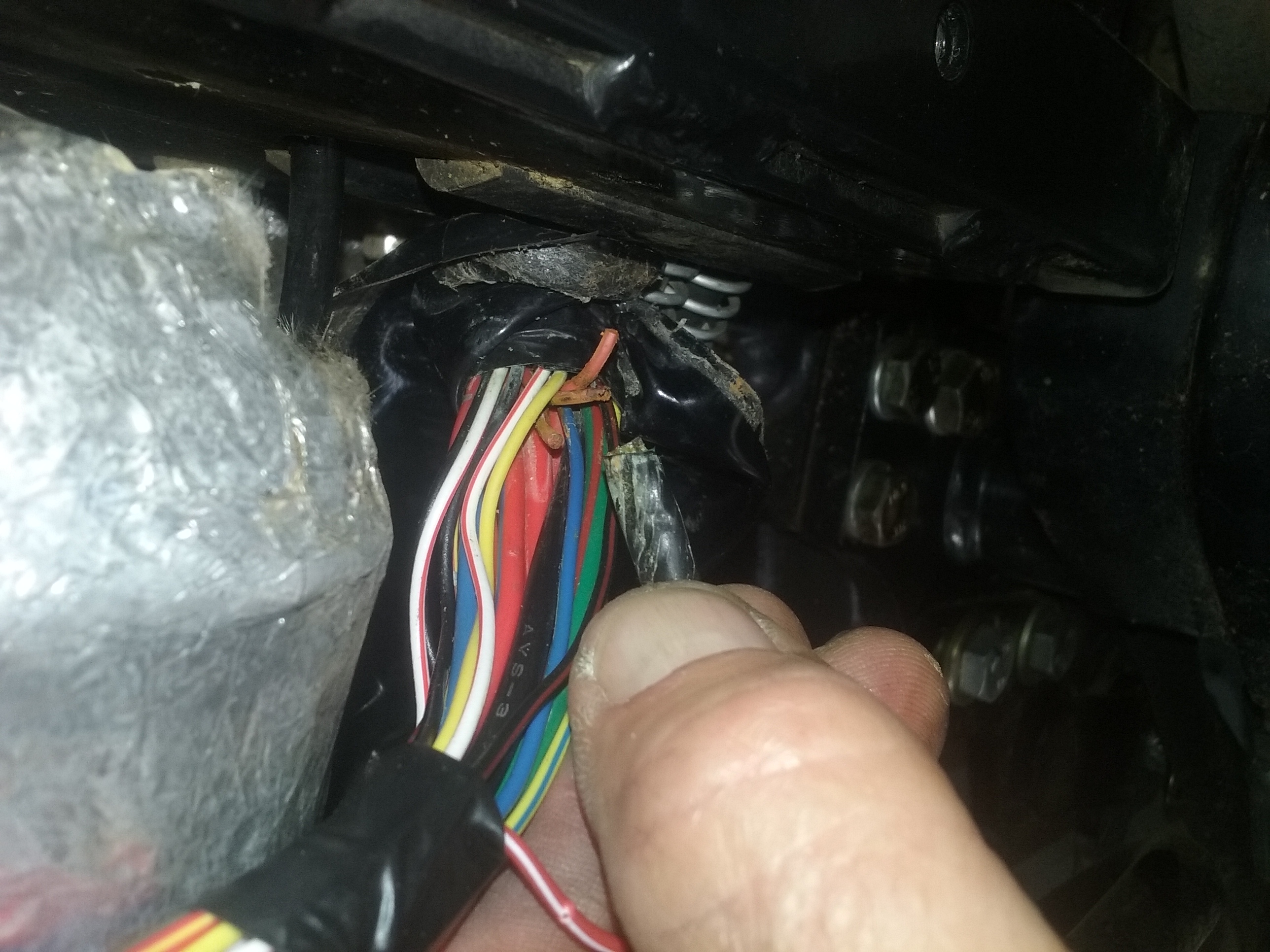

Wasn't mice nor manuals.
Just poor workmanship.
Speaker sized wire running thru the frame that broke at a crimp.
Are you kidding me?
Would never recommend Mahindra.
Wires in the harness were at 'passenger' side down low where it goes through the frame
