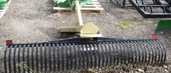

I found a Landpride LR2584 rake that's rated up to 50 hp. I have a 56 hp tractor. Can the rake take it?
/ matching landscape rake and HP #2
A lot more comes into play than just horse power with a attachment like that, tractor weight , type of use also.
They changed the design of the tine bar during production of that model, not sure which your looking at but if it were me I’d prefer the early version.
right now I'm looking for something to groom my gravel driveway. Other uses might be leveling off low spots around the property and maybe a path through the woods. Thanks.

I know of some owners like least foot of rake be on tire at 45 degree angle...drop down grader blade comes in very handy.
I rented a York rake last week that had both and scarifiers. At about $4k new it is the swiss army knife of landscaping attachments. I'm not a rich man though.
They do /did sell a blade attachment for the Land Pride LR25 series rakes. I don't think 7' will cover the width of the tractor on a 45 degree setting. I think I can deal with it though. The asking price on this one is pretty reasonable. Just not sure if it will keep up with my tractor.
/ matching landscape rake and HP #6
A Landscape rake like that is not a heavy tillage or heavy grading item, I think I could tear one up with a 30 hp tractor if I tried.
On my gravel driveway which is 1/4 of a mile long it works good to drag rocks out of the grass and back into the driveway but I find using it in the driveway it kicks rocks at me and back into the grass with its spring action tines.
It works well to clean up sticks after storm damage or tree removal, grading loosened up dirt and picking debris out of worked dirt.
Can your 56 hp tractor tear it up? Yes it can.
Will you tear it up with your tractor? If you use it like a heavy grading blade yes you will, if you use it for the lighter work I described you probably will not.
To give an idea I have a Landpride 35 series 6' blade on my 55 hp 2 wheel drive tractor, I will lose traction pushing downed trees around with it before bending anything, at least 12 years of using it this has proved to be the case, and when dragging it behind me I can stop the tractor before breaking anything, at least so far.
The best scenario would be to have both, but if I had to choose I can do all the things I've described with a regular grader blade as long as I keep it from digging too much.

If the rake is a super reasonable price, sure get it. But I believe that you are going to find that it is simply to narrow to be using behind your M5640.

Check to see if you can put gauge wheels on it. That’d make it a lot more useful.
/ matching landscape rake and HP #18
I have a 6' Leinbach Landscape Rake that I use to level out my cliche driveway with my Kubota L3400. I also use the gauge wheels sometimes, but not always. I've found that it's not all that difficult to break tines. I believe you'll find that your 50+ hp tractor will need to be used gingerly with any LR. Order a few extras when you buy yours; they'll be used in time I assure you.
I've also found that the landscape rack is great for de-thatching the yard. I set it for the least angle of contact, and ruff up the grass early in the season. Its also handy for dragging out vines and trash limbs from places that I wouldn't stick my hand into :)
You'll find a million uses for your LR from cleaning up trash, limbs, smoothing dirt, rocks and gravel, etc. Good luck.
