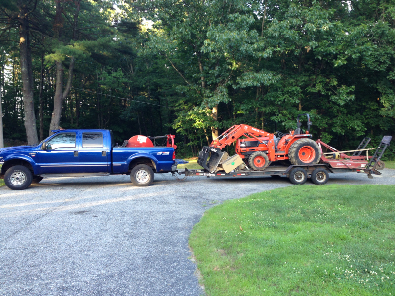

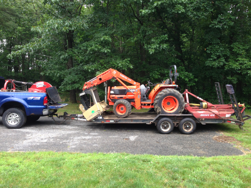

Here is what I currently have:
A '99 F350 SRW and a 10,000lb Hudson 18' bumper pull.
325700d1372847265-your-towing-rigs-trailers-image-671886419.jpg 325699d1372847252-your-towing-rigs-trailers-image-534395912.jpg
As you can see, when I need to bring numerous implements to a job, I have a hard time squeezing it all in. I really wanted to bring my chipper on this job as well but I just couldn't fit it, there was no way.
With the above setup, I'm positive I'm overloaded. All together the tractor, and implements on the trailer weigh in at about 8,500lbs. The trailer is another 2k so that is 10,500 total right there, not including the fact that I have way too much tongue weight on my hitch.
The stumpgrinder in the bed of the truck weighs either 1200lbs or 1400lbs, I forget off the top of my head. My truck weighs somewhere in the neighborhood of 8k, so total combined weight of everything is estimated to be between 19,000 to 19,500lbs.
I think it's safe to say that this load would pull a little better with a gooseneck! Although I have to admit, with heavy duty springs in the back, the truck actually rode decent with all this weight, I was even able to drink a cup of coffee without spilling it while driving, I can't do that too often in this truck! :laughing:
I have some questions about Goosenecks. First of all, I was thinking about a 24' GN. However, my tractor, grapple, and 6' rotary cutter are 22' long, so that only leaves 2' for another implement. I'd like to be able to take along the stumpgrinder and chipper, if possible. Most likely I would not need all these implements at the same time very often, so fitting one of the two would be sufficient. I figure if I had an additional 4' extra space I'd be okay. That brings me to 26'.
Just for safety sake, and the ability to shift weights slightly, I would most likely go with a 28' GN. I like the flat deckover design with slide in ramps. I am interested in something like the PJ classic flatdeck.
The issue is, it seems like no matter how I cut it, I am still limited to around a 10k lb load on the trailer. The trailer weighs just shy of 5,500lbs. It's rated for 15,600. Does that mean that I can only put 10,100lbs on the trailer?

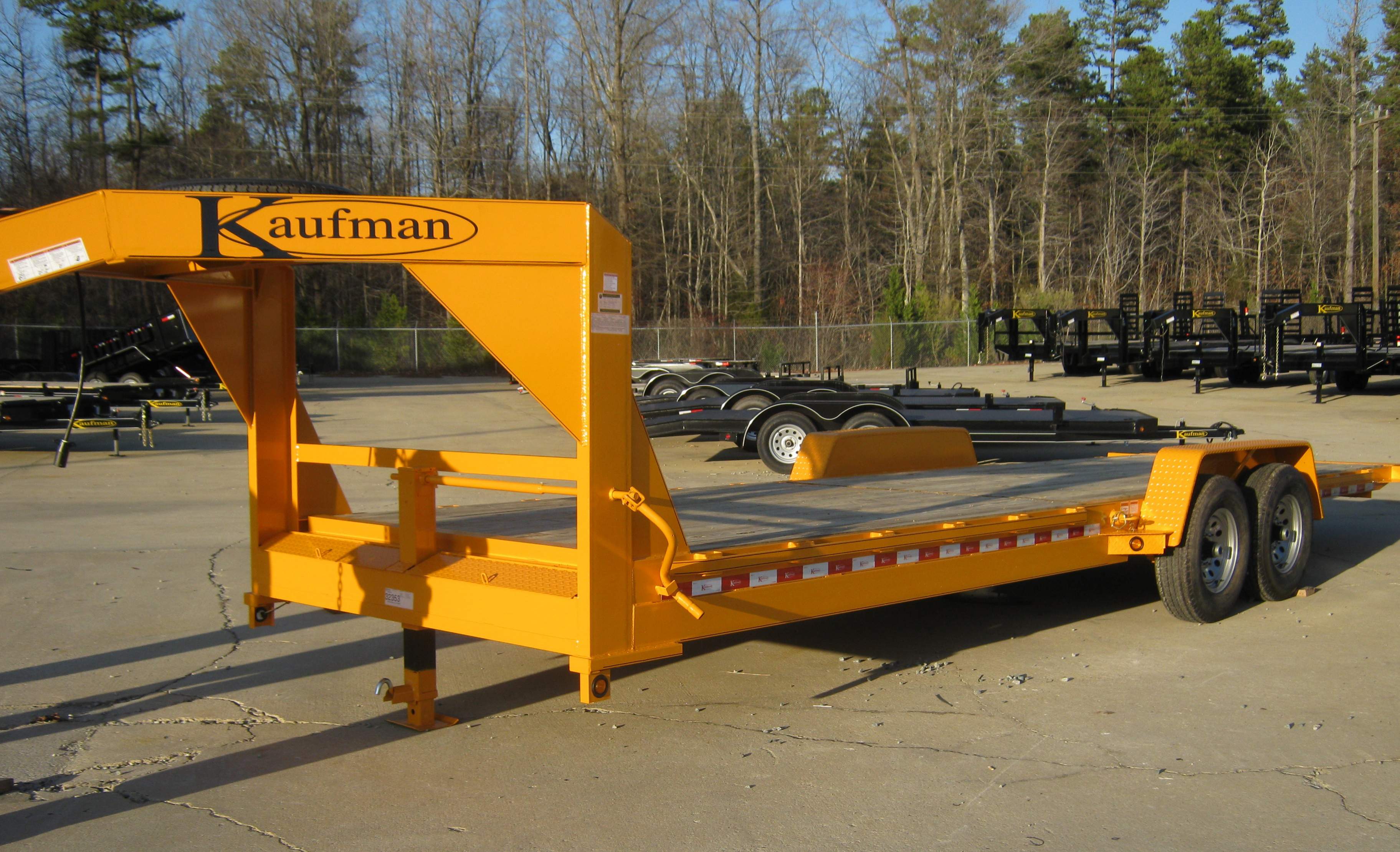

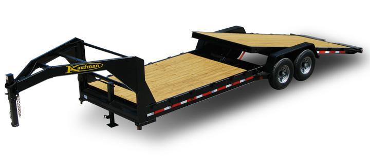

Check this company. Gooseneck Trailers - Kaufman Trailers
I an considering this one. 17,000 GVWR / 24 ft. Equipment Tilt Gooseneck
Can get 26' and 28' also.

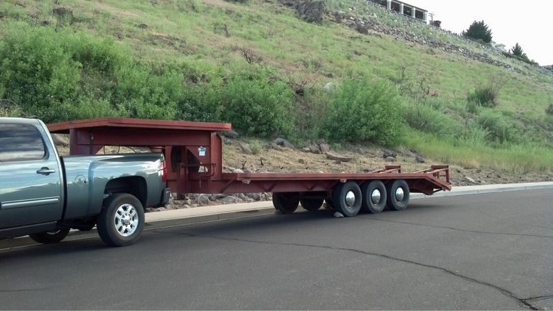

You can do this with a smaller GN trailer than 28 foot. Mine has an upper deck of 8X7. The bed is 20 with 4 foot dovetail. I lift extra implements up to it. Just be careful with your turning radius with a shortbed truck. Too tight a U-turn and the deck can hit the back window. Use of an extended ball helps.

I think you are in the same boat as me. I had a 25' GN and now a 18' BP. I actually can take more with the BP. With the GN the loss of the 8' bed killed me. My GN was 6500# empty and had a GVWR of 25,000# leaving about 18,500# for payload. My BP has has plenty of payload for my needs and my 06 F350 can handle 3,900# in the bed/tongue weight legally.
I think you would need a 30' or better GN with tri 7K axles to come close to your needs.

I have not weighed each axle. I typically load differently on each job I go to, some require a lot of implements and some don't. When I have the RC on the back of the tractor, I end up with a lot more weight forward, when I don't have the RC, I end up with more room forward. So basically, my weight distribution on the trailer changes from job to job.
Thanks for mentioning about how a 12k GN can actually haul 16k without exceeding the limits, that was going to be one of my next questions.
I can not legally tow a second trailer, behind a first, nor would I want to do that.
Chris
Chris,
I think that is the main problem I'm facing, I don't see me gaining a lot of capacity by going to a large GN, weight wise. If I had a 12,000 lb bumper pull, I could load around 9000 lbs on it, plus put an implement in the back of the truck, and probably do it a whole lot cheaper.
I would like a GN for how well they supposedly tow, but if it's going to cost me 6-8 grand, and not give me much more capacity, well I wonder which way I should go. As you can see, I am not decided on what to do, I don't know what would be best for me, short of buying a dually with a huge capacity, which is out of the question.
