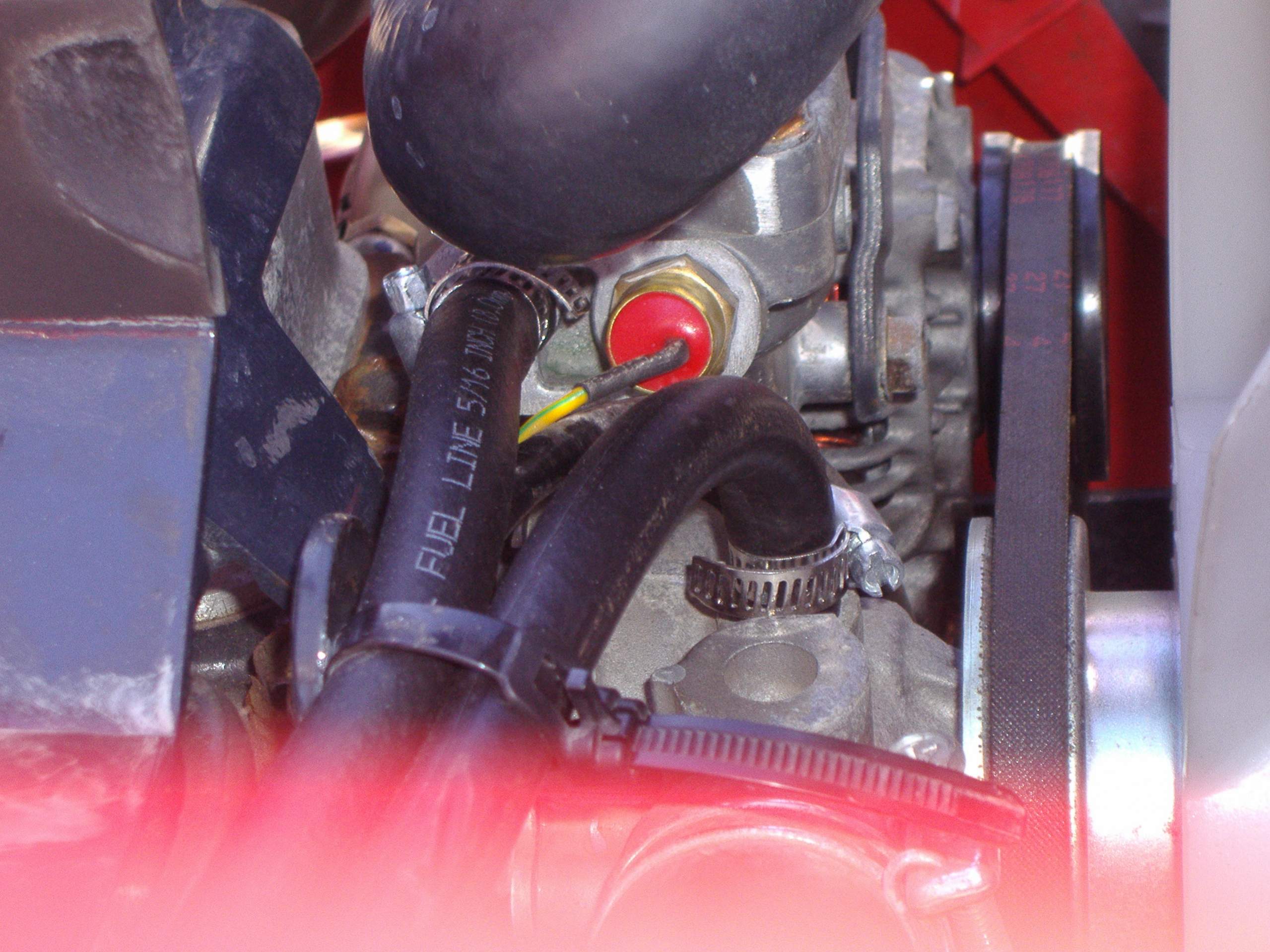

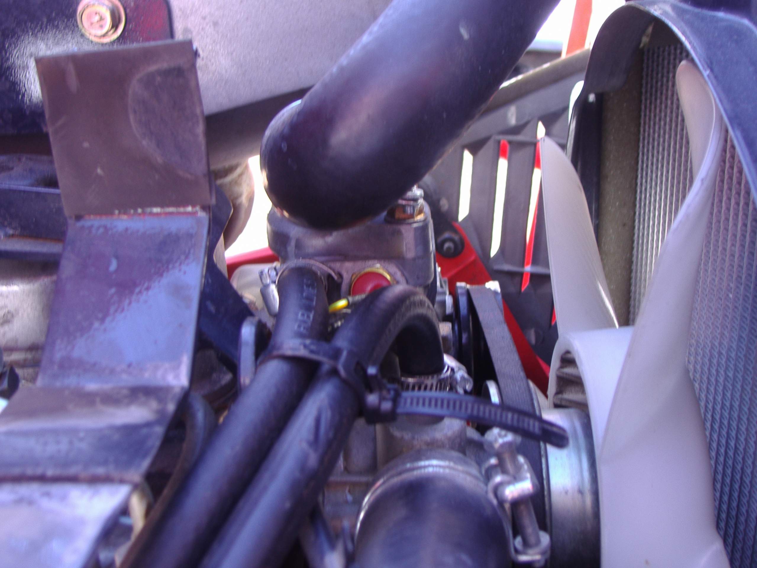

I spent a cold Sunday morning plumbing the heater up. I plumbed in to the water pump/thermostat bypass loop. On the little Iseki engine a 3/8 hose fit loosely, but 5/16 fit perfect. Some brass barb fittings and a couple of brass 1/2" threaded couplers, and I had it adapted up to the 5/8 pipes on the heater.
It was a hurry-up job just to get it working before the storm, and is not in it's final form. I'm going to add a diverter valve and tee so I can shut off the flow to the heater in the Summer, and I have to wire up a SPDT toggle for the two speed fan.
It doesn't throw massive heat, but it certainly keeps the cab warm. I think the 5/16 hose might be too small for massive heat, although, grabbing the brass fittings to check the temp shows it's plenty hot.
My opinion is that the bypass is the best spot to plumb in to for a cab heater. Any and all heat the engine puts into the coolant goes through that bypass until such time as the thermostat opens, and the flow through there stays hot after that. Plumbing into the radiator hoses can delay heat until the thermostat opens, not my idea of fun.

The plumbing is still not done, but here are some pics of the connection to the bypass. I removed the air cleaner for the pictures, when hooking it up I also drained the radiator and pulled the end of the upper radiator hose for better access.

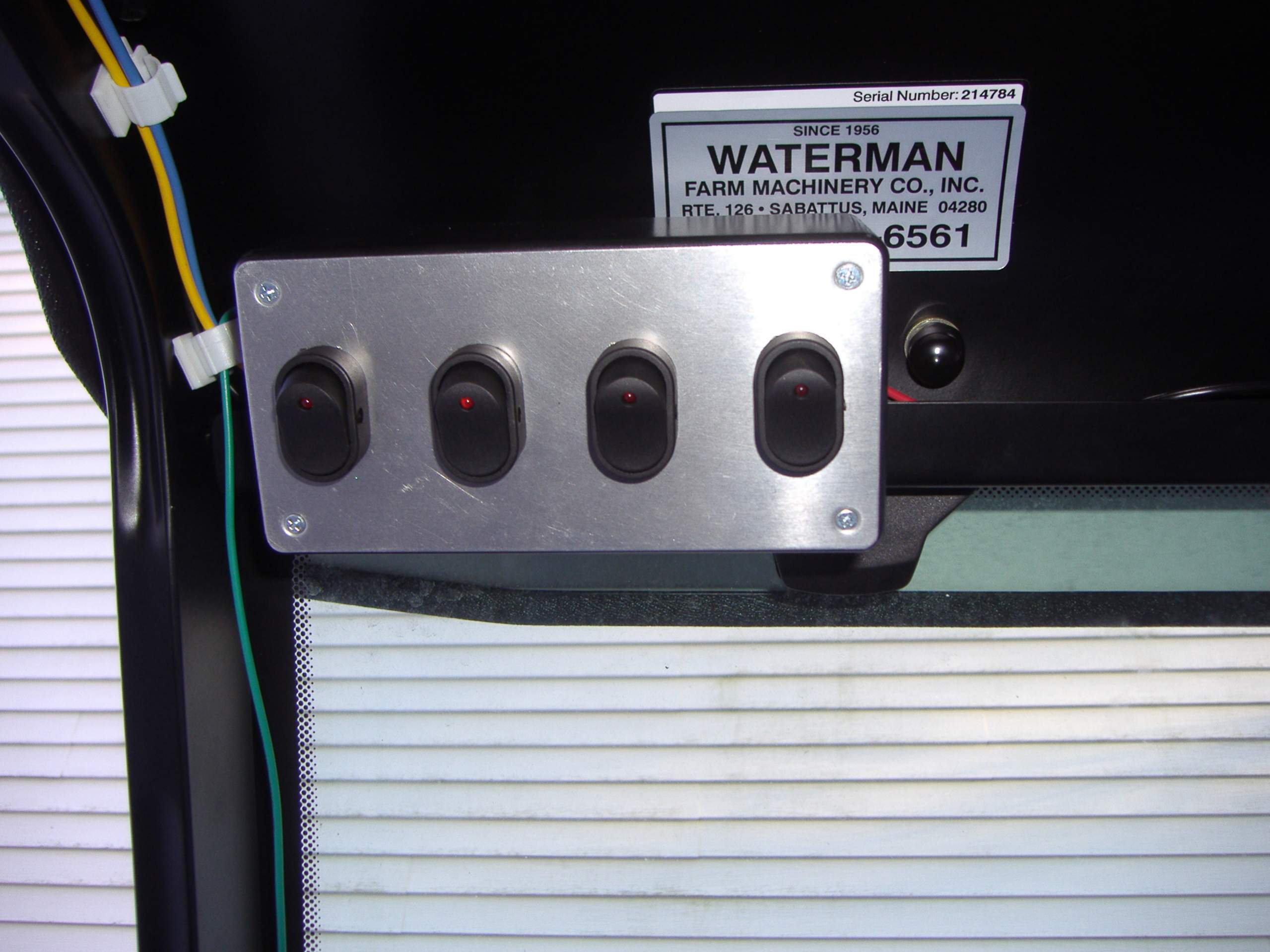

There's also a picture of the switch box I made from off the shelf parts. The box is from Radio Shack, switches from TSC, and the 6 circuit fuse panel (inside box) is a generic Buss product.
So far I like how it came out. Still got to pretty it up some, but it all works!

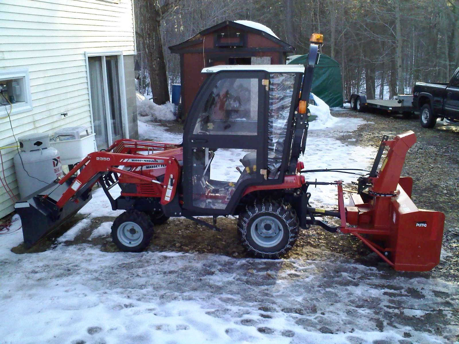

It's a Curtis Cab, couldn't find a source other than the Massey dealership. The dealer in Northwood seems to know about them, we talked about the cab among other things.
The heater is from ebay, much less dinero than the one the dealer was pushing.
Here are some pics. One of the tractor with cab. The other is how I used to have to dress. I can't snowblow in a t-shirt, but a light jacket is much better than the layered Yukon rig I had to wear.
