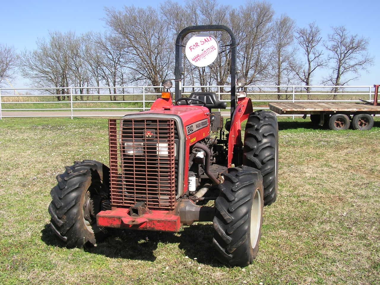

I used to have a MF240D. :D
   / Massey Ferguson MF 35 Utility Tractor Front end Loader
#20
Thank you kindly for the info. I checked out your tractor photos. Nice unit!
