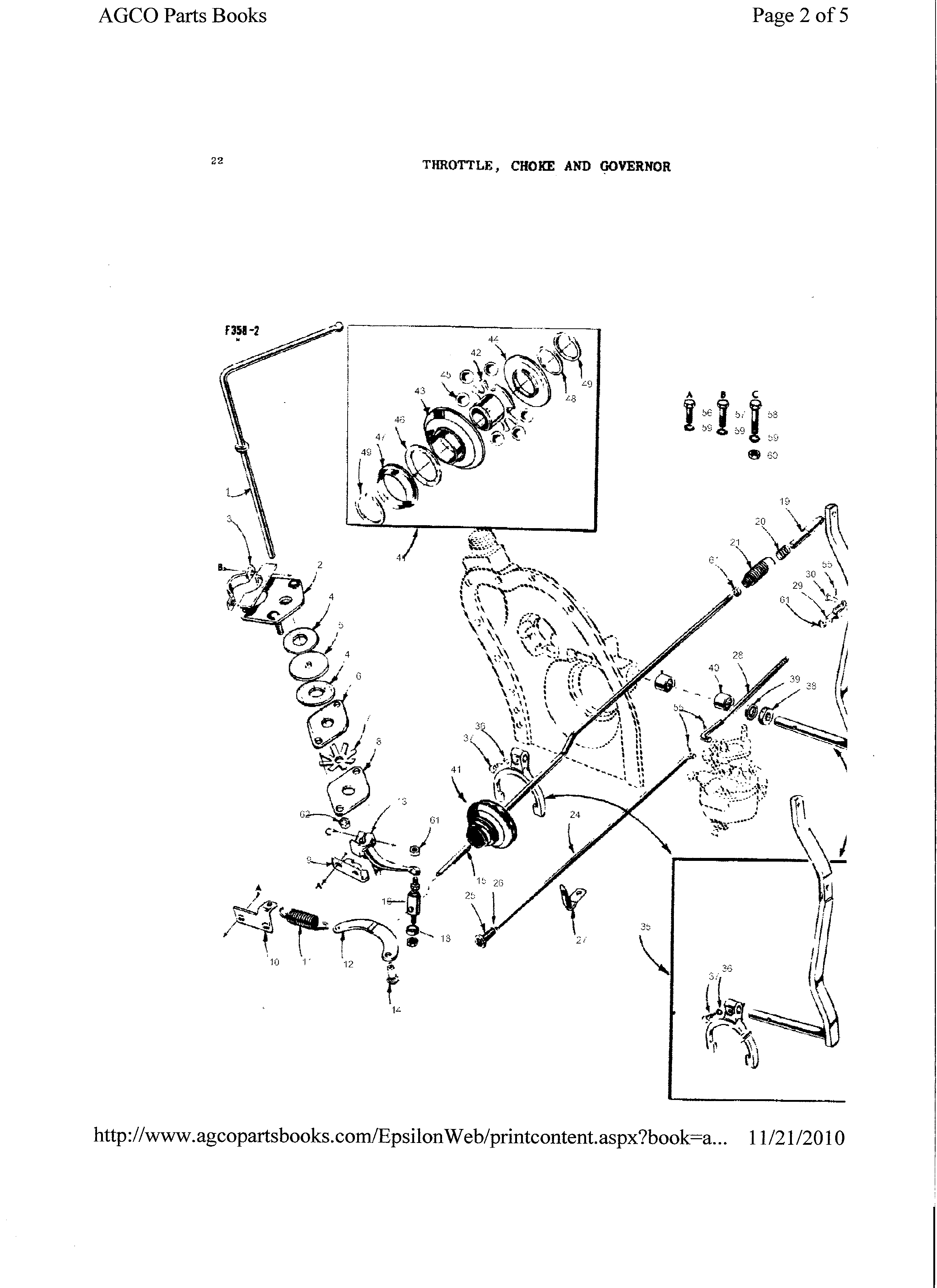

The throttle has always seemed to "automatically adjust". It's like it will run one rpm, and no other. If I pull the throttle lever down to crank up the rpm, it will run faster like it should, but if I let go of the throttle lever, the lever will automatically move back to idle...
I've been dealing with this for years but if there's a fix for this it would sure make shifting, steering and operating hydraulics levers all with one arm while the other one is holding the throttle a lot easier... sheesh!

/ Massey-Ferguson 65 #8
MY 65 does the same thing with the throttle. It will not stay wide open. I just got used to using my hands. You can get the screen and gasket for the bowel at farm and fleet. Also there is a fuel reserve on these tractors that I beleive casues issues. I would ahve to go outside and look at mine But you crank it partly back or all the way open for a reserve of fuel I think the valve closes in the wrong postion When you closed it to remove the sediment bowel the valve clears it self.

That throttle thing seems really strange.. put a pto on a tractor that you can't set the RPM at a constant speed??? weird...

most tractor hand thorttles have some sort of friction disc / spring tension setup to keep the hand throttle where you put it.
follow your throttle linkange and see what you got.. I know my fords got them.. I suspect the MF'er does too ;)

Assuming you have an agricultural model 65, here is a exploded view of your throttle linkage. As Soundguy said, there is/are friction disc's. The 65 has 2,
(#4's in the exploded view) where as on like my Ford 2000, there is only one.
I just replaced mine week before last. A 15 minute job, including sipping on a cup of coffee... You can snug the nut on the bottom to your likeness, for tension.
Here is the part number & description copied and pasted directly from the AGCOPARTSBOOK...
184507M1 2 Disc, Friction (9/16 x 1-7/8 x 1/8" Cork)
I made one about 5 years ago for my Ford out of heavy gasket material. It worked until this year. Decided from looking online at aftermarket ones, it was worth maybe getting an original so as to last longer... Aftermarket one's were like $3.50 each, so the OEM shouldn't be more than a couple bucks more. WRONG..!! Almost $14.00... Either I got hooked, or they are just pretty darn proud of their parts.
I couldn't find aftermarket disc's for the 65, doing a quick search. Just giving fair warning for sticker shock, if you get them through a M-F dealer, although they may be less expensive.
Hope this helps..!!

I've made them from leather and rubberized cork before..
