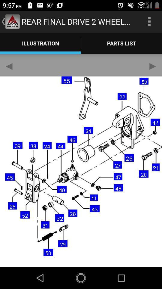

I bought this tractor last year and discovered it has a brake issue. So it’s a 4x4 with cab and front loader. The issue is the right brake seems to grab a bit (not always) and the pedal is hard with very little movement. I can tell when this happens as the brake is engaged some holding back the tractor a bit. Then there are times the pedal feels normal and right brake works fine. Anyone have thoughts as to what could be causing the issue? Rear hydraulic fluid is at normal level as well. I did notice some oil residue though around the right hub. May have a small leak but not sure if that would cause this issue.
Any ideas?
Thank you.

Adjust out on the brake rod going into the rear axle. Does it return to normal when you put in reverse and go forward again?

I think the adjustment is fine as normally when the brake feel is good so is travel. However when it sticks it’s a hard pedal with very little movement. Also to you point, one time I went into reverse it fixed itself. May have to try that again. Good point.

Maybe back off 1 full turn. The brake expander should slide back into place.

It uses an eccentric expanding plate. They're immersed in oil, but not hydraulic.

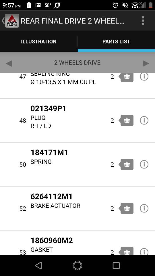

Maybe check if the spring is still in place too. Number 50 on the diagram. Screenshot_20200127-215721.jpgScreenshot_20200127-215737.jpg
