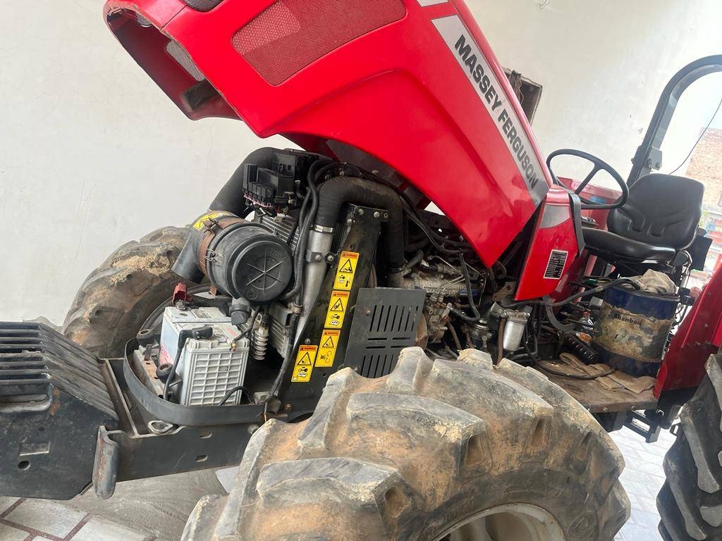

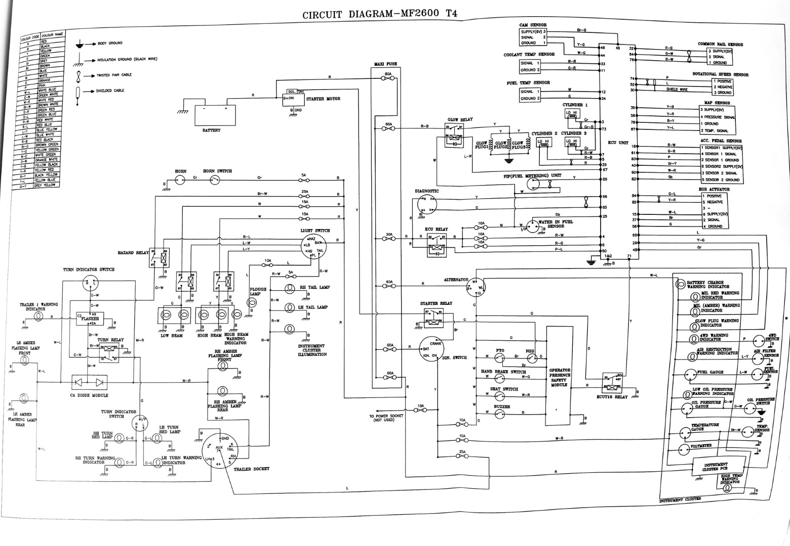

Hello, I have massey 2607 it's engine doesn't works properly ecu fuse blow after some time check engine light on operator mannual is not available in my country so please share wiring diagram and ecu pin diagram
/ Massey 2607 engine problem #12
Here is the full circuit schematic for the MF 2600H series tractors.
