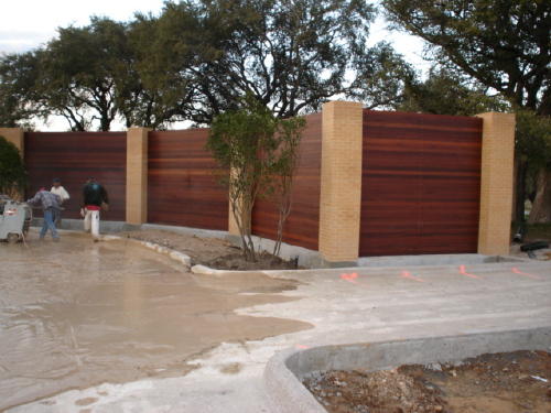

Well Don the job is done. There's some paperwork left, but I trust them. /forums/images/graemlins/smile.gif
Here's a shot of the trim I came up with. It's really very simple, and I'd like to think, effective.

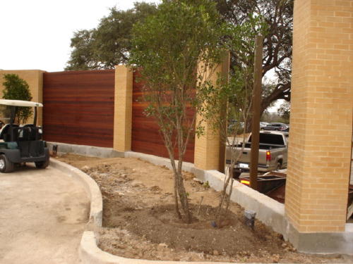

It's amazing what a little landscaping can do to make the fence look good.

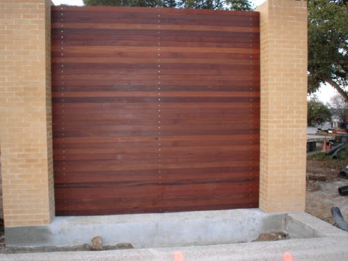

Did I mention there was some gates?

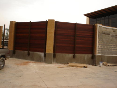

The concept was galvanized framework and wood filler.

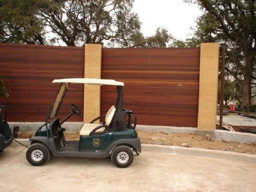

There were a total of five gates, two of them galvanized square material with wood filler.
