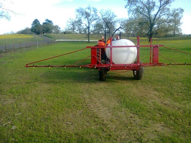

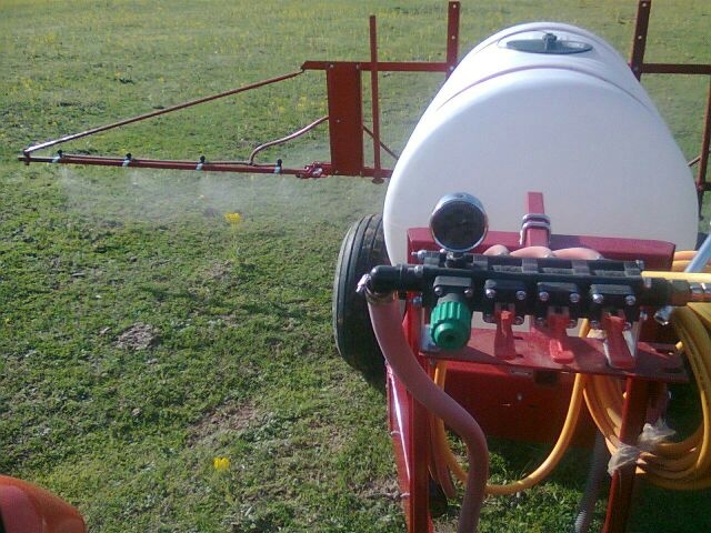

I got a 300gallon with 21 ft boom,has worked great.
   / Many scenarios to start haying -- will this one work?
#17
   / Many scenarios to start haying -- will this one work? #18
I asked about your rig in your other post about going "green". Do you mind sharing other details about it -- where did you get it? Would you buy there again? Price? I think I need something a little larger for my place but price seems to go up more.
Thanks.
Yes,I really like Normangee Tractor kenneth,my salesman really good guy to deal with. I believe it was in the 3,600 range,has the up-graded pump but I would have to pull the reciept and check it for sure. Depending on how rough it is,21ft running 5mph can make up some ground.
