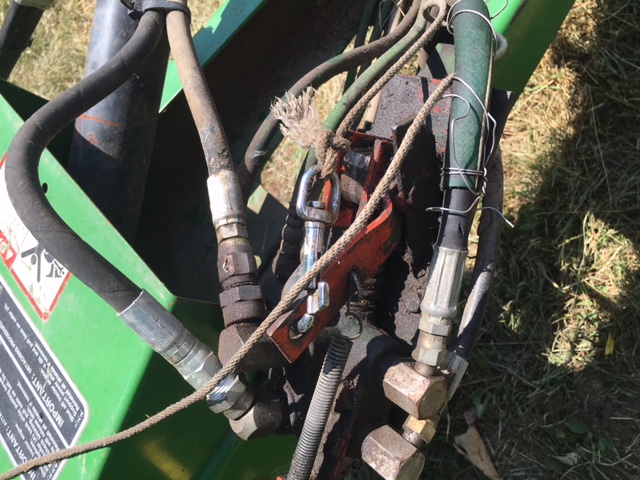

Wondering if any of you can steer me to who makes these. I was looking at a John Deere baler today at an auction and the baler had 4 hoses running into a multiplier or divider mounted on the baler tongue with a pull rope which would run to the tractor seat. I suppose it was some sort of ratchet or spring operated valve. The baler had 2 hoses for the gate and two hoses for the tie but the setup allowed for use of just 2 remotes on the tractor without using a divider with electric solenoids.
I didn't look at it close enough to get a brand name as I thought I'd google search around to find one but so far no luck. Any ideas who makes or sells something like this? I did take a pic I can post but its not as clear as I thought it was.

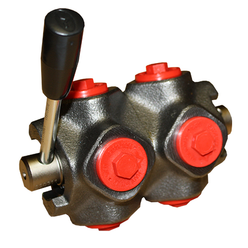

Thanks! Been searching high and low online but all I can come up with is the manual type that has a 90 lever like this Manual Hydraulic Multiplier, SCV Splitter / Diverter Valve Kit with Couplers, NPT
Most are going to solenoid types for use with cabs but in my case I'd rather have a simple mechanical device. Here is a crude picture of one mounted on the JD baler
I may stop by the JD dealer to see if they have outlets for these.

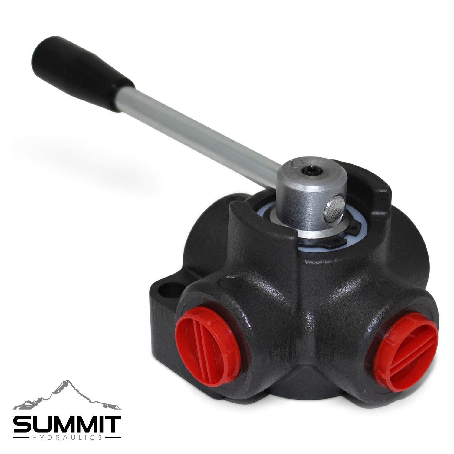

You are looking for something like this, right?
It should be way cheaper if you go to an hydraulic shop rather than JD. They might try to sell you another overpriced remote kit or some sort of diverter valve.
Could probably make that work but would need a return spring attached to the handle if a rope was used to temporarily switch functions to the baler. Probably would need to drill a hole thru the end of the handle with a pin or bolt to attach the rope and spring. There could be an issue, however, with the handle being hard to move if the valve is under pressure.
