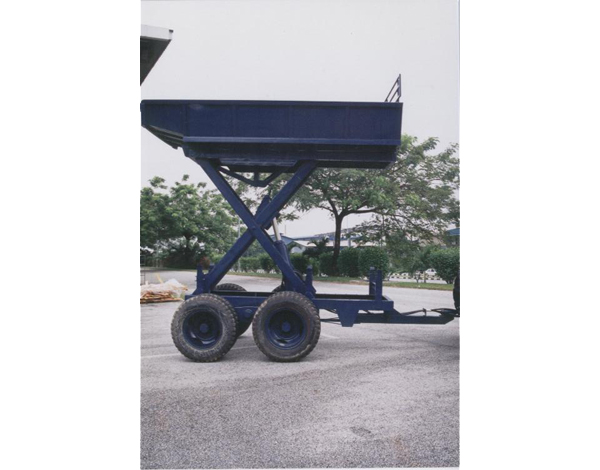

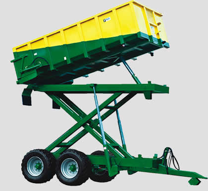

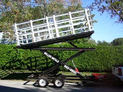

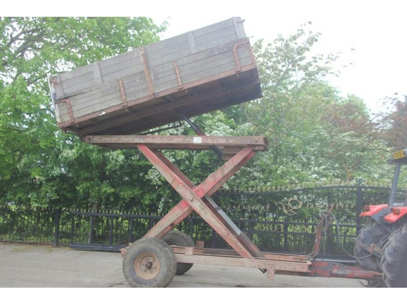

I saw a homemade lift that had a hay wagon running gear as a base and a 7 x 12 platform. It had an electronic motor hooked to a battery. The frame just unfolded and went up about 15'. I know this is not what you are looking for but they someone might be interested.
   / Man Lift ideas #22
Interesting idea.
ScissorLiftTilt.jpg ScissorLiftTilt2.jpg ScissorLiftTrailer.jpg scissors lift trailer.jpeg

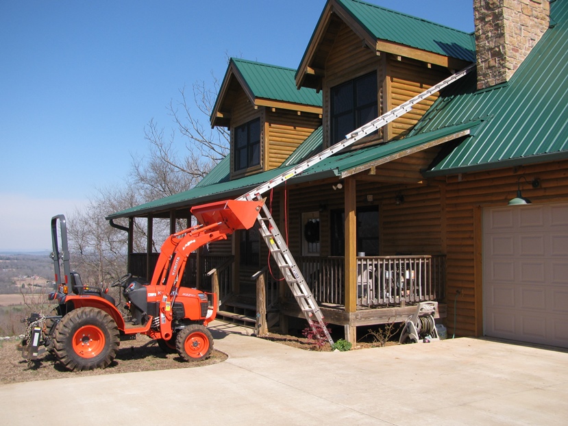

I had to get up on the roof to check a suspected leak around the chimney. I wrapped some towels around the ends of my 32' ext ladder and lifted it up to the roof. I put it in the end loader and slowly moved forward as it slid up to where I needed it. I was able to get to all sides of the chimney that way. It was very sturdy and worked great.

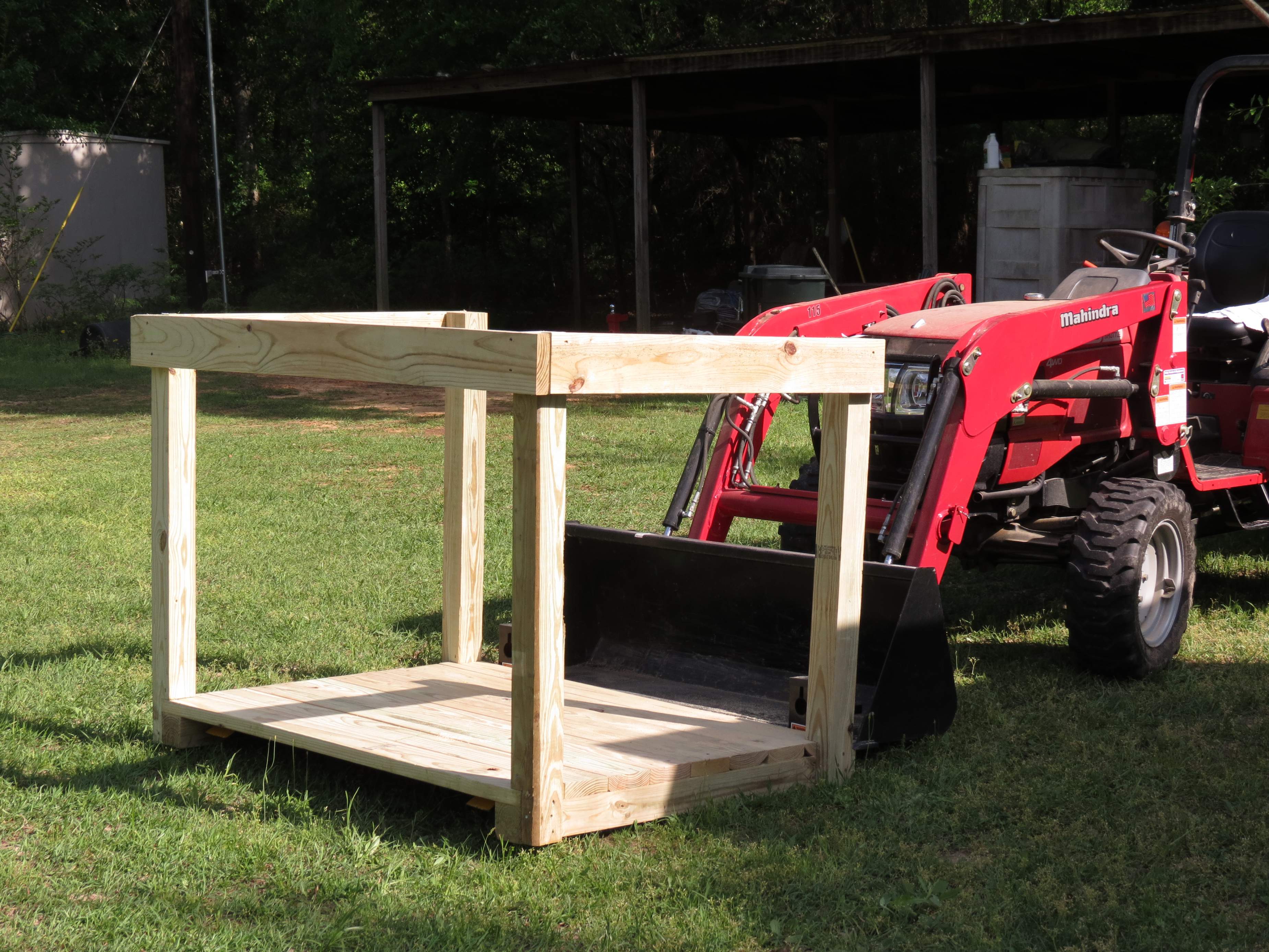

IMG_2198.jpgI built one a couple of days ago for my Titan bolt-on pallet forks. I used two 4 foot 4x4s that fit just outside the forks and made the deck out of five foot 2x6s. I made a rail for three sides out of 4 foot 4x4s for the posts and 2x6s for the rails. By leaving one side open I can reverse it and use it for hauling large items. Today I installed a security light for my sister-in-law and spent quite a lot of time on my platform. It worked exactly as I'd hoped. I read that positioning platforms is difficult but if you get it to the height you want and get it level you just have to slowly move the tractor into the correct position. Of course I have to use a ladder to gain access to the platform but once I'm on it I feel very secure and I can lift all the tools I need at one time.View attachment 421161
