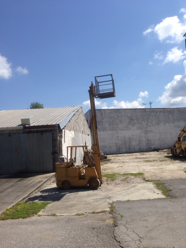

Here's one I have. I didn't build it, but it is a homemade attachment. Since the forklift lifts higher then a tractor there's no need to strap a step ladder in it. image-4215036269.jpg

Here's one I have. I didn't build it, but it is a homemade attachment. Since the forklift lifts higher then a tractor there's no need to strap a step ladder in it. View attachment 478738

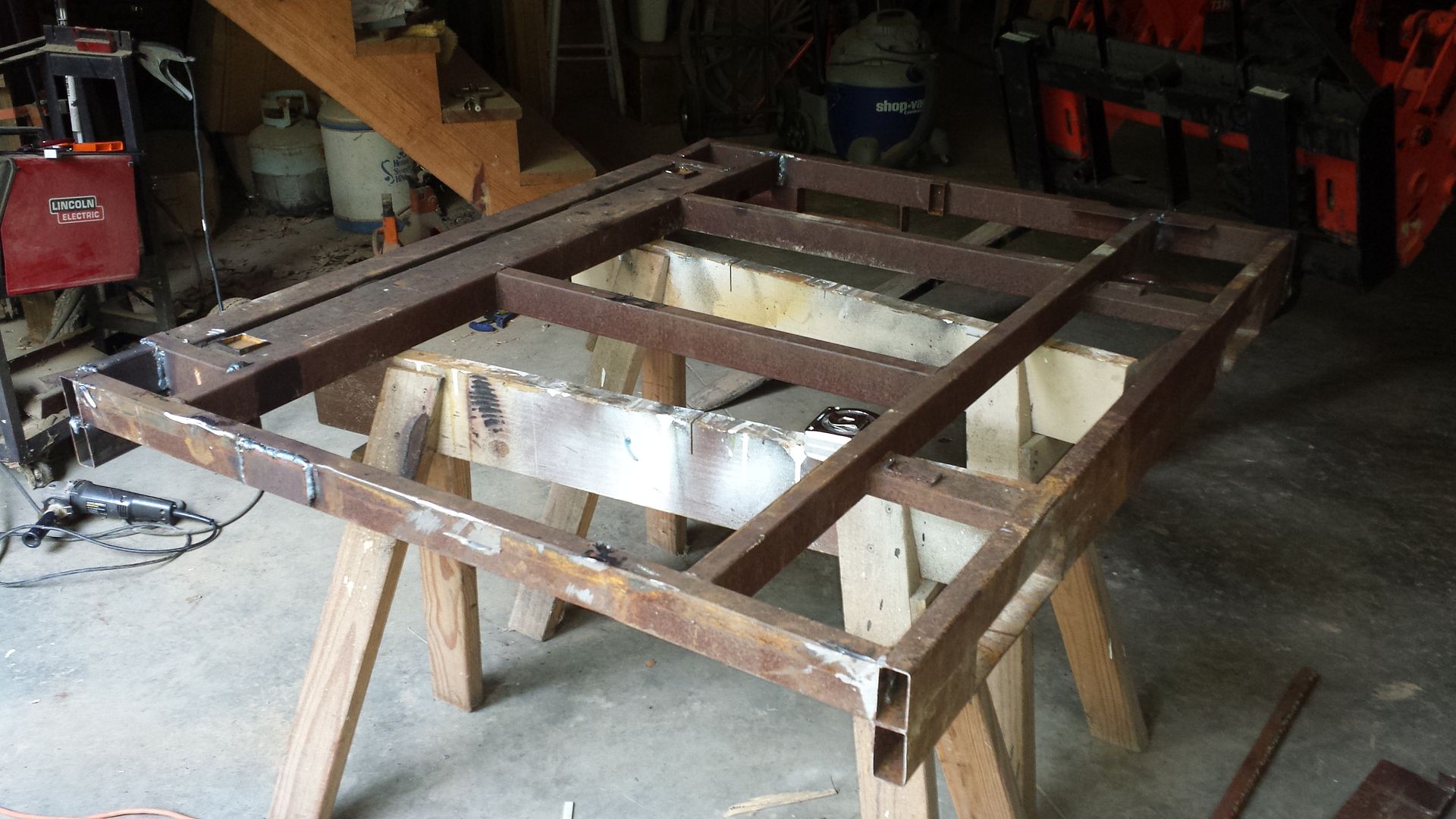

Pretty much what I've got going on. I've scab the floor together, but going to have to buy some steel pipe for the post to build it up, and probably expanded metal to cover the floor.

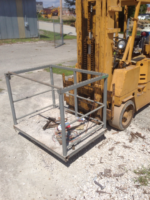

Well....my man lift project has taken a turn.
I have one more brace to put in before putting on expanded metal floor...then building the rails.....but it stops now to reevaluate things.
Today I came across this...and for $25, I figured I could make it work. It's just slightly smaller footprint, but not much and is very heavy built. I'll now do some head scratching to see what adjustments/mods I'll do it to. If anyone has some ideas on how/what to mod, chime in. Does anyone know the original purpose of this heavy metal basket?
   / Man lift for fel #79
Thats a stackable parts bin used in an assembly plant (for exa,ple). Parts suppliers fill them with tail lights, or radios, or alternators or other stuff and they get moved to the line as needed. Very heavy. The weight of this would subtract from the weight of stuff you want to lift up 25' with your loader.
   / Man lift for fel #80
My place of work used them for dipping painted materials into a caustic tank to strip the layers of built up paint off. Mostly chains and hooks from the paint line.
