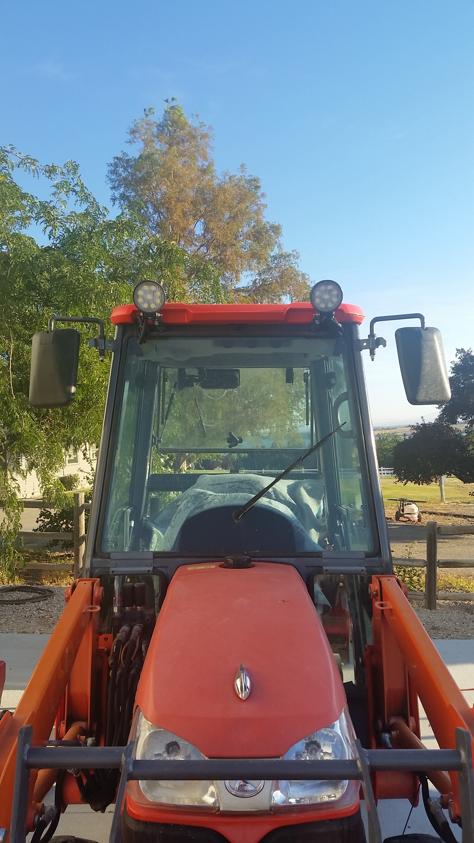

Added front and rear 27 w LED work lights. 2600 lumens from each really brightens up the work area now.
Also added cab level caution/turn signal lights to increase my visibilty to other vehicles when I'm on the road.

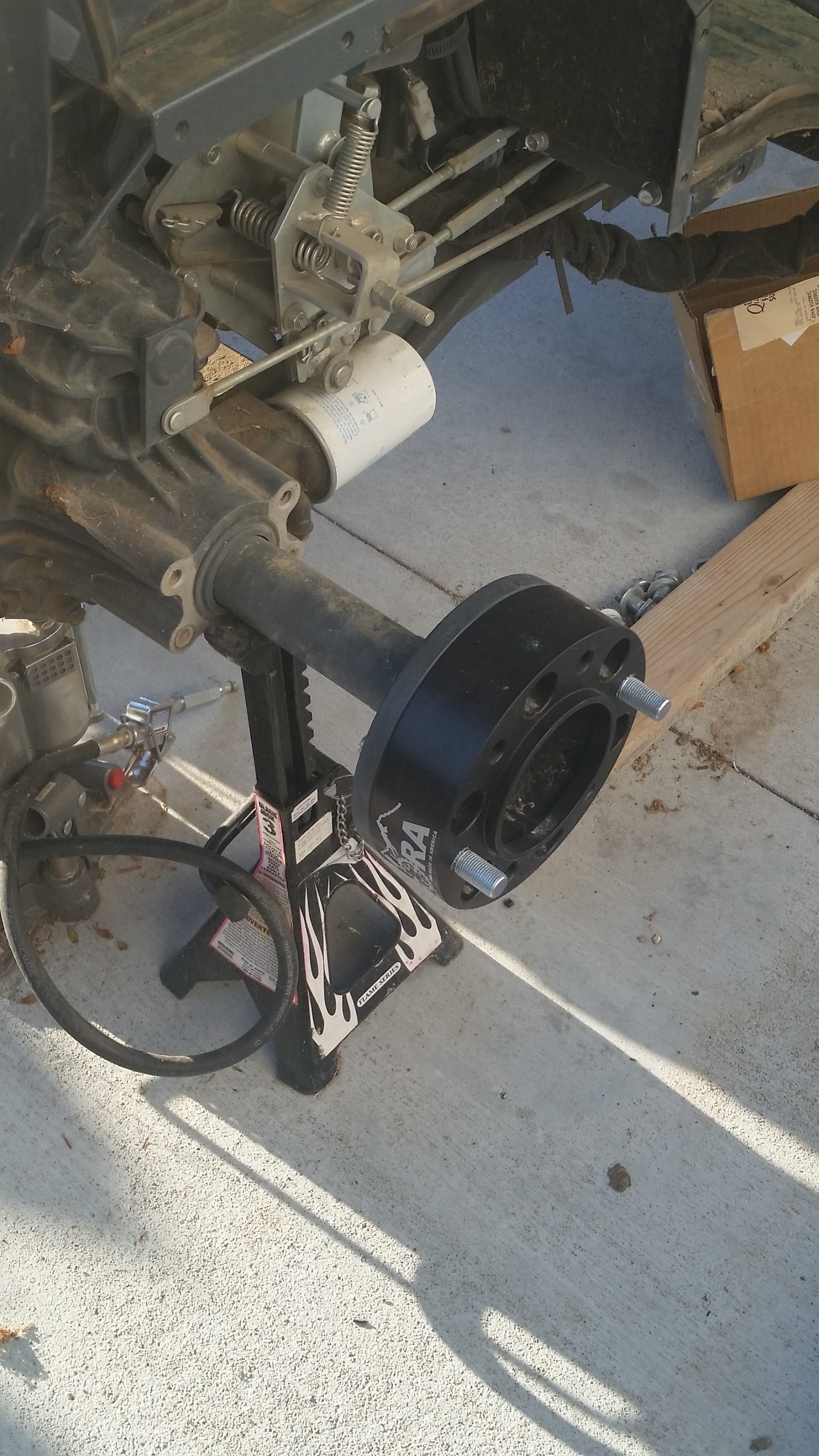

Had some rust spots on the fenders so I removed them to repaint. While off it was a good time to add 2" wheel spacers.

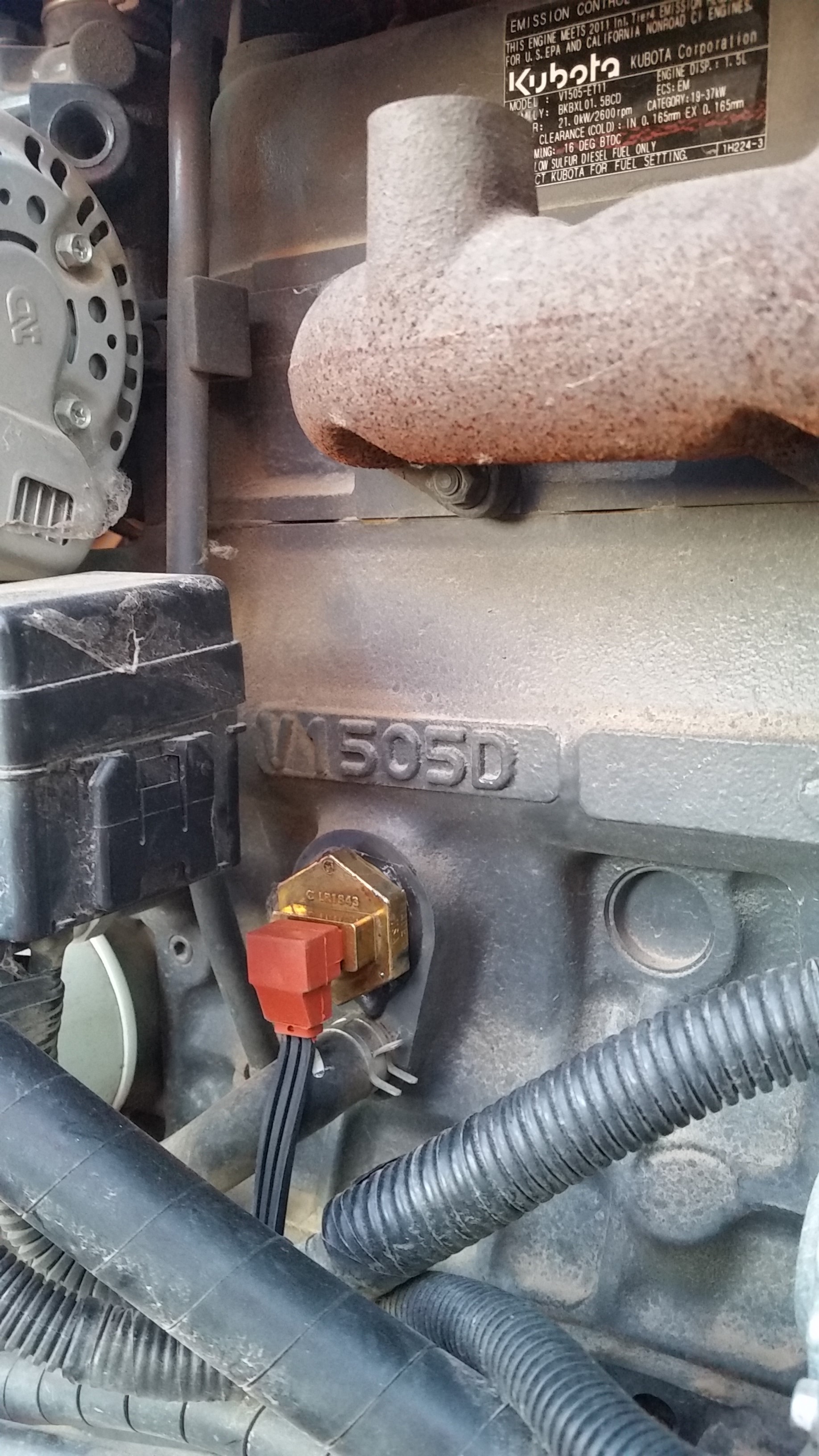

Added a block heater for the cold Idaho winters. Pretty straight forward but had to buy a 1-3/8" socket to install the heater in the block.
