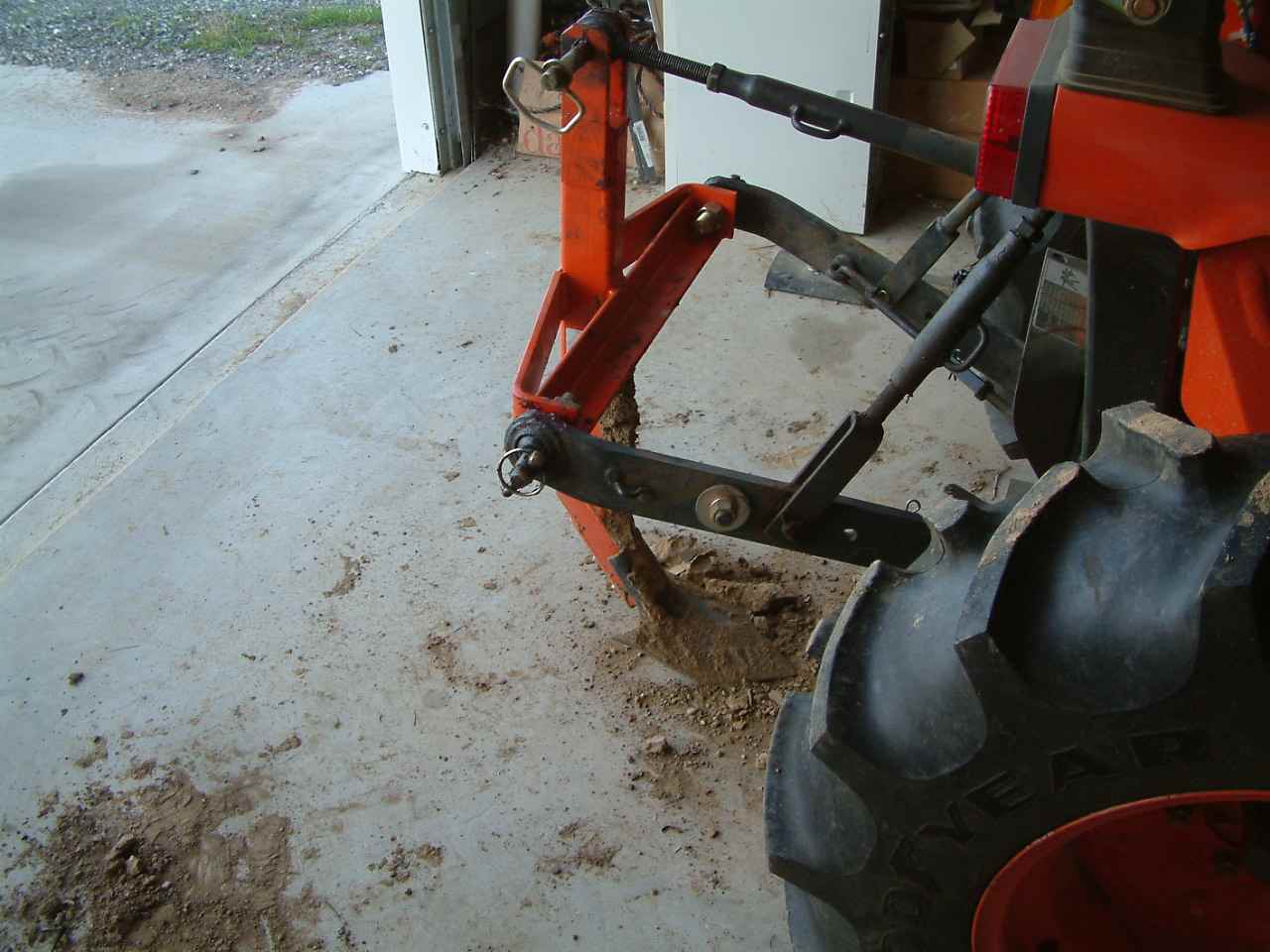

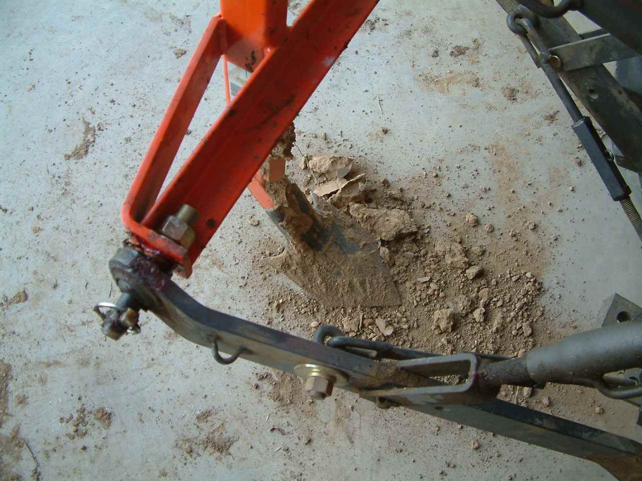

BTDT said:
What is the purpose of needing to go deeper than 8"? Any pics?
Here are a few photos of the 6"-wide chisel plow sweep that I attached to my KK middle buster/subsoiler frame. Fortunately the two holes in the sweep align OK with the holes in the subsoiler frame.
You can see from the dirt on the vertical support that the sweep pulled the frame down almost to the horizontal support that carries the pins for the 3pt lower arms.
For sprinkler pipes, 6-8" depth is enough.
I also use the sweep to dig trenches for water lines from the well to several sheds that I've built recently. I like to get these lines 12" deep.
