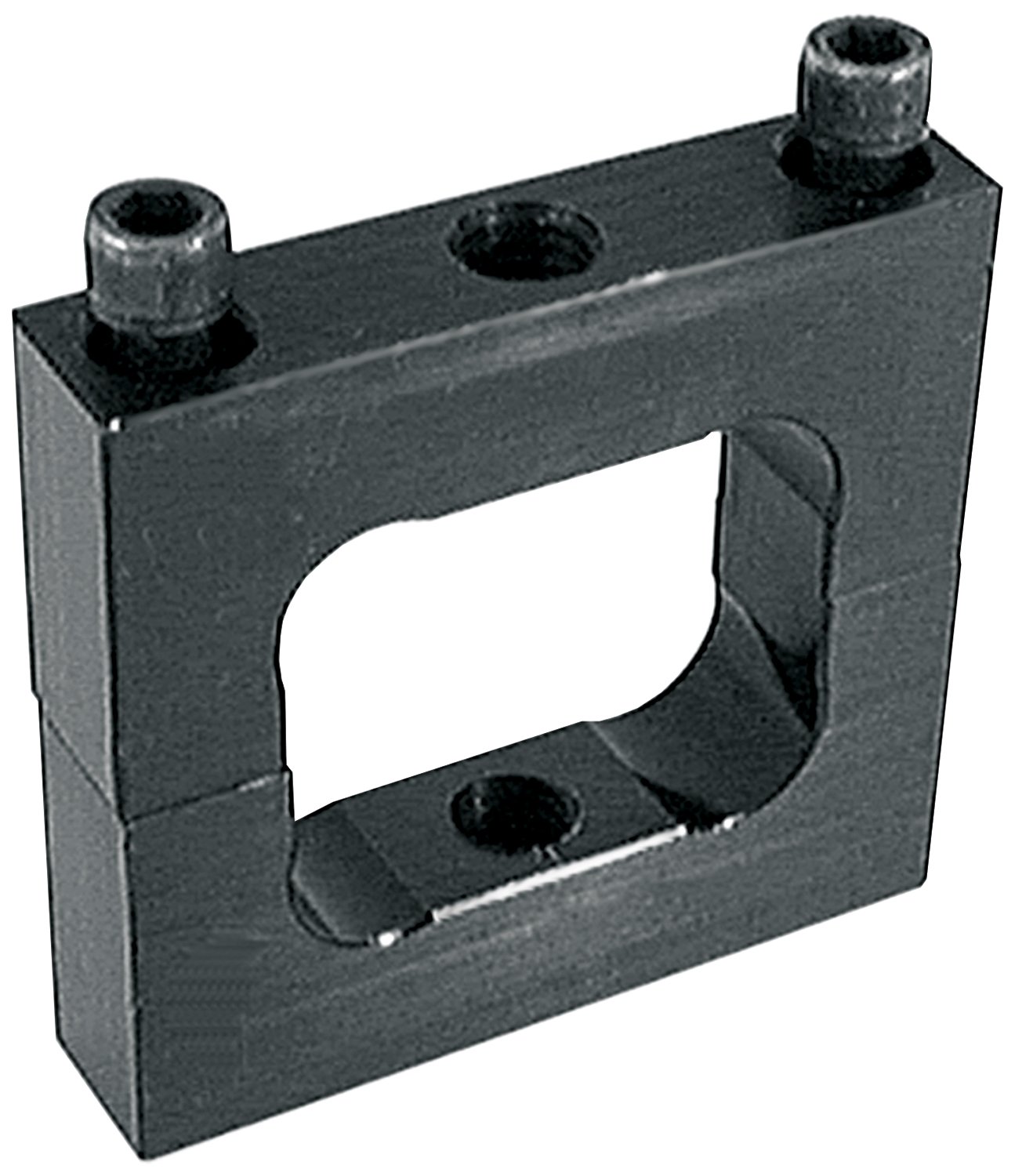

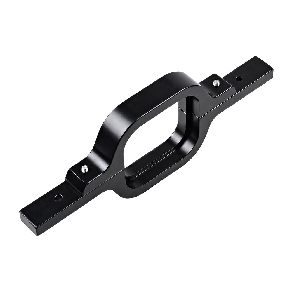

I thought about ordering a set of these for my John Deere 2025R: (scroll down to the Billy Worx light bracket)
Case IH / New Holland / Woods / Automotive Supplies / Messicks old stock: STRAP, CABLE, Part # 358
There are several other nice pre-made brackets out there, depending on the style of your ROPS or other attachment point. There are a couple slick brackets for square tubes for 1 or two devices. There are also many things for round tubes if you look in off-road light categories.
http://a.co/is3zE0d
http://a.co/bUgFWlD
I thought about them, but for $20 each I figured I could just get the $4 flat bar stock and make my own.

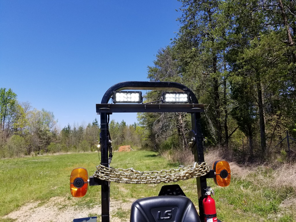

Here are a couple pictures of them mounted. I don't yet have the wiring harness tied off because I need bigger zip ties, but otherwise it is done. And showing the light output...
