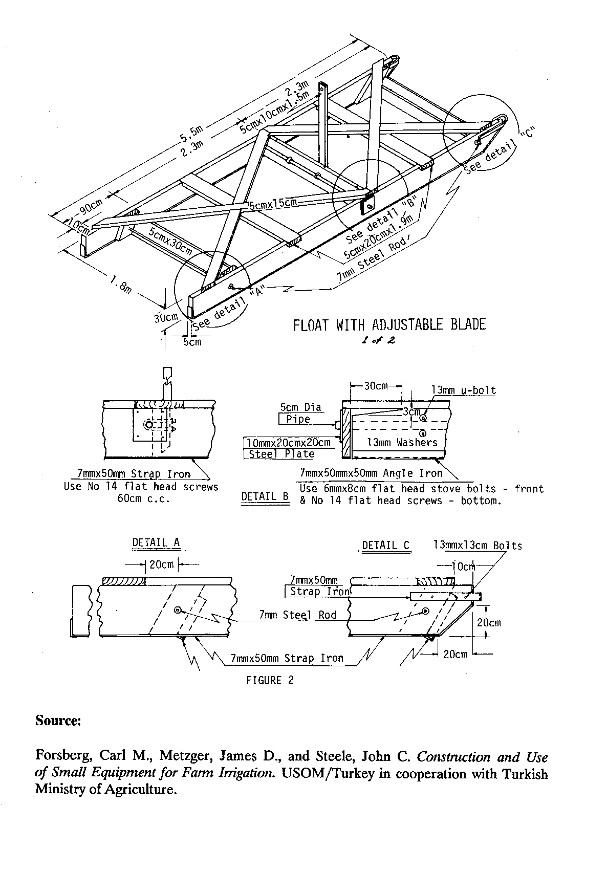

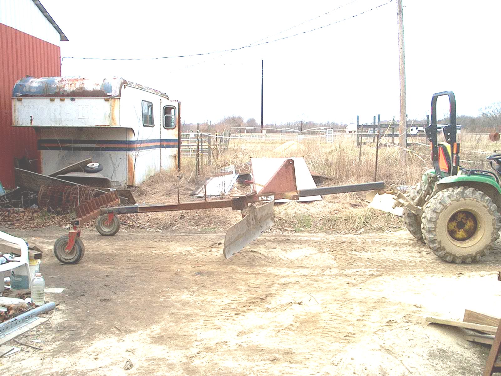

You need it not only smooth, but flat, for higher speeds. That usually means something long.
Here are two ideas I've collect, probably from TBN.
Extend your rear blade:
Build a float:
Bruce
