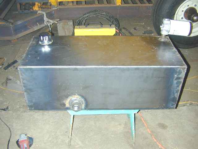

Well guys I finally got that tank welded up. I am running out of time on my project so while I was at the sheet metal shop picking up some other stuff I had them break some 10ga. I then welded the two haves together. I used my plasma cutter to cut the holes for the weldable tank flanges. I had the welder set on high power to assure a good liquid tight seal and almost ruined one flange but it was OK. One other thing, the sheet metal didn’t fit together on the ends perfect so I had to use some tig welding rod to fill the gap. I just laid it in the crack and it worked perfect. The picture shows it unpainted. I will prime and paint it within a couple of days. The rest of the project is coming together and I will be posting that hopefully later in the week. Cost of the tank was about $100. Most of that was the new metal I bought. I didn’t have time to clean my scrap up. The rest was the filter, breather cap, and strainer that I got from Northern tool. Thanks for all the advice.

Looks like a professional job to me. Looks good, I would buy it.

i assume that's your return line with the filter on it. i hope it goes almost to the bottom of the tank?? if not you'll get air in your fluid, that might cause cavitation /forums/images/graemlins/ooo.gif

But I think I was always told a baffle was a good idea between the outlet and return lines.
