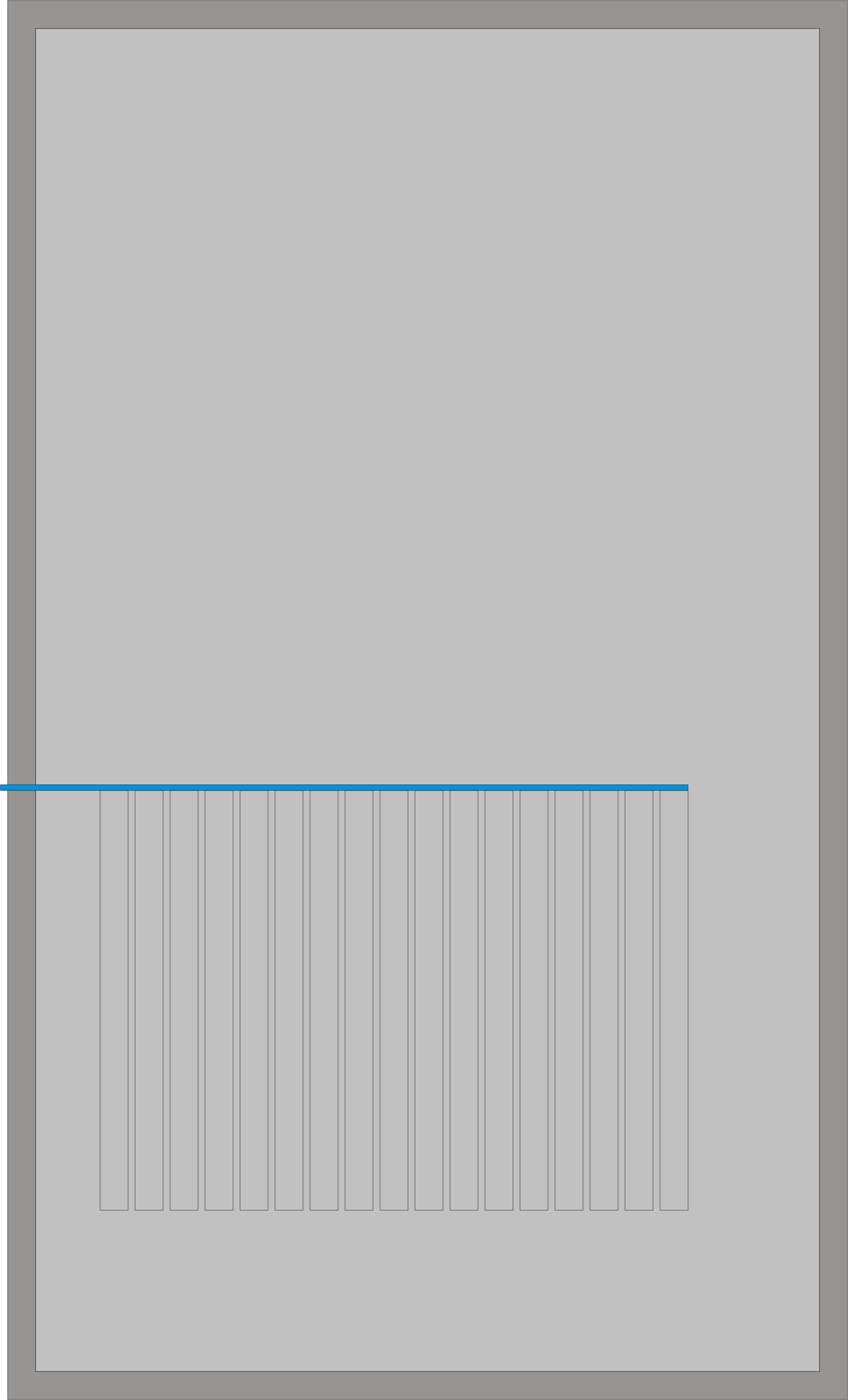

How about a shallow grid with a side drain grove. Place it under where you park the tractor. You can buy a diamond 4.5" grinder wheel at HD or one for a skill saw. 1/4" groves 1/4" deep. Here in Maine your not suppose to install floor drains in a garage due to the possibilities of oils and such finding there way into the drain. Heres a sketch of my thoughts.
Good luck
Phil
