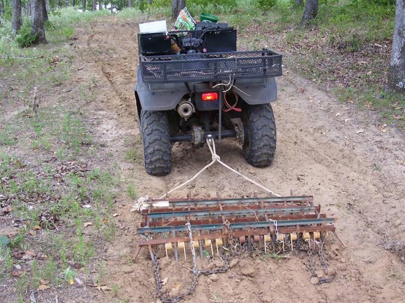

I just posted this in another thread. 6" 1/2" solid bar spikes welded to some T post. Some baler rakes and chains welded to the end. It picks up a lot of crap and I have to stop and dump it every now and then. Somebody posted one like this on a 3pt to pick it up to clean it. Nice thing about this is I can carry it on the ATV and drag it with my atv. Also since the spikes are staggered, it does a great job of filling in the V in the dirt a disk leaves in one pass. I might redo the frame this winter but for now it works great.

I'll seconed what VistanTN says about using a drag in conjunction with a boom pole set up just as he says. I works wonders and gives you much more control as well as ease of transporting.
