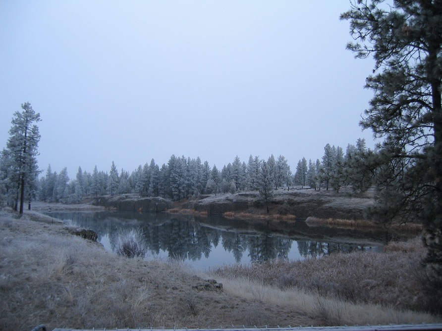

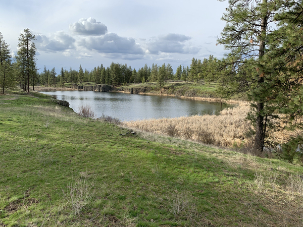

Just put the culvert in the dirt. Drive over it and pack the dirt. My pond is the same with a creek. Five acres.

I get a at least a pair of each ever year plus the mink and otters but I does provide evening or early morning entertainment.
