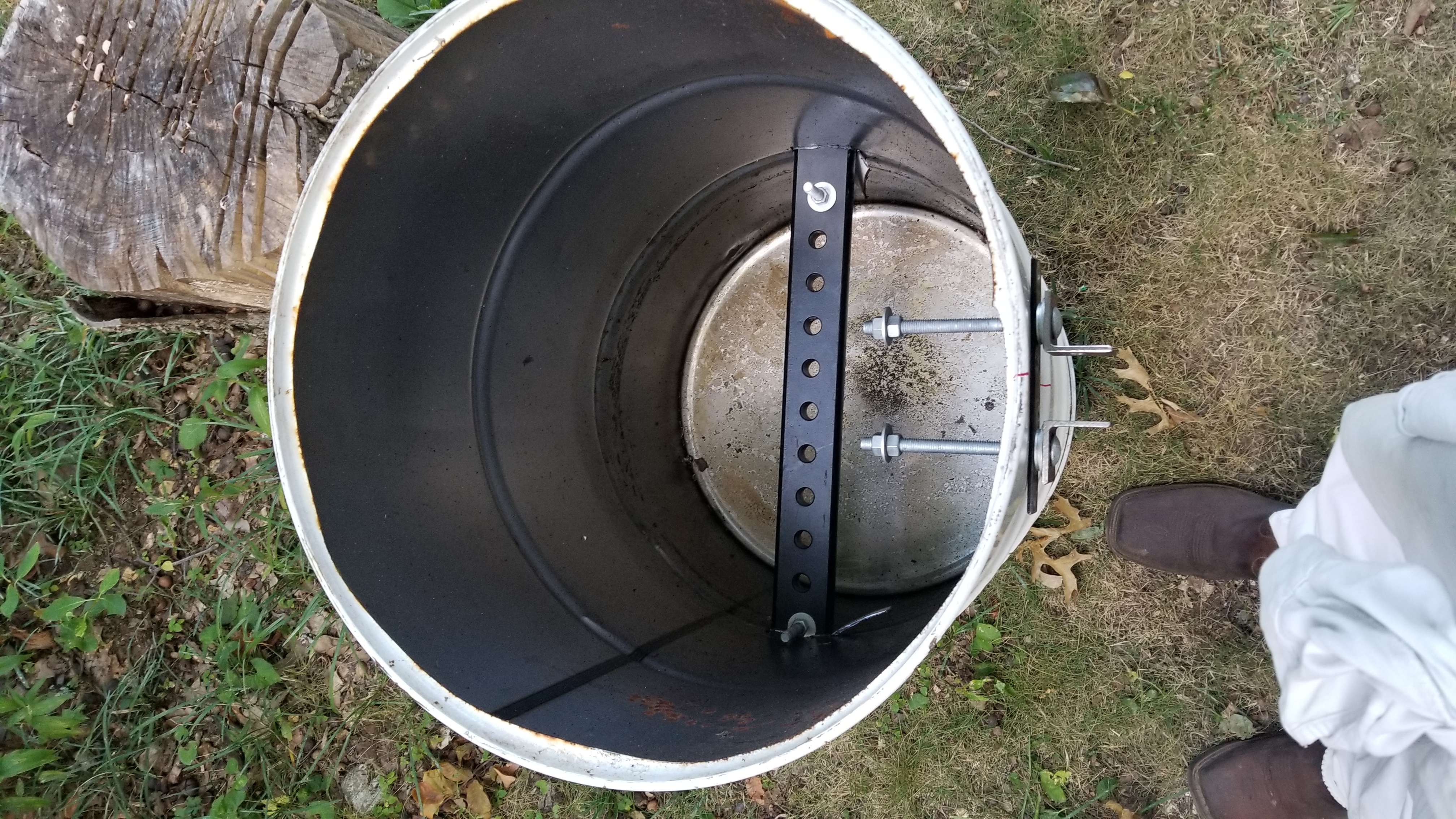

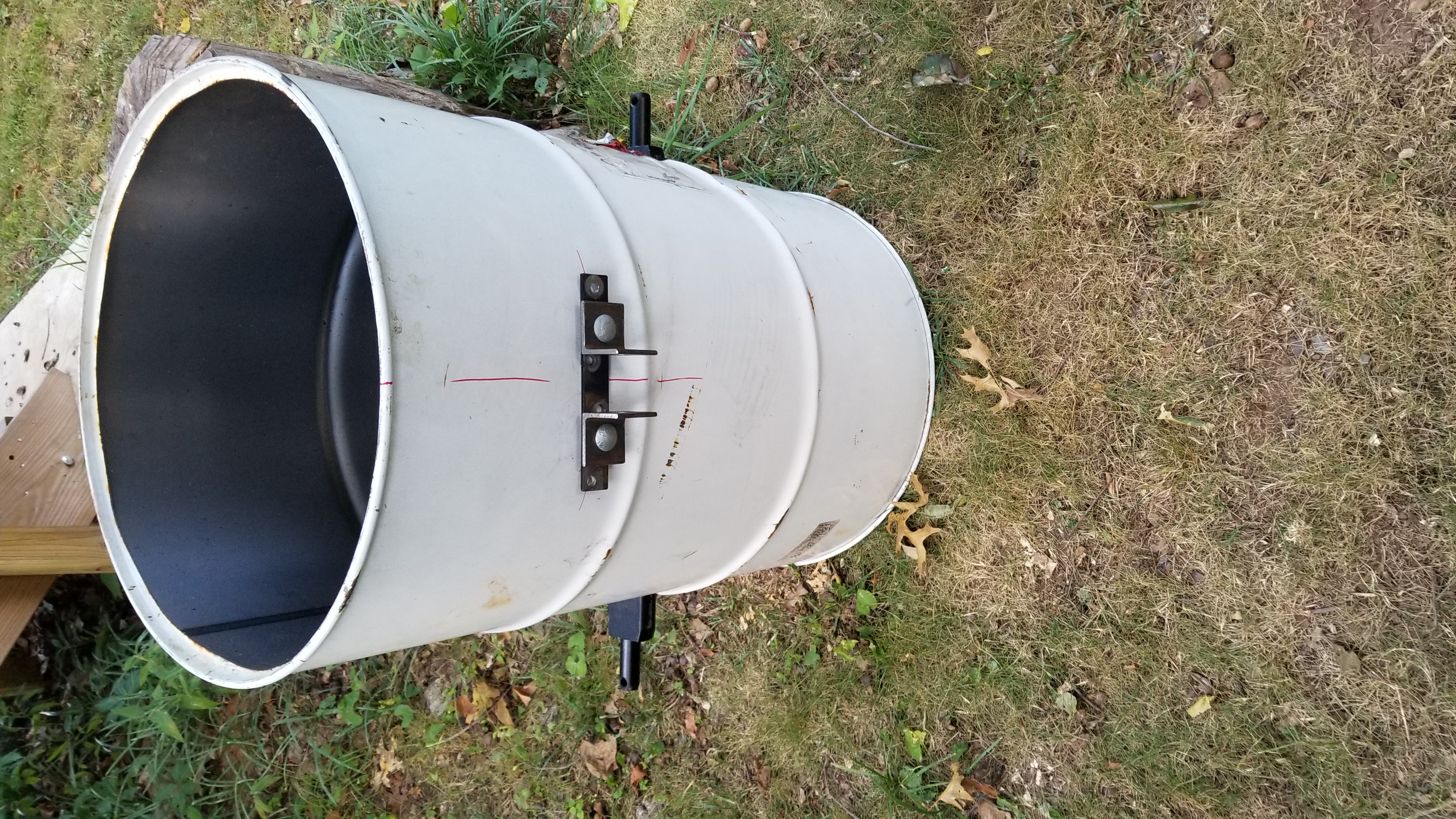

So I have a new mx5200 with filled tires and 100lb wheel weights on each rear wheel. I will be using the weight for a small profile counterbalance for mainly gravel and clay dirt fel counterbalance. My initial idea was to put as much scrap metal in the 55 gallon drum as I could fit, and then pour concrete over it to attain 1500lbs. It would be much less expensive and much less hassle to simply fill it will concrete and just get about 800-1000lbs counterbalance.
Knowing what I have and what I plan on doing, will a simple concrete counterbalance work? Or should I go the extra mile and increase the weight with scrap metal at 20 cents a pound?
Here is the beginning;

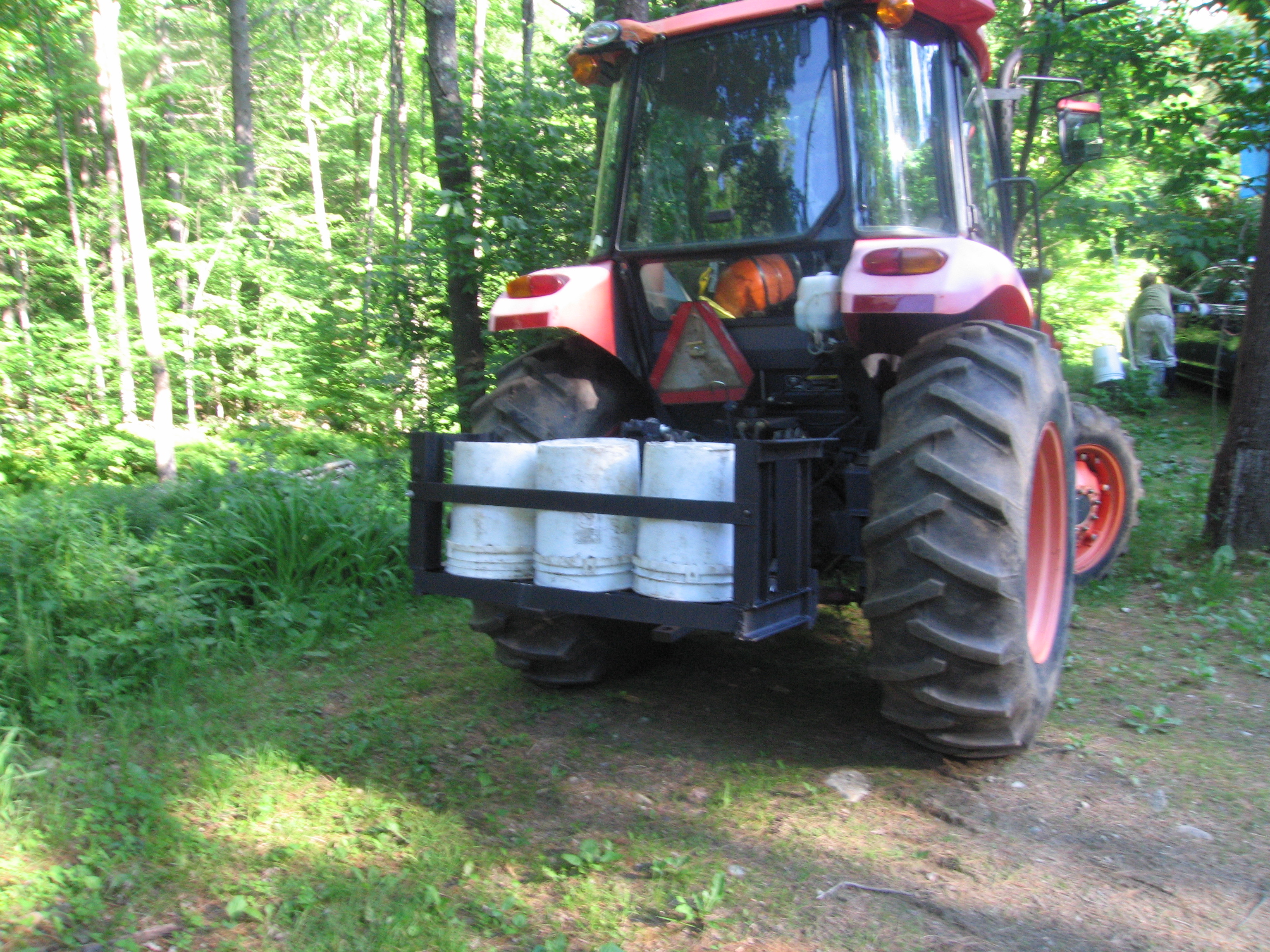

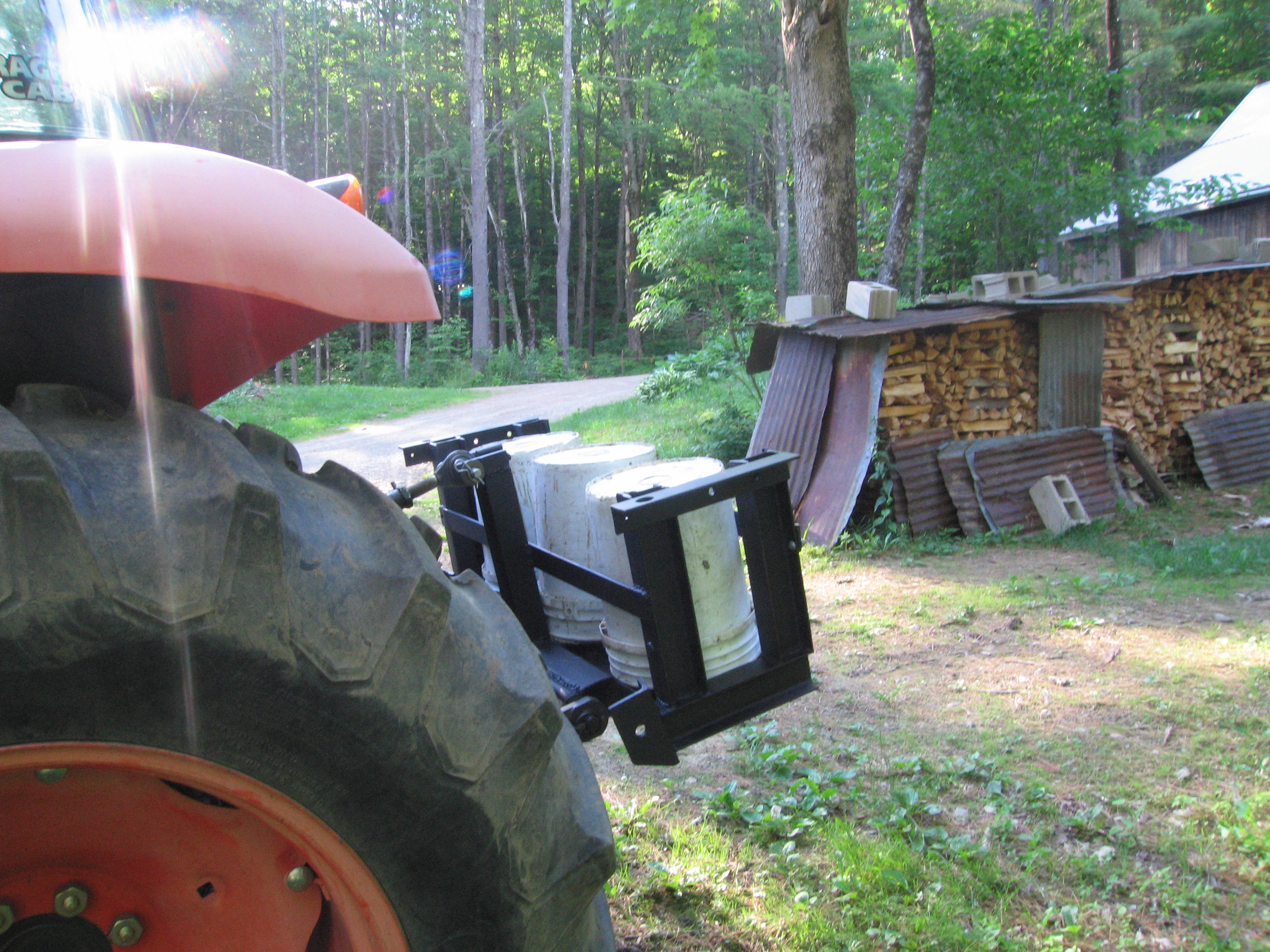

I was using my BB as a counterweight but wanted a more compact setup so I did not have to constantly keep an eye behind so as not to whack things with the BB in tight conditions.
I built this unit from scrap steel and leftover concrete for next to nothing. Weighs around 400 lbs
Along with the loaded tires, I can lift a full bucket of wet sand with no tipping and it is much more maneuverableIMG_1385.jpgIMG_1386.jpg
